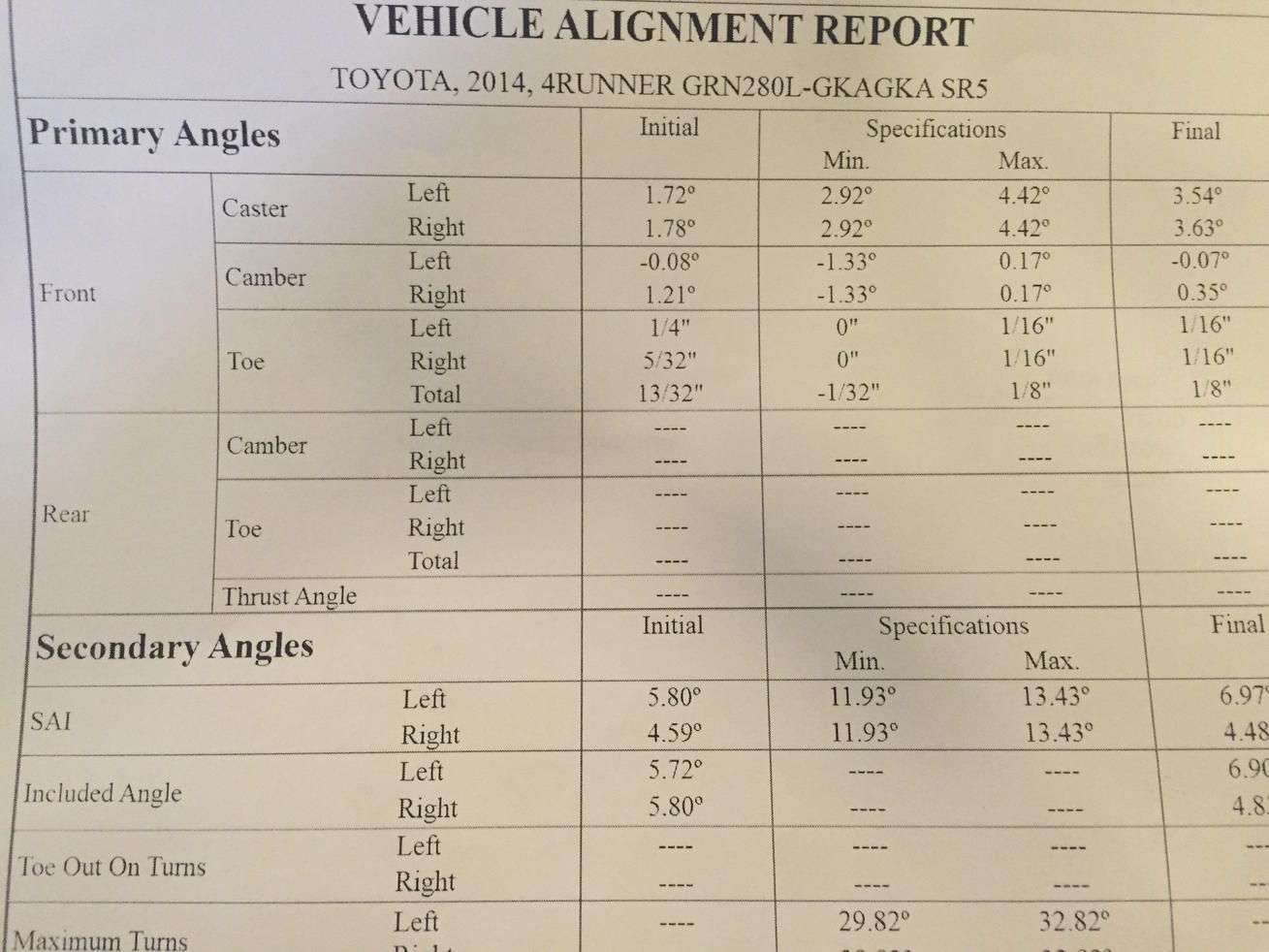

Looking for possible suggestions on my issue regarding alignment. I installed bilstein 5100 set at 1.75 inches two weeks ago. After the installation I was expecting the alignment to be off or the steering to feel funny. I was glad that when I took it for a test drive and driving a couple miles that the feel and handling felt better than factory. Smoother over bumps and a more dampened feel. Yesterday I finally had the time to take it to the alignment shop and after the alignment the steering feels "loose" over little bumps. It almost feels like the front end has a slight thud or rattle. Never experienced bumpsteer but that could be it. The weird part is I know caster has a lot to do with that but my initial caster readings were below 2 and he moved it to around +3.5. I asked the guy to get it to in between 3 and 4 because I figured it would be a stretch getting there considering I have stock UCAs. To my surprise it now feels worse than factory and even worse than right after the 5100 install pre-alignment. The only thing I could think of is maybe my camber and toe where off enough after I installed the 5100s that it created "isometric tension" in the suspension system causing it to feel tighter and more stable at the expense of added wear of course, had I kept it that way. Here are my readings. Your insight and advise would be really appreciated.

Issue was resolved. I went to a reputable shop however, it was a classic case of forgetting/failing to tighten bolts down. He went under to re-torque the bolts so not exactly sure which one was the culprit. No adjustments were made and now it drives normal again.

You are out of spec on camber on the right side!
Wait, Never mind. The spec sheet you posted is just wrong.
Yes it is the best he can do for camber. He said it's not that far off out of spec and shouldn't cause uneven wheel wear.
