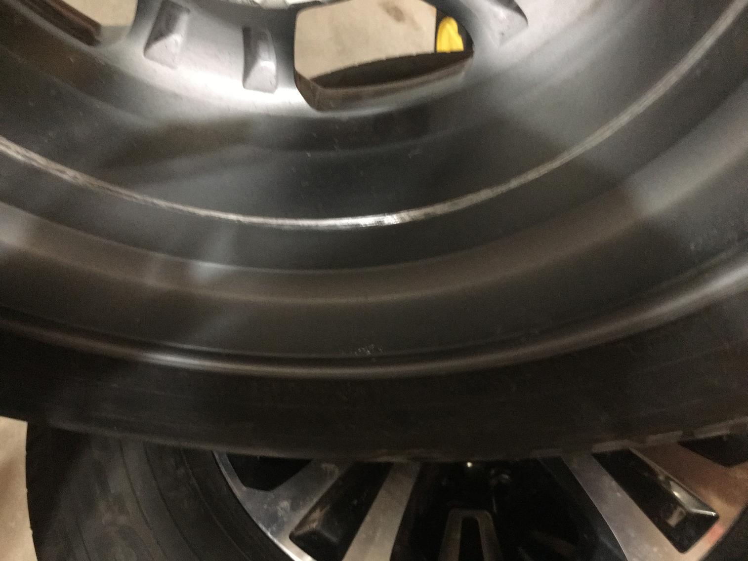

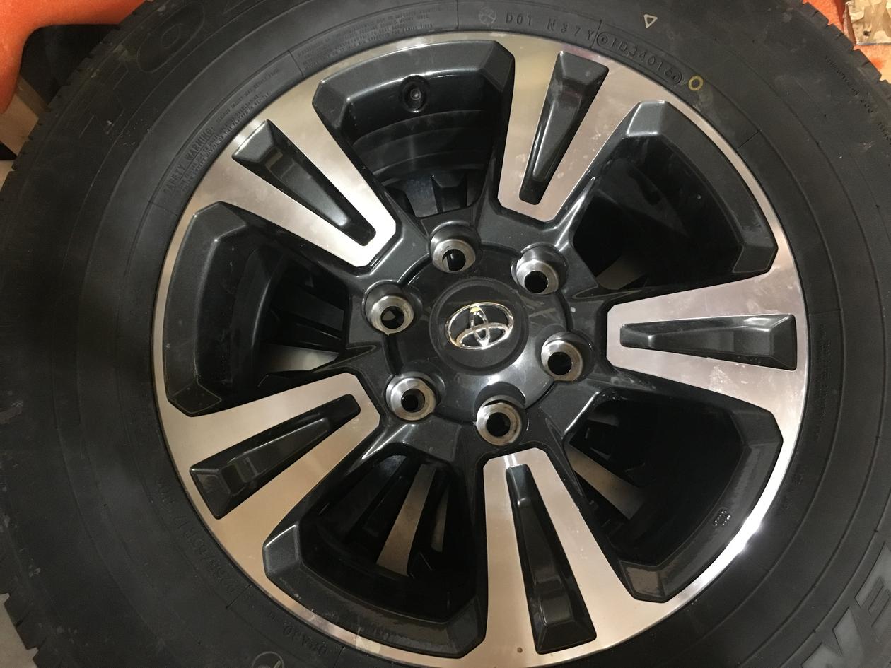

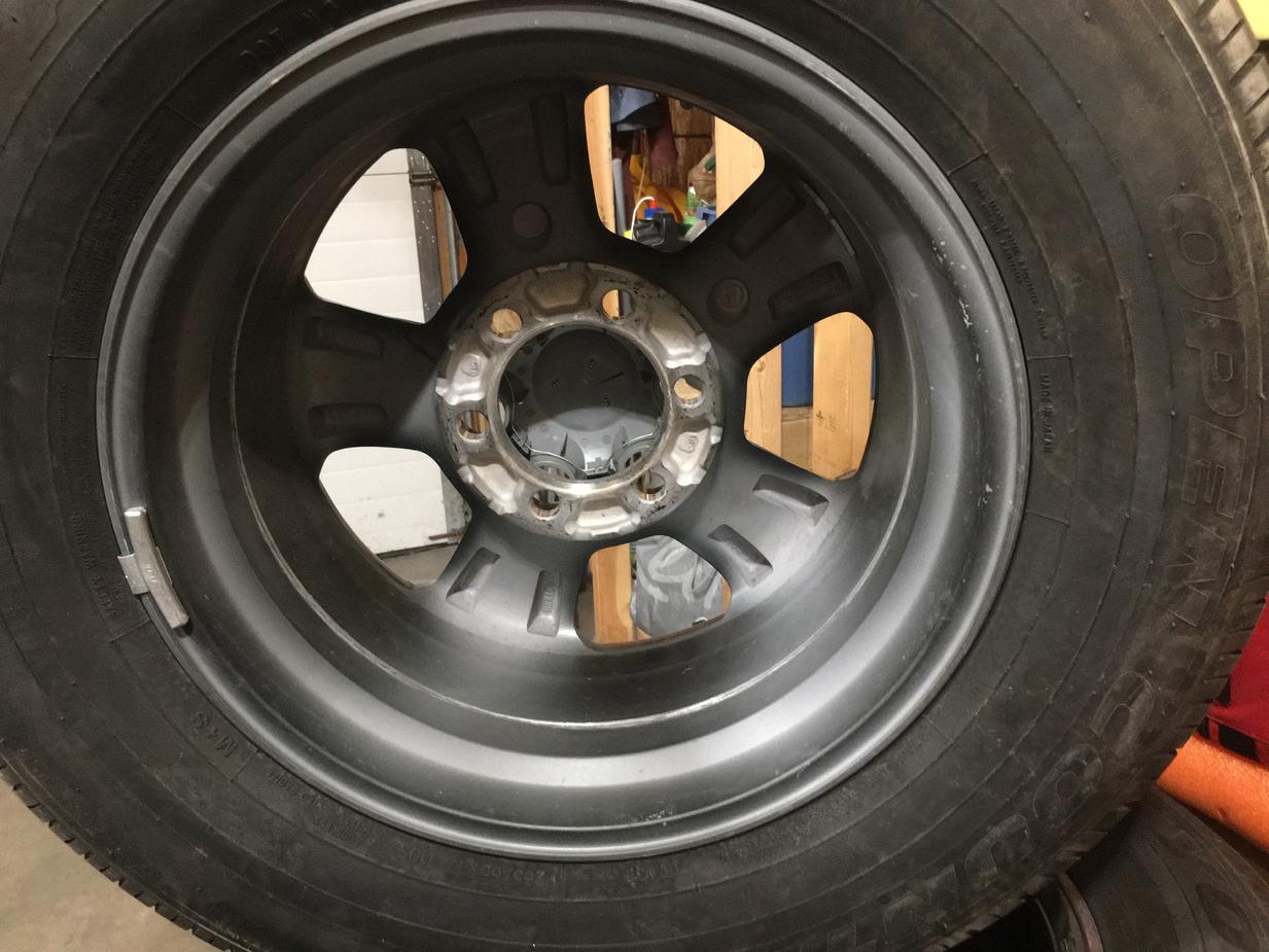

Hey guys wondering if anyone else had the issue that I was faced with today. I bought a set of 17 inch '17 Tacoma rims off of a guy to use a summers for my '07 Sport but the the brake caliper is just rubbing the inside of the front rims only. The caliper on the rear are single piston and have lots of room, while the fronts are double pistons and bigger overall. I didn't notice this until I pulled out of the garage and scored the rim all around. Thoughts? I'm thinking I could file the high spot on the caliper as there's lots of meat there but what kind of clearance should the minimum be between the calipers and rims.
The Toacoma rims have a step up as can be seen in the pictures where the OEM 4Runner rims don't have this step up which is the difference from rim to rim.

You think that the rim is tapered? Cause it's rubbing on the outside of the caliper not the front of the caliper. I'll measure it tomorrow and report back.

I run these 17" tacoma wheels. YES, they do RUB the caliper. Do not grind your caliper.
Easy fix is to put wheel spacers on or sell them. The wheel spacers I ran did not engage the stock wheel studs well so I bought longer wheel studs for my hubs front and back.
