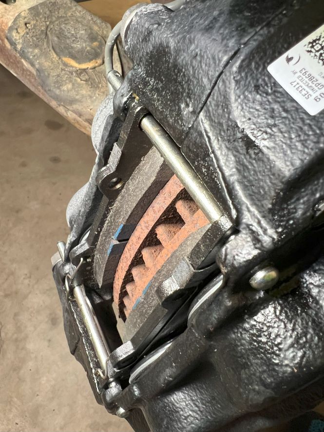

Got this sorted today. Went back to Napa and got both 13WG calipers and replaced them. All good.
Wanted to show my having the wrong caliper is a bad thing. I did not notice the pad overhang when I went and put these together yesterday. In the 1/4 mile I drove, the rotor had already put a slight groove in the pad.

The stamped on designation plus rotor diameter info is the best bet. Sad that the parts store didn't realize this. Another reason to take an old pad with you to verify. Rockauto lists it pretty well under their caliper options for our vehicles.
Yea, I caught it when I went to the Napa website. They have it detailed there pretty well too. Live and learn. Thanks!
