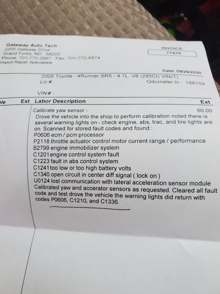

This is the sheet that the mechanic gave me. It had all of the codes on thr bottom of the paragraph after he cleared all of the original codes. After I took it to him, that's when I took it to the local Toyota dealership. They cleared rhe codes then said if they come back on, let us know and we can look deeper into it at $140/hr after just charging me $70 to program my keys. We have limited options for mechanics let alone good troubleshooting mechanics. Live in a town with maybe 10 mechanics shops that deal almost exclusively with ford & chevy's. Farming communities.

With that laundry list of codes, I'd start with the obvious: based on the voltage and sensor codes, what do the battery terminals and cables look like? Are they all crusty and corroded and loose? And what of the state of the battery?

This is my vote as well. I've seen all kinds of oddness caused by a battery in poor condition.

I'll take a look. The posts are really clean but I don't know about the battery itself. It seems to be holding a charge and starts strong. Once they went in and cleared all the codes, the ones that came back were the last 3 on the list.

I actually put a new battery in. Lights came back on.
