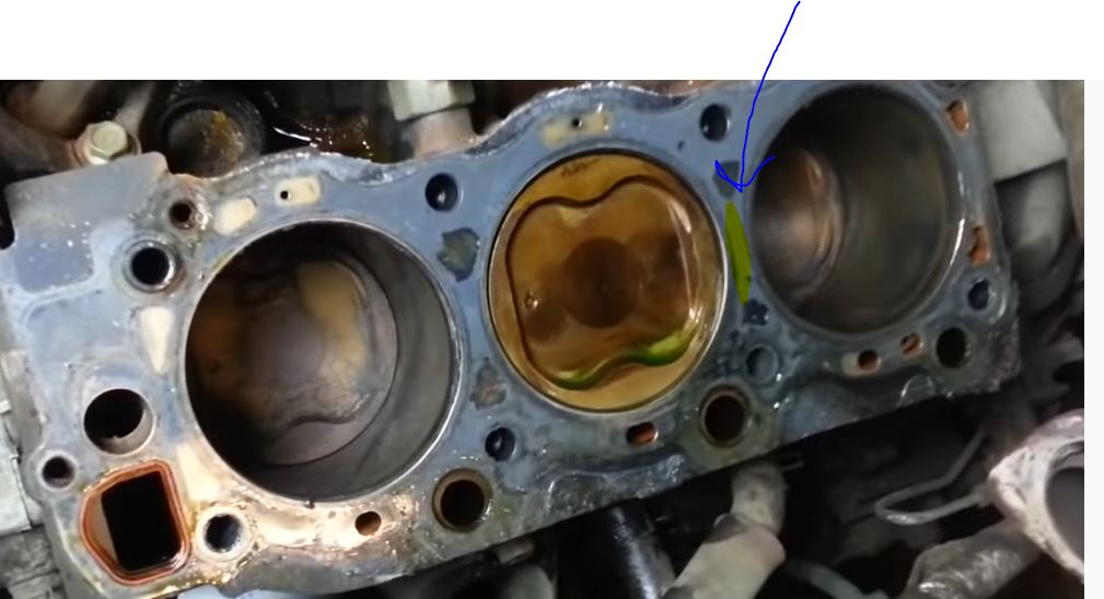

I had an older thread that detailed the long journey it took to get to where I am now...a head gasket leak between cylinders 4 and 6, but not where the holes for the coolant lines lea into the cylinder. There was coolant junk under the manifold gasket, but that's probably been there a while from the previous owner. So after all the spark plugs, valve covers, fuel injectors, etc now it's the head gasket. A shop quoted me 3500 or so to do the head gasket and timing belt/pump. I'm at 172k so might as well to the TB anyways. This seems high, but I don't have anything to compare it to. And that's without finding a cracked head. But those prices are approaching crate motor cost.
the attached photo is where he says the leak is, that's not my head
