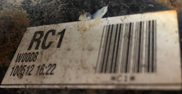

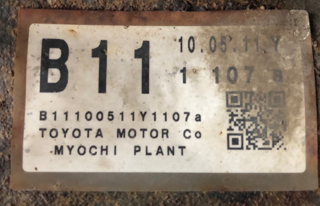

I am wondering should I choose gear oil for limited slip or not? I don’t know if 5th Gen limited has any diff are limited slip :-(
LS. It says that on the back of rear diff housing. Look for small white square sticker.
I look at the rear diff housing tonight and there are 2 white stickers on it. But none of them indicate LSD
Please see attached image here:
2010 without LS seams unlikely. I've no Idea what to tell you. I would use oil with LS additive anyway because it'll cover both bases. If not needed it wont hurt a thing, though. GL
