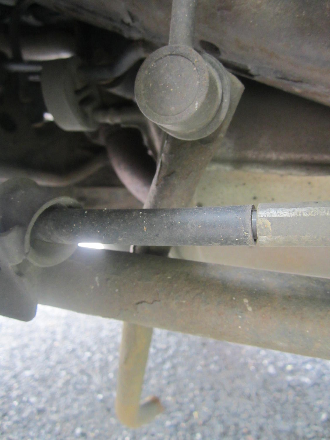

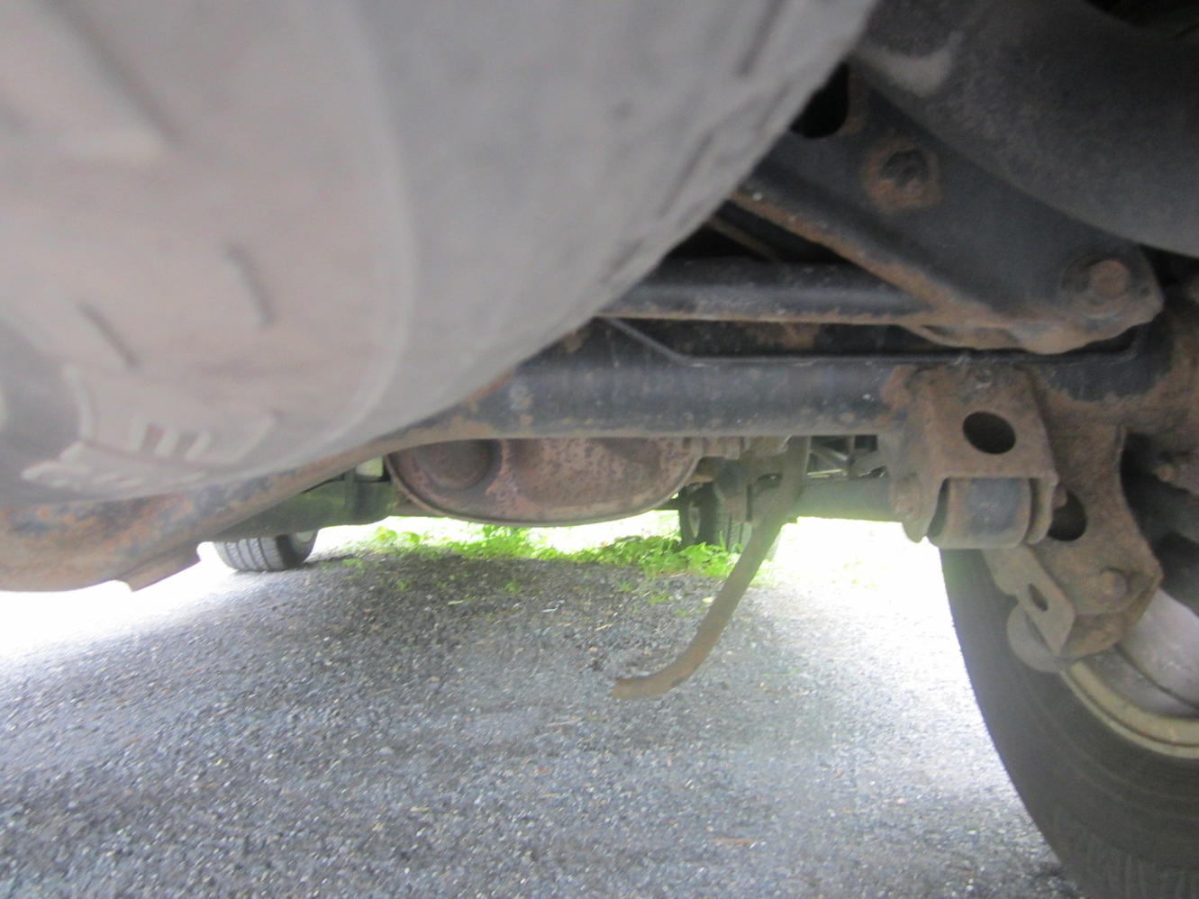

This past weekend, my rear stabilizer bar broke!
The one side is hanging down under the vehicle.
I haven't noticed any difference in ride or handling...
so I am wondering how concerned I should be about fixing it?

It's the actual bar that broke, and it is solid.
I don't have any aftermarket parts,
I don't go off road,
and I do use a trailer now and then.
So what I am being told is that is generally NOT a problem,
unless it's the panhard bar (not sure what that is..)
Here are two pics for reference.

Definitely not the panhard bar. It's the bar that runs along the rear axle...
kinda like this one

It can wait. You still have a front sway bar and you're going to notice more of a difference without the front than with the rear. I'd get it fixed before towing though.
