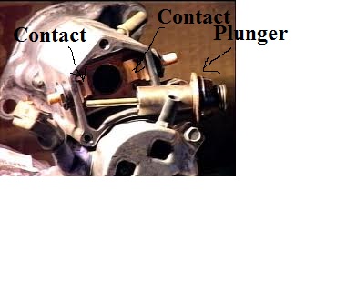

Inside the starter there is an electromagnet. When you give 12V to that black spade terminal, it will magnetize the relay unit (right on top of the starter). It will pull a plunger with the magnetic force and strikes two copper plates making the clicking sound. This plunger and copper contacts pass the current to the starter motor to crank the engine.
See the following images
First image : plunger and the two contacts. Plunger slides into that center hole.
Second image: new plunger and new contacts
Third image: bad contacts.
Since you have a new starter, take it back to autozone to check it out. IF it works, your main battery supply to the starter with the thick wire is not conencted to the battery
