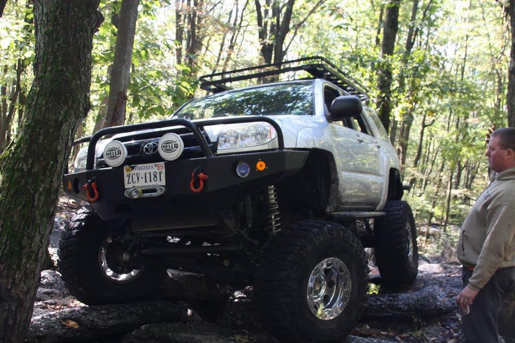

proper tire placement of the non flats
In a trail situation as pictured- gravity becomes your friend. You put the good wheels downhill and into a depression for example-so the flat tire is unloaded-little to no weight on it.
For your picture as shown-I am imaging the drivers front is the flat here so follow along with the example. That driver would simply back down just a bit to allow the right side and the rear of his rig to be steeply downhill unloading the fronts.
Then you use your High Lift jack with slider cushion or cradle to lift the vehicle to unload the weight further off the flat tire. You only need a couple of inches of clearance. Don't lift any higher than absolutely necessary.
Build a support base of rocks and wood chunks (softer than rock or suspension) and insert this base to meet your vehicle suspension/diffs whatever will support the weight safely. Chocks at all the good wheels, again usually rocks. Front and back. You don't want any sliding either direction.
Never trust the Hi Lift alone. Especially as you yank the flat off and reattach the spare ( you of course loosened all the lug nuts when it was down on the ground) Remove the handle from Hi Lift so it does not disfigure someone or worse. They have and still are called 'widow makers' for a reason.

Wow I just sort of realized what that is pictured. A nicely built 4th gen with solid axle front? that is a sweet set up and I like that front bumper I think it is an Armorology.
Since most of your lift is above the axle, and you are jacking from under the axle - a lift should not affect your ability to jack it up to change the tires unless you have humongo tires.
This is true for the rear, but the front increases significantly in height with any suspension/tire lift. The rear only increases from tires. You can still use a bottle jack on the lower control arms in the front if you do not feel comfortable with a hi-lift. It would be my first choice anyways, then use the hi-lift only if the safer approach did not work.
It's a Shrockworks. I don't think armorology has made anything for a 4th gen, and I believe all of their work is custom. Some of their 4Runner bumpers (2nd and 3rd gen) have come out a little funny looking.
