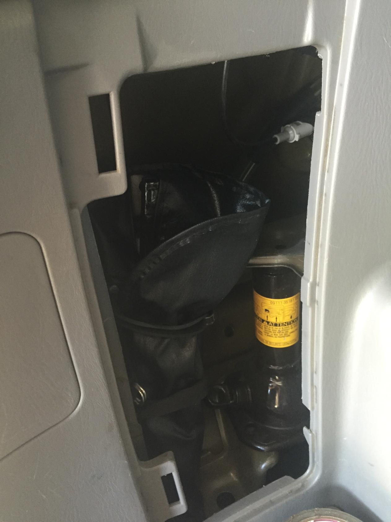

I'm sure this has been covered before, my apologies, but this 03 is new to me and is missing a thing or two. It has all the stuff usually missing, like the books and OEM mats, but is missing the spare tire (completely) and the jack tools. The jack is in place.
Here's my question: I'm headed to a salvage yard today that has a 4R just in, complete, but wrecked. Should I get a full aluminum wheel/tire for the spare? I'm thinking it might oxidize under the rear and that a steel one came from the factory but just curious what others have done. A full size spare does fit, correct, not a donut???
Also, like I said, I have the jack but not the tools. Can someone let me know exactly which tools to get? I see the spot in the left rear cubby where the jack is and where the other stuff was mounted but I need to know exactly what's missing.

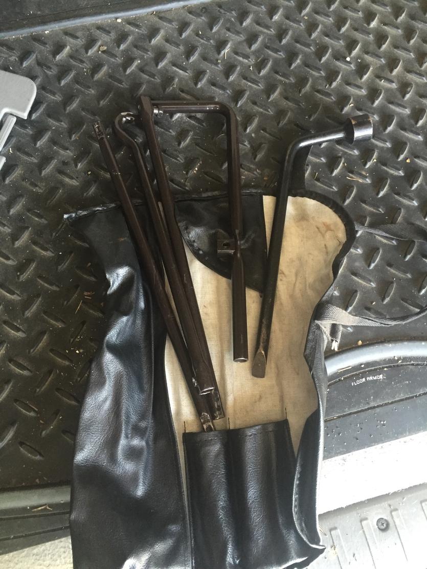

The 4runners came with a full size, same rim spare tire. No steel rims here! The tool kit has a tire iron.... to remove the lug nuts, and 4 long pieces you put together to lower the spare and work the jack. Here are some photos so you know what to grab.

I have a folding 4way too. Fits in with everything else and better than the stock lug wrench.
Many thanks to both of you. That's exactly what I was looking for. My bungee and jack are there but the whole pouch with tools is missing. I'll grab it.
As mentioned, the jack handle and jack handle extensions are required to lower and raise the spare tire. You can check on how that operates in the In Case Of Emergency section of your Owner's Manual - here is a link:

Thanks Bossman! I was going to refer to that to see the tools as well but haven't yet. A picture (like a real picture, here) is worth a thousand words.
