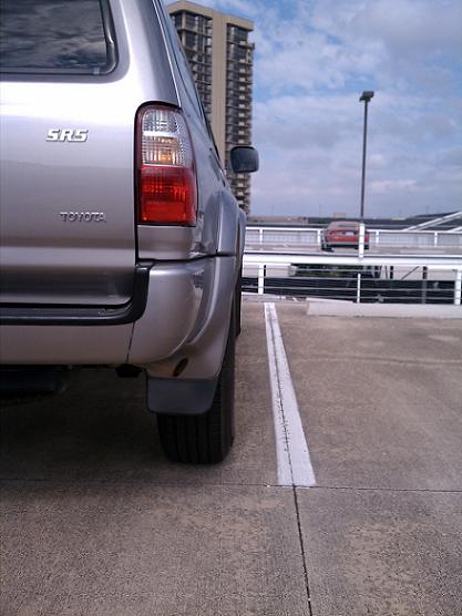

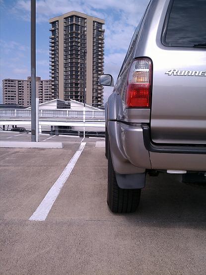

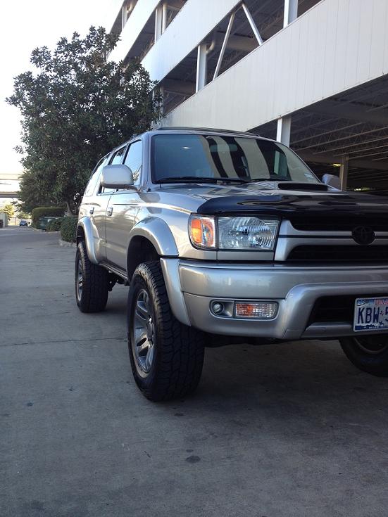

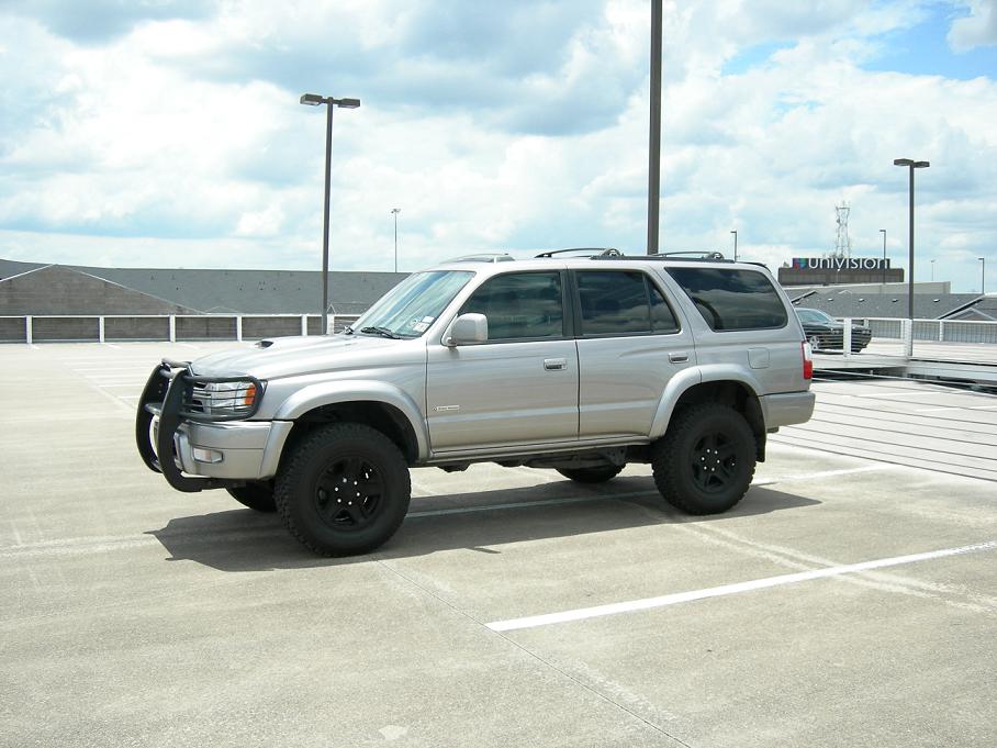

The only time I take the truck off road is to go on parking lot, so I didn’t need 4wd. But I like the look of a lifted Runner, so I started researching lift options. That’s when I found T4R.org. I still use it as a DD, so I didn’t want to go too high. Decided on the Sonoran Steel 3.0 kit and had it installed at a local stealership. At the same time, I found some 5 star rims, painted them with Duplicolor flat black, and wrapped them with some BFG AT in 265/75/16. Here’s a shot with the boards taken November 2009.
And without.

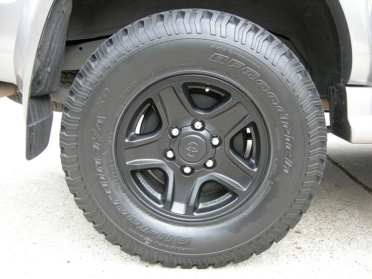

And just the wheel and tire
I didn’t put any clear coat because I wanted to make sure I like it first. After a few months, the black started to fade, so I put another coat of flat black and a few coats of clear, only this time, I used Rustoleum. They turned out pretty bad and only got worse when the paint started to chip and bubble and flake off. I’ll never use Rustoleum again. So, shortly after I got my painted 5 stars, I began planning to repaint or replace them.

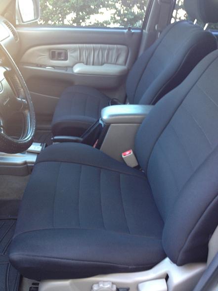

My brother and I have summer birthdays, and in 2010, we got each other some Wet Okole front seat covers. I like how the all black looks, but man, they can get hot in the summers.

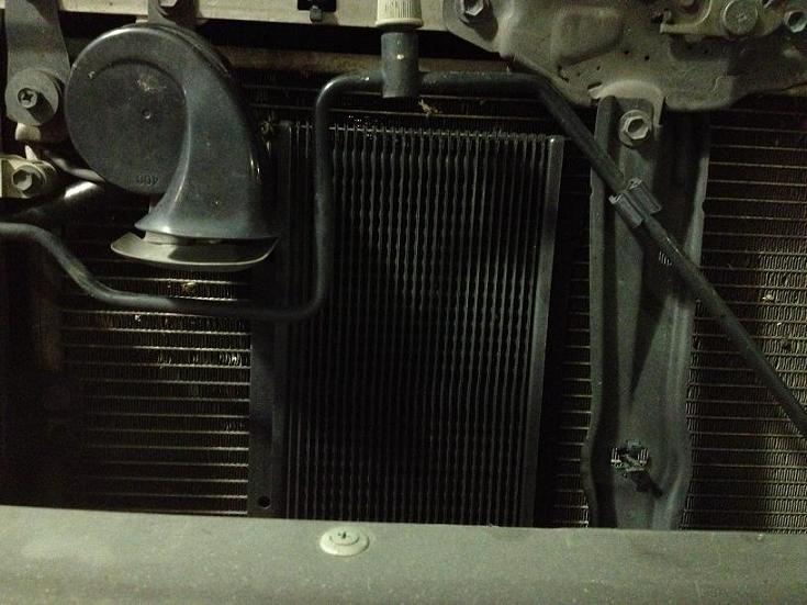

For Christmas of 2011, I got a B&M 70268 external cooler, which means I also got to crawl under the truck and get my hands dirty.

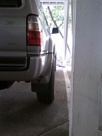

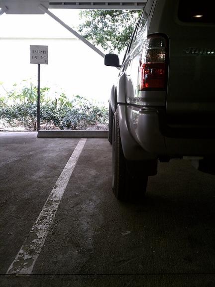

In the spring of 2012, I ordered 4 Spidertraxx 1.25” spacers. Here’s before shots.
And after

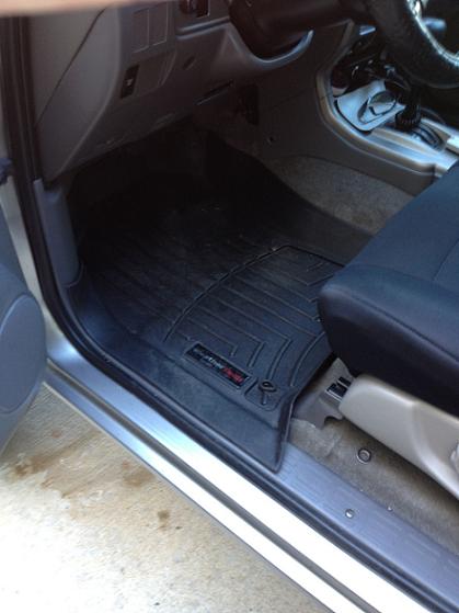

At the same time, I ordered Weathertech digital fit front and rear floormats. Not the greatest picture, but it's all I have right now.

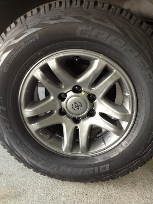

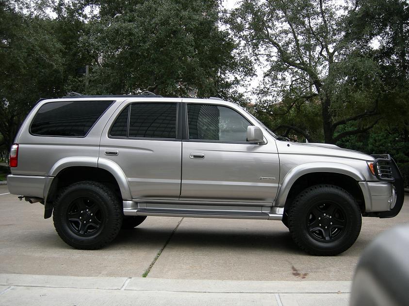

Finally, summer of 2012 I bought a set of Tundra split spokes. The plan was to take my time painting them and just use the 5 stars until I needed to replace the tires. But the more I looked at them, the more I hated the paint. So I had the Tundras powdercoated gunmetal and wrapped them in some 265/70 Cooper Discoverer AT3s. The powdercoat didn’t go on exactly evenly, but I kinda like the uniqueness.

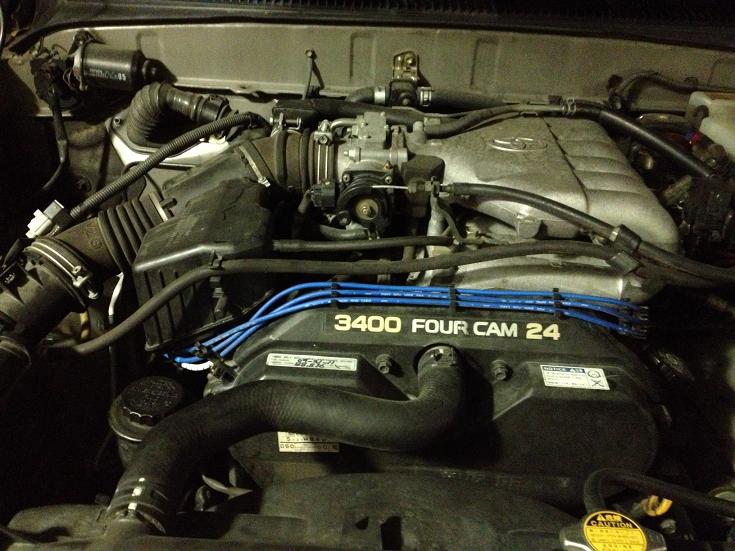

Also did the blue plug wire mod and replaced spark plugs and coil packs (Denso and NGK only).

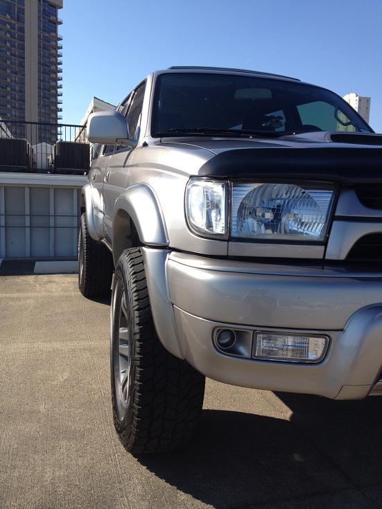

This weekend I replaced the stock corners with clear corners. Here are before and after shots.

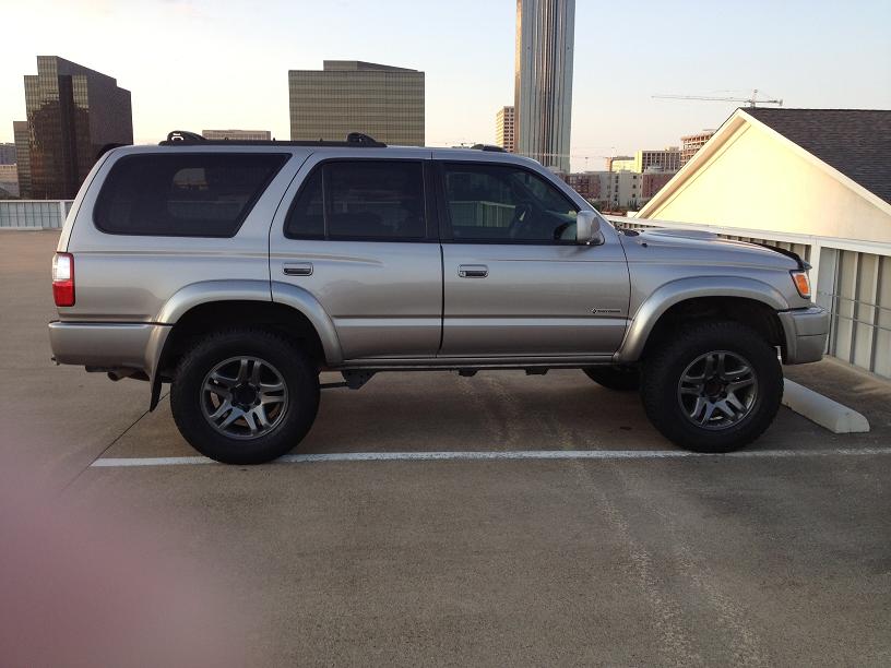

And this is how the truck sits today.

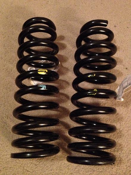

Here's a teaser pic of what's to come soon.
yellow, yellow and yellow, blue.

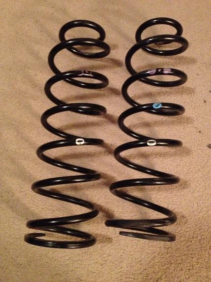

These are 7.5 and 8 wraps from a '93 FJ80. The colors on the 7.5 are double purple, light blue, white. The colors on the 8 are double purple, dark blue, white. I have a question for anyone with this lift. Do I need to get longer sway bar end links to run these springs if I never go offroad? Or will I be fine with the stock links?

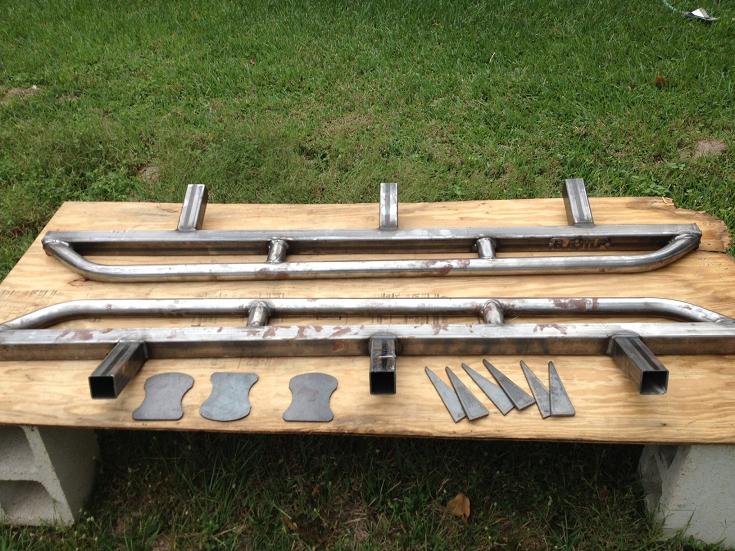

And lastly, I got in on the BAMF group buy a few months ago. As soon as they're painted, they'll be welded on.

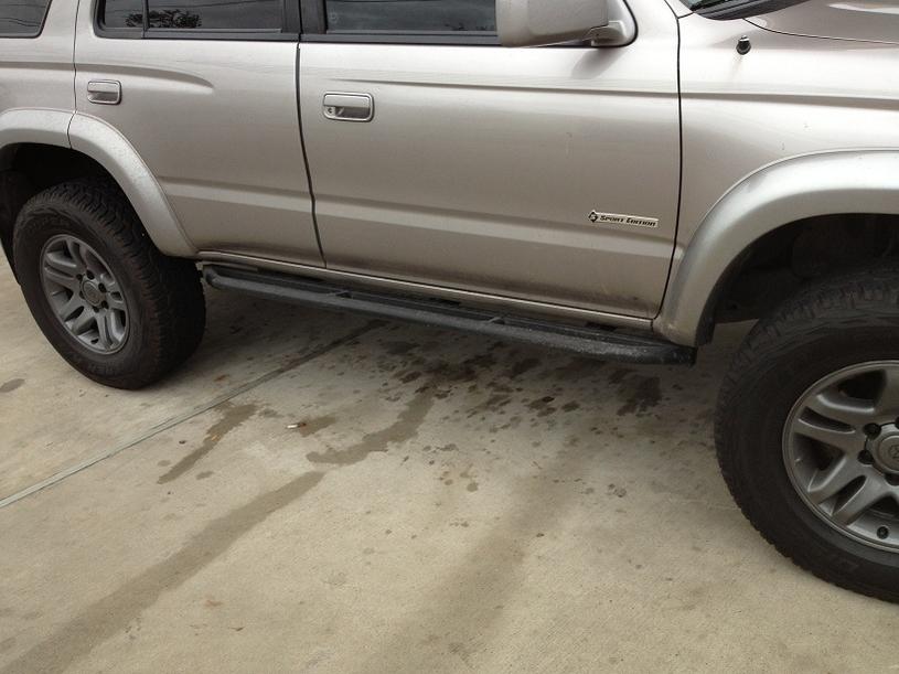

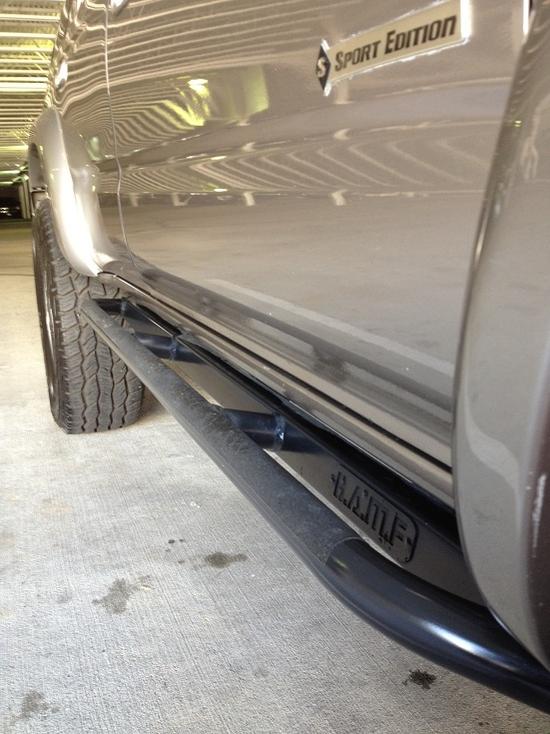

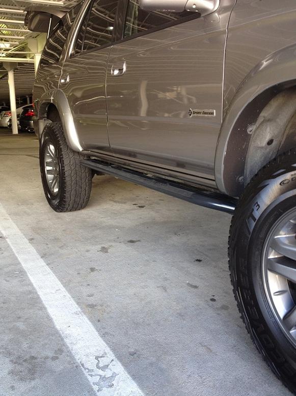

I have an overdue update. I finished painting the sliders over Thanksgiving weekend and got them welded on around Christmas. Then added some grip tape on the top. Pictures are below. But before I get to that I still have a question about my lift.
I have the LC 7.5/8 wrap springs and I'm going to pair them with the Tundra TRD springs and Tacoma 5100s (3 perches) in the front. I want to have as little rake as possible, and since I've got 2wd, I figured I could put the shocks on the lowest perch and add this daystar spacer on top to try and raise the front a little more without sacrificing comfort by raising to the middle perch.
http://www.wheelersoffroad.com/kt09105.jpg
Does anyone know if that would cause any problems? Like, will it put too much strain on my LBJs? Would it cause the lower control arm to droop too much? Would there be any interference with the steering knuckle?

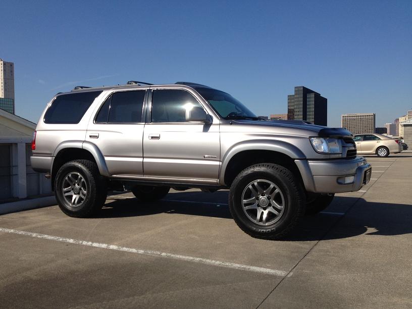

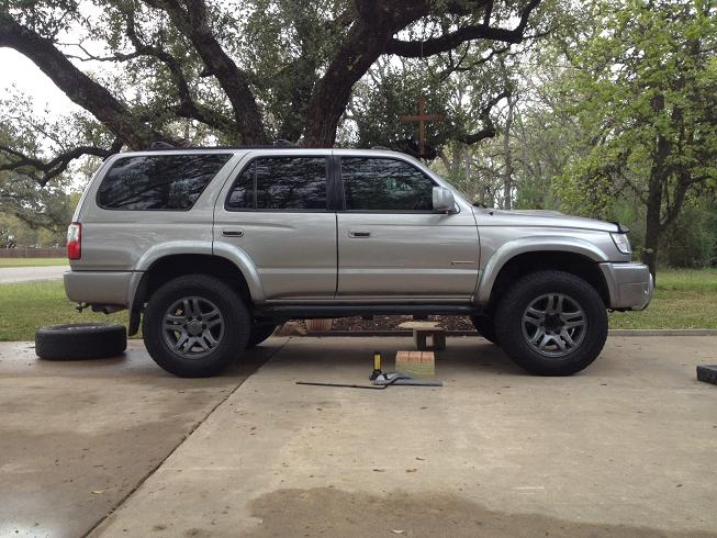

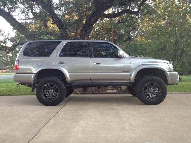

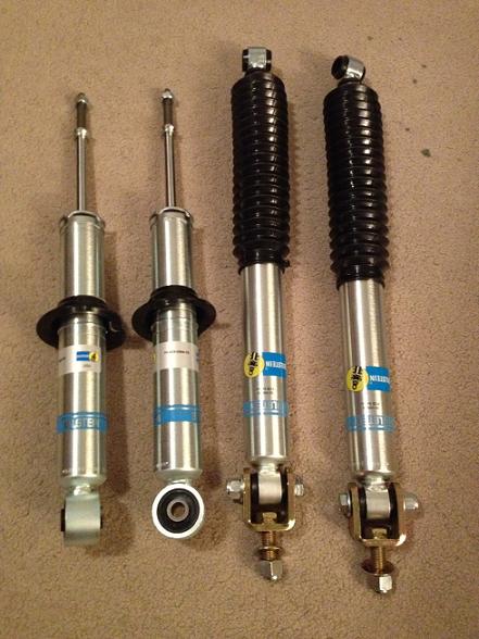

Ok, so I bought the Bilstein shocks and LC/TRD springs in September of 2012, then installed them in March of 2013, then updated the build thread in November 2013. Kinda slow going around here. Anyway, on to the details.
Front lift
Bilstein 5100s Tacoma shocks with Tundra TRD springs on middle clip. I asked in a previous post about putting the springs on the bottom clip and adding a spacer on top of the coilover. That wouldn't work. So I moved the perch to the middle setting. I also replaced the front sway bar end links with some Moog 2nd gen rear end links.
Rear lift
Bilstein 5125 shocks with eye to stud adapter from Toytec. FZJ80 7.5/8.0 wrap springs. Removed the cone from the top of the springs and made no modifications to the bump stops. I moved the sway bar end links from the front of the truck to the rear. Also replaced the trac bar with a Sonoran Steel adjustable bar - lenghened it for about 3.5 inches of rear lift.
While I was under there, I replaced the sway bar and steering rack bushings with poly bushings from Wheeler's Offroad. I didn't notice a drastic improvement in handling, but I only had about 105K miles, and my stock bushings were still in pretty good shape.
First picture is the day I installed the lift in my dad's driveway - 3/29/13
Next is the LC/TRD lift but it took a while to get back to my dad's house in the daylight. This one was taken 9/26/13.
And I photoshoped a picture of both side by side.

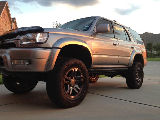

Lastly, I washed it last weekend and took a picture in the driveway right at sunset.

It looks so much better with the lift on! Where did you get the sliders put on at?
Thanks. The sliders were welded on at a place called M&M Welding & Fabrication. I wouldn't recommend them though. I didn't know at the time, but you're supposed to disconnect the battery when you weld to the frame. They apparently didn't know either, or they didn't care, because we didn't disconnect anything. Luckily nothing got fried.

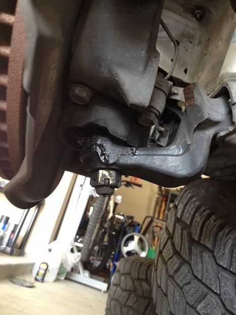

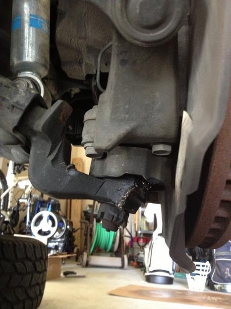

However, when I took the wheels off to remove the struts with the Tundra springs, I snapped some pictures of where the LCA meets the LBJs. These angles are at full droop, but I don't think it looks a whole lot better with everything put back together. Plus, there's grease leaking out. Is this too much of an angle? Should I order new LBJs ASAP? If so, is it because of the angle or the grease? Because I don't think the angle will improve with new parts. I have another car I can drive if I need to.
The LBJs were replaced under the factory warranty at approx 45K miles. I currently have 120K. But since they were replaced, I drove about 25K miles on the stock '02 2wd suspension. Then approx 35K with the '99 tall springs. So I've only been lifted above stock height for about 15K miles. I don't mind replacing them if I have to, but I'd hate to think these are bad after only 75K miles.
