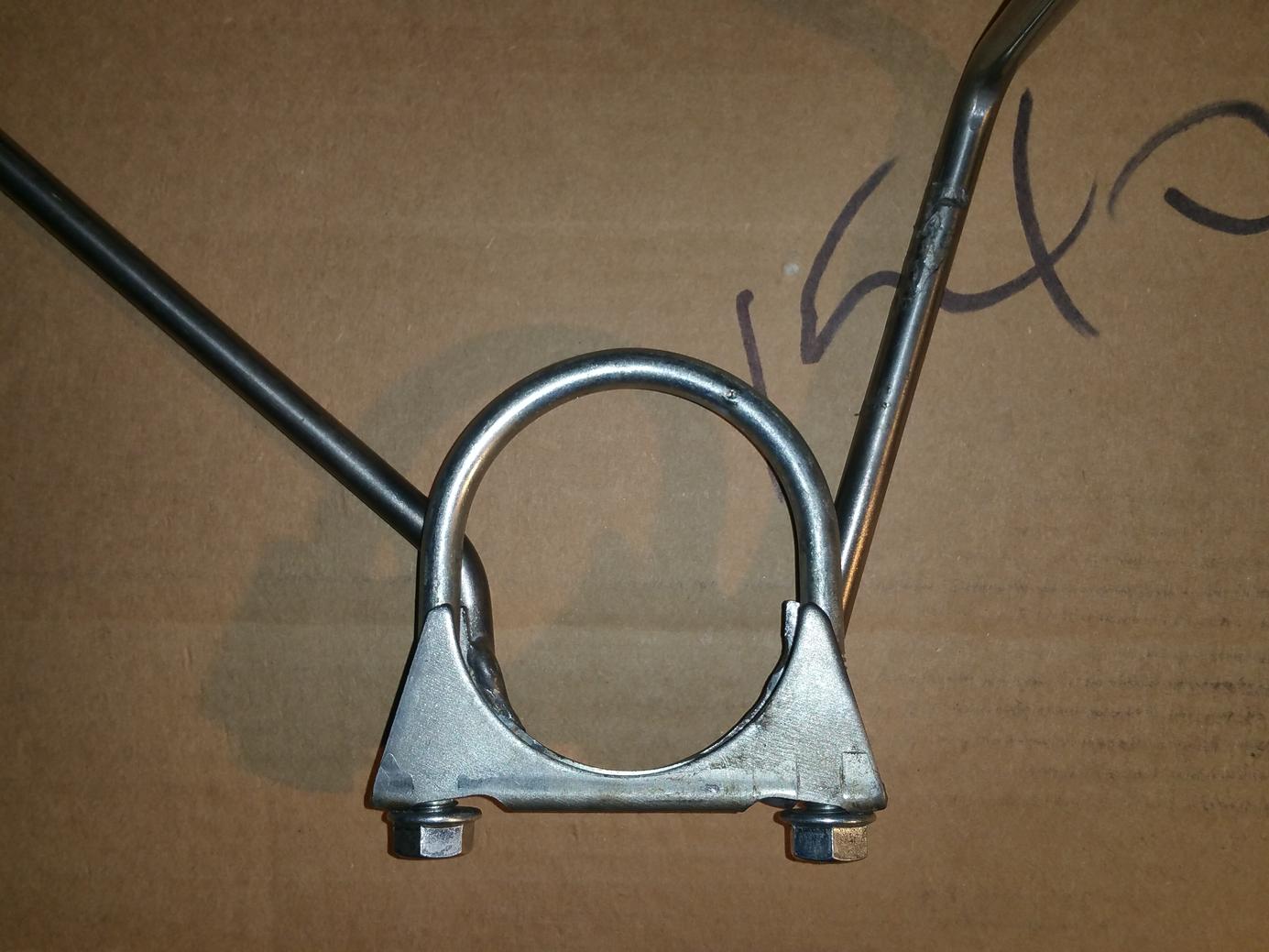

* The hanger bars on the muffler come in the form of being welded to a u-clamp, and was welded so sloppy that the bar protrudes 3/8" into the pipe. I had to grind it down to preserve the pipe's round shape and proper seal, which ground that bar down to less than half it's original strength.

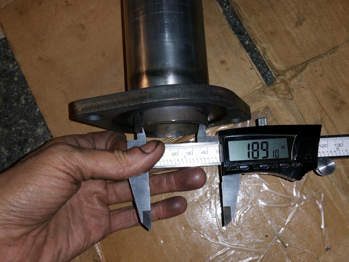

* In the flange that meets the cat, the pipe is only 1.89" ID !! The ID of the flange on the magnaflow cat is 2.58"
