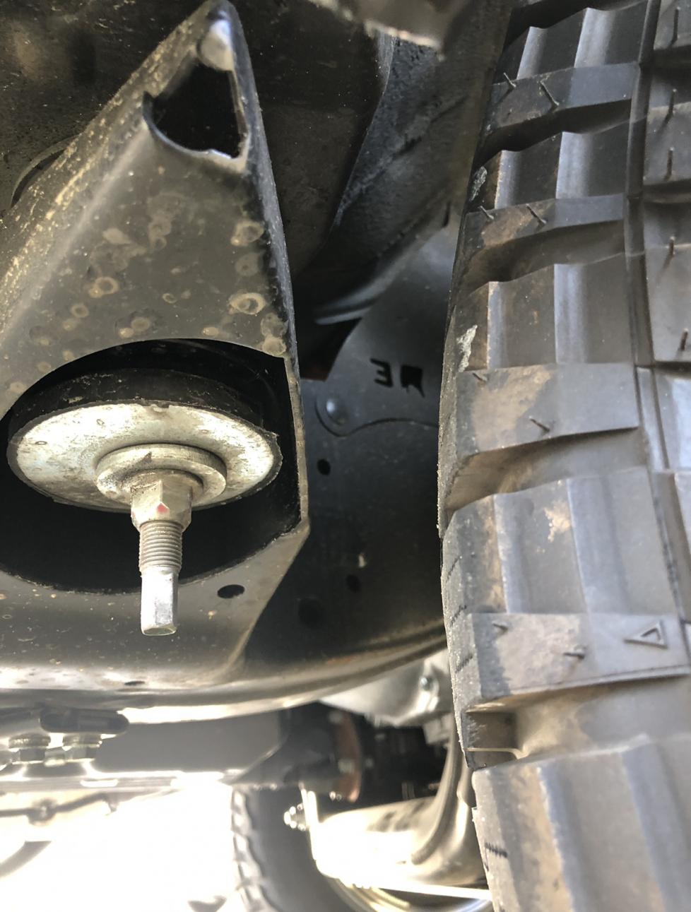

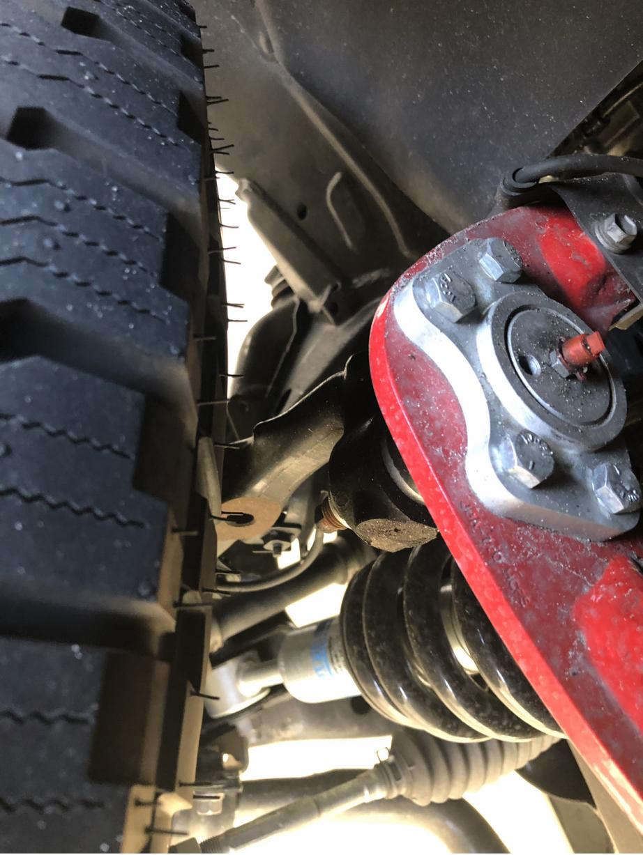

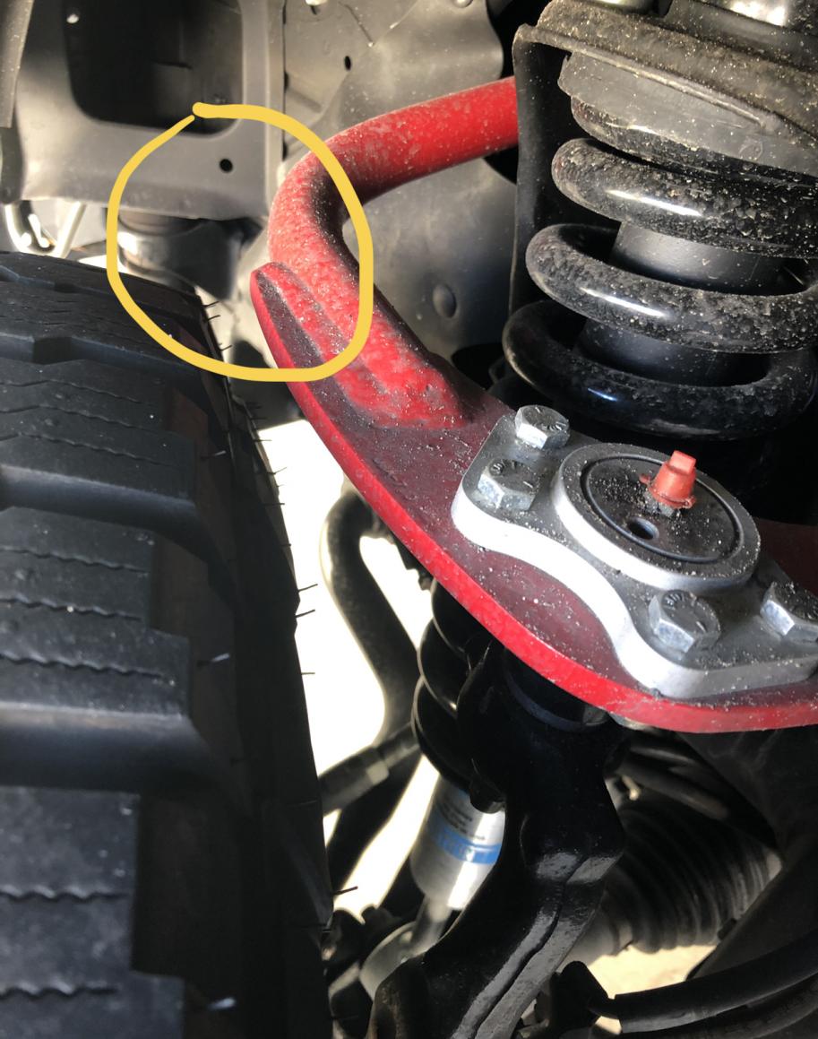

5100s/Wheelers T1-T13/JBAs/SCS Ray 10s 17x8.5/Falken Wildpeaks 285/70/17
Had to BMC as I was rubbing on full turn reverse. The point I circled in the picture is where you will get rubbing. I could probably run 295s with this set up, but nothing larger because I will probably rub on the JBA UCAs.
