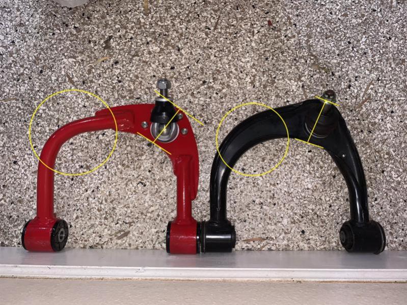

I just had someone else in another thread talking about these. I think the clearance problem is that the JBA ball joint area is very close to the same size as stock (shown with the yellow lines), from these side by side photos from an earlier post. There doesn't appear to much additional clearance there from the back of the ball joint where it can contact the spring (1/4" maybe?), which is the same thing that happens with stock arms.
You can see where they gained clearance on the left curve of the arm, shown in the yellow circle.
That's a good pic. The problem I see is that the bend where they gain some clearance isn't where the clearance is needed. It might useful for clearing remote reservoir hose, but that generally isn't a problem that I've come across.

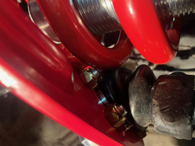

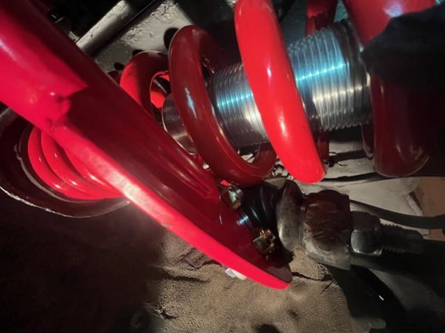

Reviving this old thread. Wish I had seen this earlier!
I bought JBAs to replace my Freedom Off-Road UCAs which ball joints rusted so badly I couldn't replace them.
The UCAs make contact on my Freedom Off-Road coilovers at full droop.
If I rotate the spring would it even help? I tried rotating the coils but it's seated in the strut hat so don't think I can. I guess I could remove the shock and rotate it with it out, but that's a ton of work.
Does it matter if it makes contact?

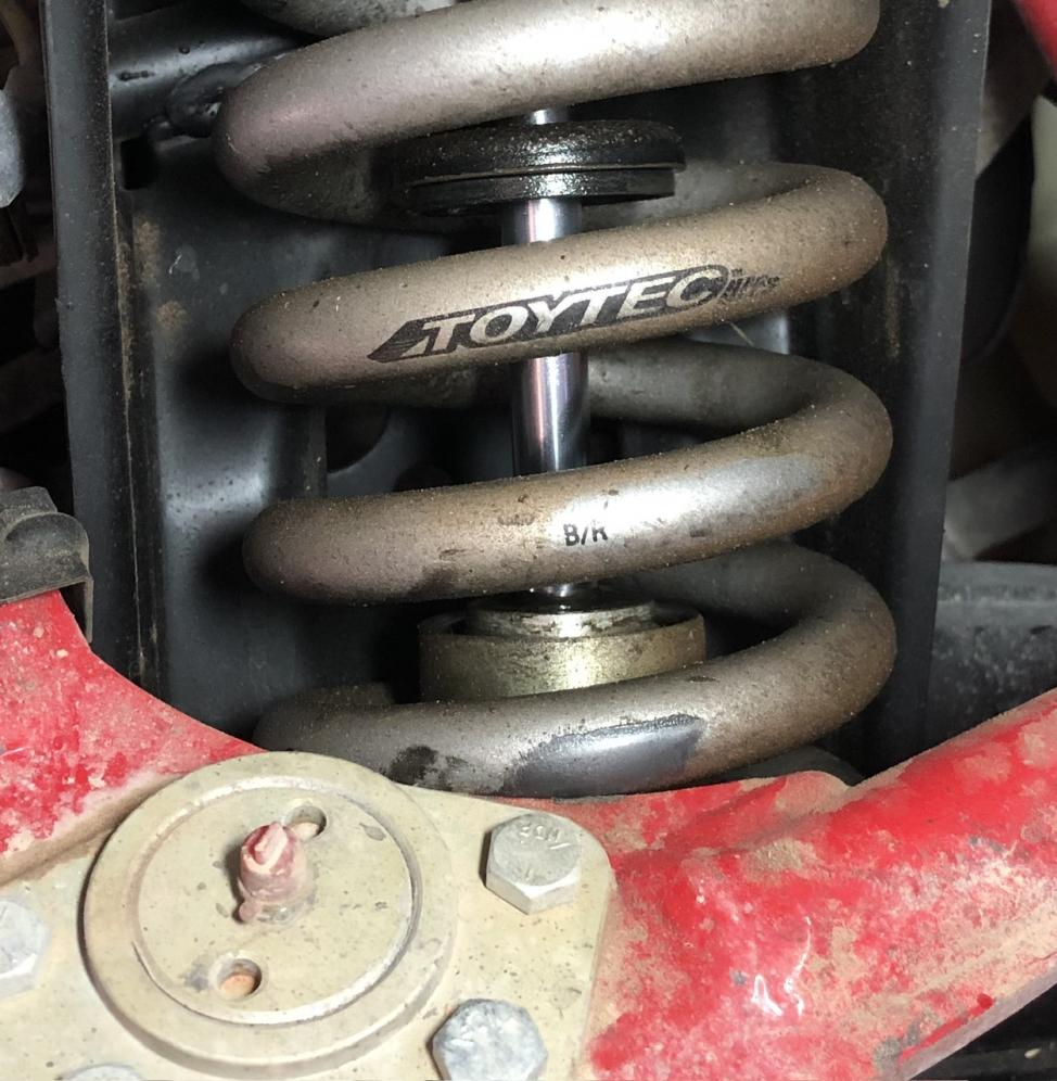

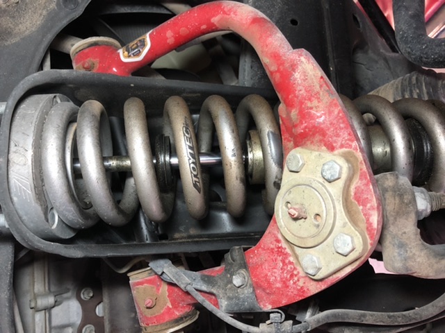

My JBA upper control arms hit my springs when I had my old Toytec coilover setup. Bilstein 5100’s Toytec spacers and 700# springs. I did end up rotating the springs to lessen how much contact there was but never really had an issue otherwise. I currently run Bilstein 6112’s with their 650# springs and don’t have any contact with the spring.
Picture attached is the passenger side. The shock was blown here. I adjusted the spring after replacing the blown up shock. This was 2021.
