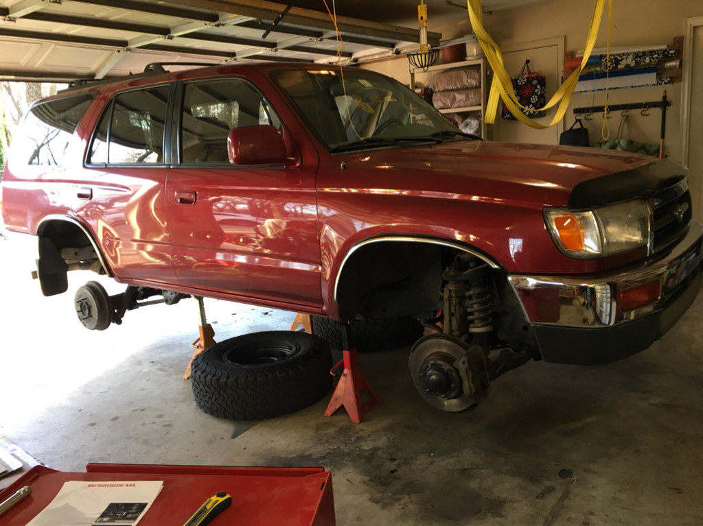

Last night’s work on the lift went well. Got the fronts done in 2 hours. Today was a different story. What a horrible design for the rear shock upper mounting points!!! I got the right side done, but ended up taking the truck to get aligned and had them replace the drivers side.
It's not a huge lift, but I'm pretty happy with it for my daily driver. I noticed a big improvement in the steering since it's not riding on those sad, worn out rear springs. I also installed the front mudflaps.

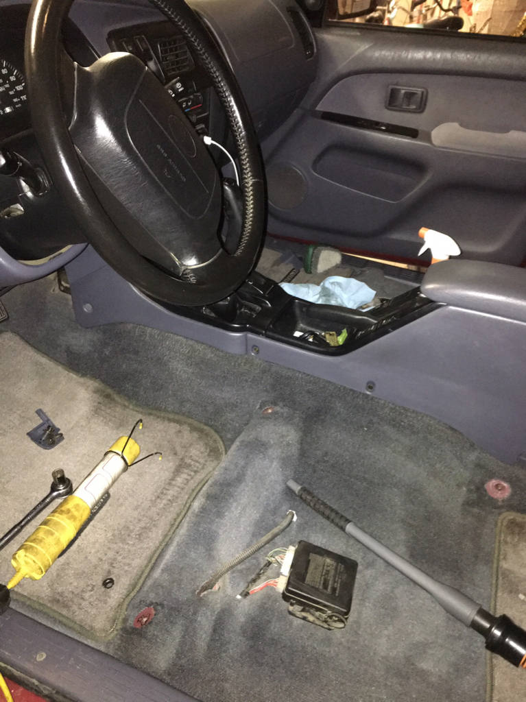

Got the 99+ center console swapped over. A nice, simple mod with huge benefits, IMO.
Some pics showing the differences in the parts...
Got the switches moved over to the dash. Just need to swap a couple wires and remove the "UP" and "DOWN" lettering with a magic eraser.
Looks like it belongs...
Another nice benefit...the upper tray under the armrest.
