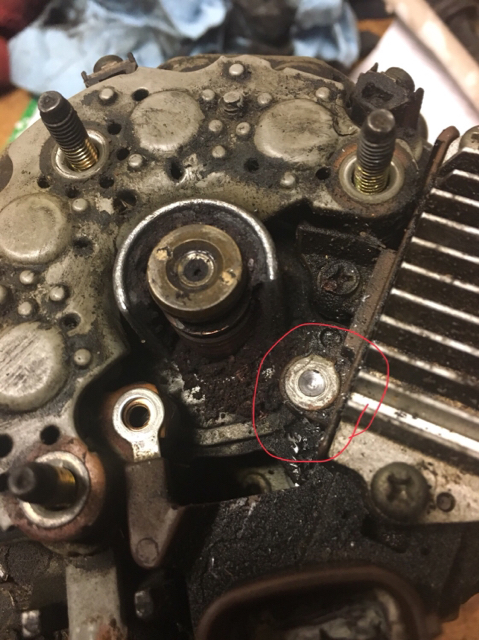

After I got home, I did a little research on t4r.org and watched the video by [MENTION=120071]mtbtim[/MENTION] and [MENTION=102606]infamousRNR[/MENTION] and found that a lot of people replace the brushes rather than going with a whole new alternator. So, I pulled the alternator last night to see 1) what type of alternator I have and 2) to inspect the brushes. I found that I have a Denso and it might be the original. I also found the brushes to be severely worn down.

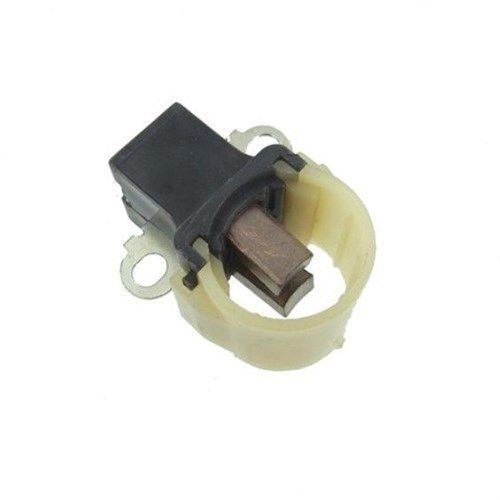

It looks like the style of my brush holder is different than most others I've seen. Here's the one I see referenced in most of the DIYs. It's part number 27370-75060.
When I do a parts search on camelback's site, it says I need part number 27371-70300 and it looks like it's just the brushes, not the brushes and the brush holder. I assume there's some soldering involved to install the brushes in the brush holder?
Does anyone know which would be the correct one for me to order?

Well, being the impatient person I am and not wanting to deal with the fubar’d screw that holds down the brush holder, I decided to just buy a re-built alternator with a lifetime warranty. No one had the brushes in stock locally.
...aannnnndd it looks like my luck has run out...
25 ft-lbs is way too much apparently. Hopefully, the junk yard will have one. If not, I'll be down for a few days. :dammit:
