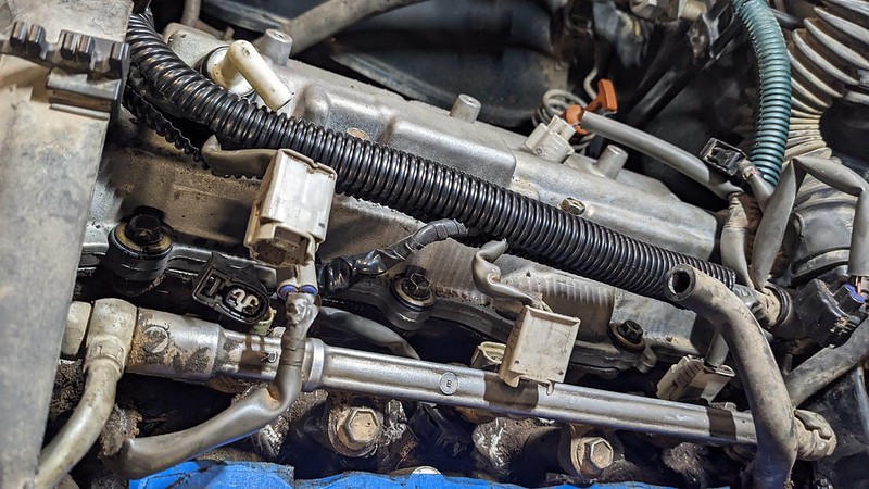

Loom and wires repaired.
<a data-flickr-embed="true" href="https://www.flickr.com/photos/155272546@N08/52446312028/in/dateposted-public/" title="2022-10-22_09-17-11"><img src="https://live.staticflickr.com/65535/52446312028_9395e97974_c.jpg" width="450" height="800" alt="2022-10-22_09-17-11"></a><script async src="//embedr.flickr.com/assets/client-code.js" charset="utf-8"></script>
<a data-flickr-embed="true" href="https://www.flickr.com/photos/155272546@N08/52446454289/in/dateposted-public/" title="PXL_20221022_150102525"><img src="https://live.staticflickr.com/65535/52446454289_1a21c7d331_c.jpg" width="450" height="800" alt="PXL_20221022_150102525"></a><script async src="//embedr.flickr.com/assets/client-code.js" charset="utf-8"></script>
I couldn't find any clips that the loom was supposed to go into, so it is now ziptied to the oil line. Not a lot of clearance for the belt, but it should work.
<a data-flickr-embed="true" href="https://www.flickr.com/photos/155272546@N08/52446698298/in/dateposted-public/" title="2022-10-22_12-26-11"><img src="https://live.staticflickr.com/65535/52446698298_260abb4b65_c.jpg" width="800" height="450" alt="2022-10-22_12-26-11"></a><script async src="//embedr.flickr.com/assets/client-code.js" charset="utf-8"></script>
Thanks for all the advice. It's running like a champ again.
