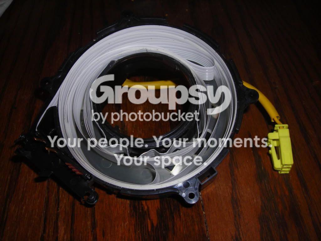

2 weeks later the ABS and airbag lights came on. I checked and my clockspring looked like this:
DSCN5002.jpg~original

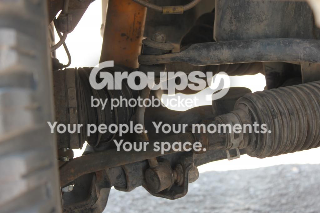

The last mile or so was all driving in granite, not sand, and was a lot of fun, but I didn't take any pictures. This was the only casualty and I already have a replacement in the garage:

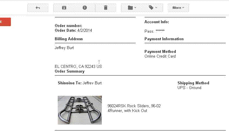

I also have this to update:

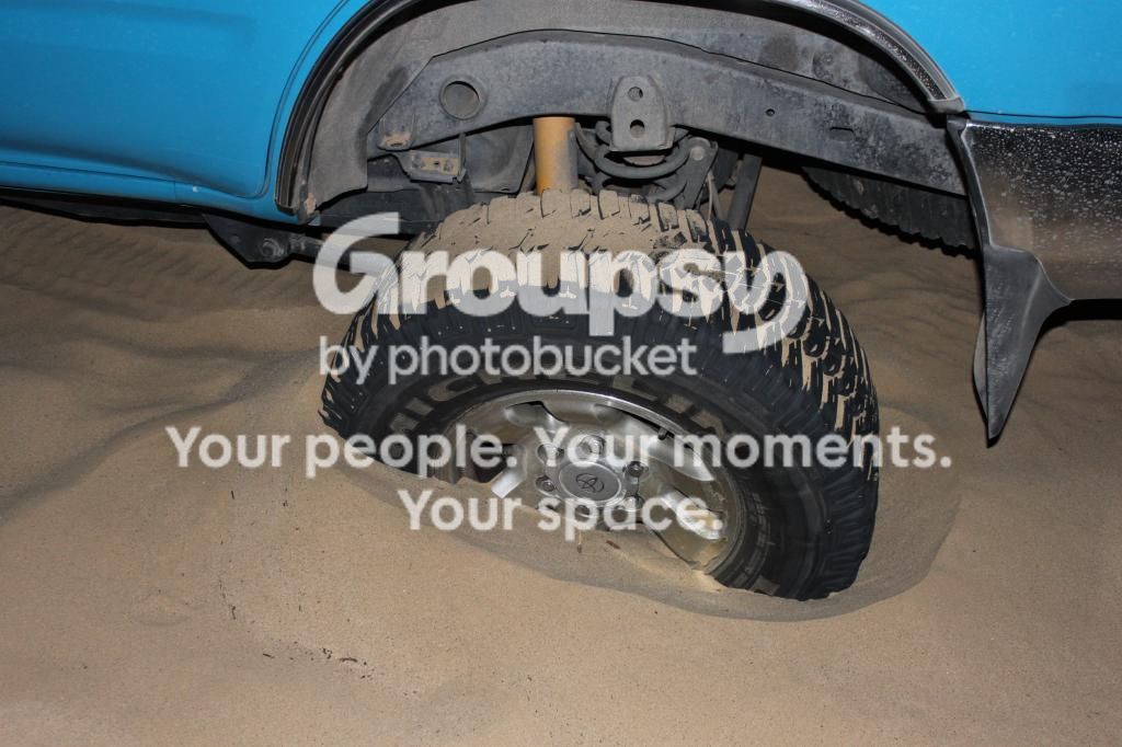

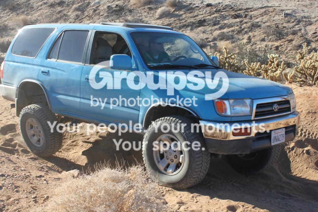

I went out with a buddy to superstition tonight and had fun driving in the sand. Only had one place where we got a little stuck. Luckily I carry some 2x4's and a shovel. We were out in about 5 minutes. This is the only picture I took tonight.
IMG_7383_zps6f3fb807.jpg~original
That side was almost up to the axle. The other side was sitting on top of the sand nicely. Once I shoved the wood under there and locked the axle we rolled right out.
We did however deal what I feel is the final death blow to the front passenger shock. There was oil and sand stuck to oil everywhere and now I've got this nice clunking all the time coming from that side.
