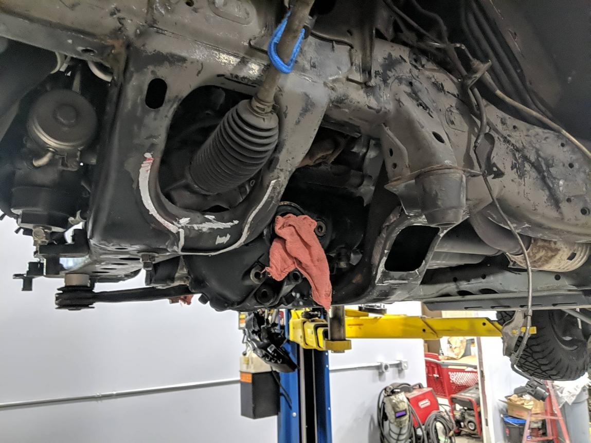

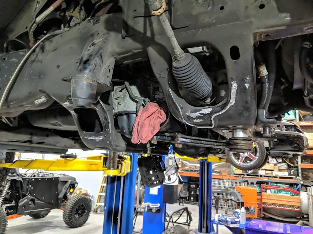

Point of no return

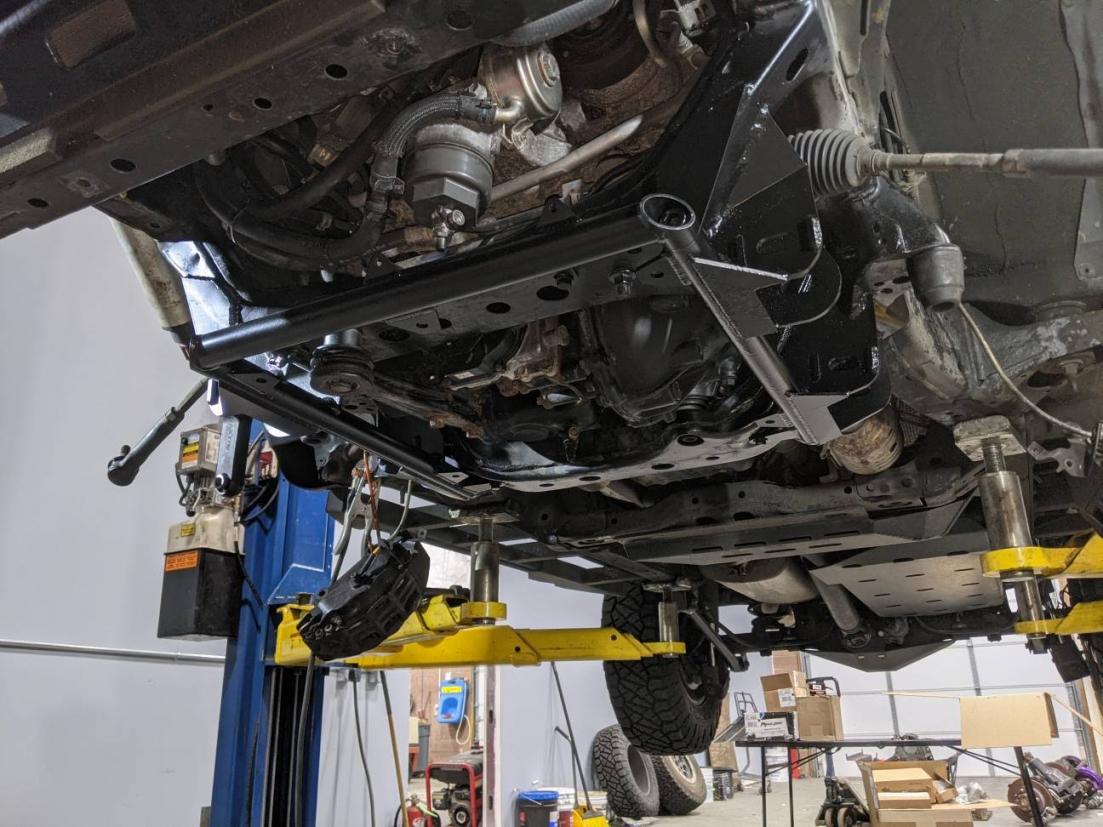

In progress

The guy that did the install on the FJ told me that the kit had the pivots 1" wider then his FJ is specced for.
I'm not sure if the 4runner is closer to FJ spec or Tacoma Spec
But i guess i will have the issue
His camber was 2-3 on both sides.
They didn't mention much of any issue fitting them, but i guess they will just bill me, shop already asked me if they could make all the small decisions with doing things to make it fit.

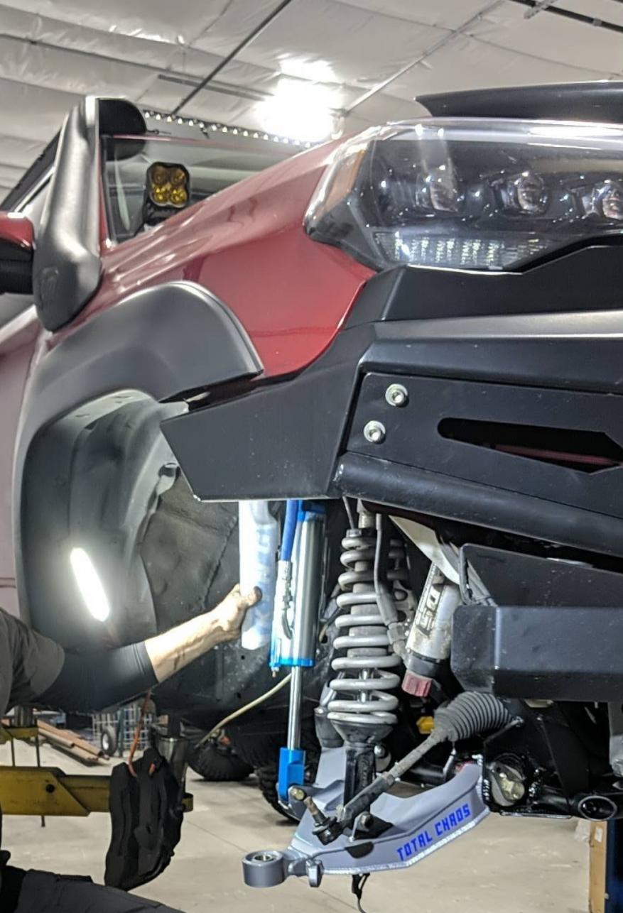

The lower arm pivot is mostly done. but i have other things being done as well.
Nothing matches hah. Red JBA ucas
