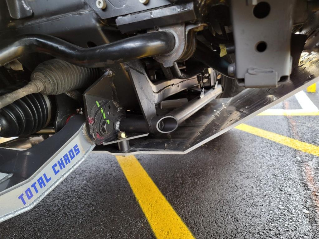

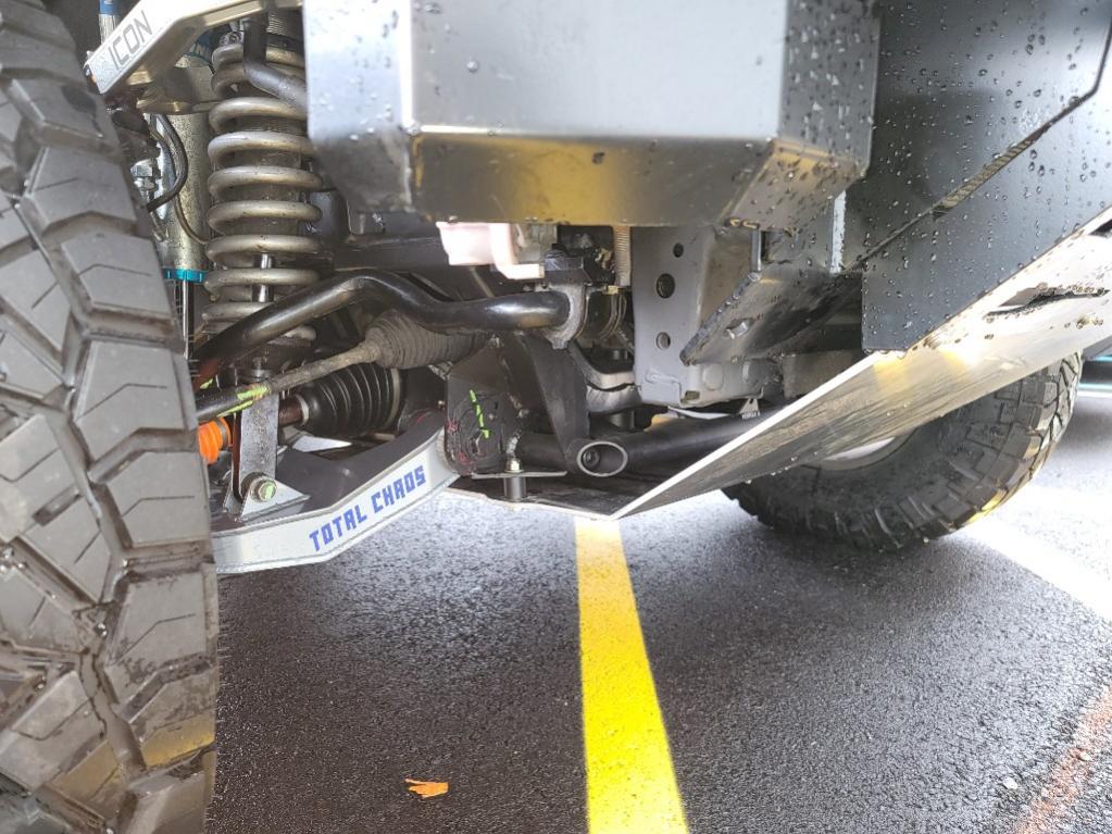

Don't forget you will need to relocate your sway bar even further forward. All finished.. but my freshly warranties rcv axles that needed new boots after 6 months, are getting sent back. They sent me defective warranty axles...

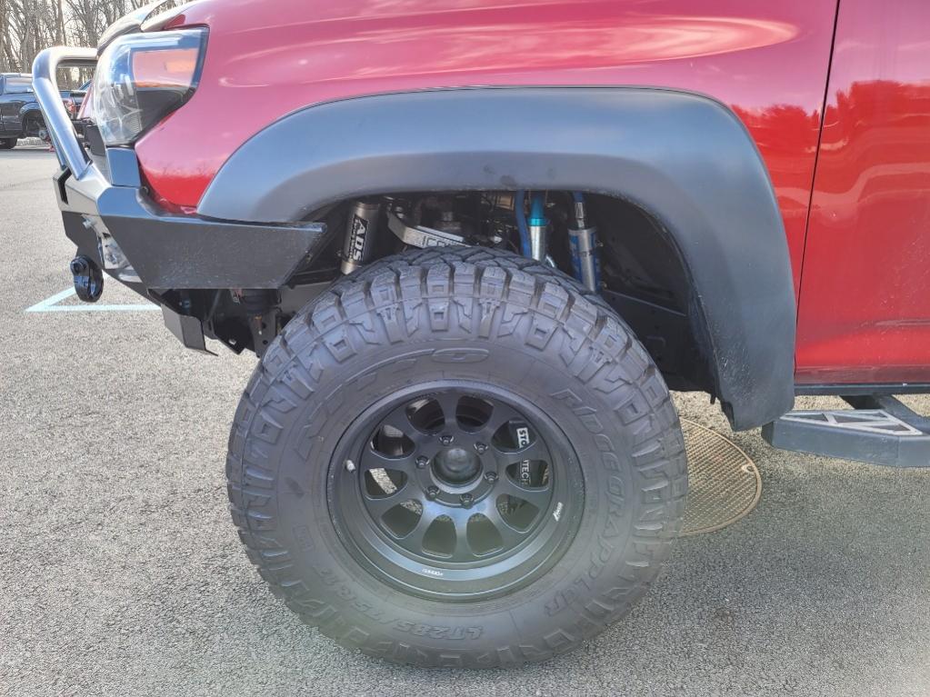

Also, could you take a picture from the side of the vehicle to show how much space between the tire and the body?
baller build, mid travel with all the goodies. that kit would be amazing with a 3.5" long travel kit too.
