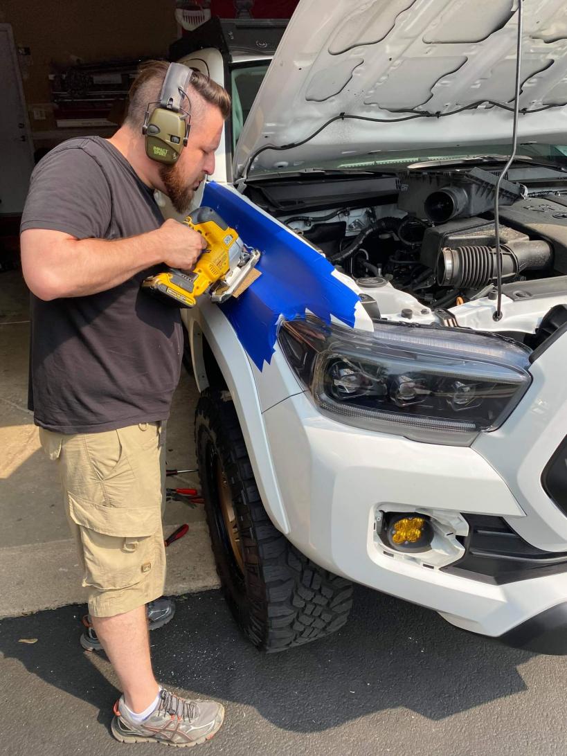

You probably can get away with using a jigsaw, but it's not ideal.
The problem is the area where you'll be making the hole is a compound curve and you won't be able to get the jigsaw to lay flat along the surface. So for most of the cut you'll have an air gap between the bottom of the jigsaw and the metal. Lots of vibration in your future.
I'd aim small, and finish with a file.
Jigsaw worked perfectly for me for the big hole. Just take your time, use a medium, controllable speed and wear eye/ear protection. It’s LOUD.
I started my cut with a drill hole (within the templated circle surface) big enough to fit the blade.
Metal fine blade of course. Figured I'd ask before getting all choppy chop with it tomorrow.

Absolutely, but cover the entire area of fender in painters tape as well as the base of the jig saw and just go slow. Works better than a cut off wheel, way less heat.

Make sure the blade is long. Otherwise while transitioning from the hump to shallow it can stroke/rise above the fender and punch the fender instead of cut thru.

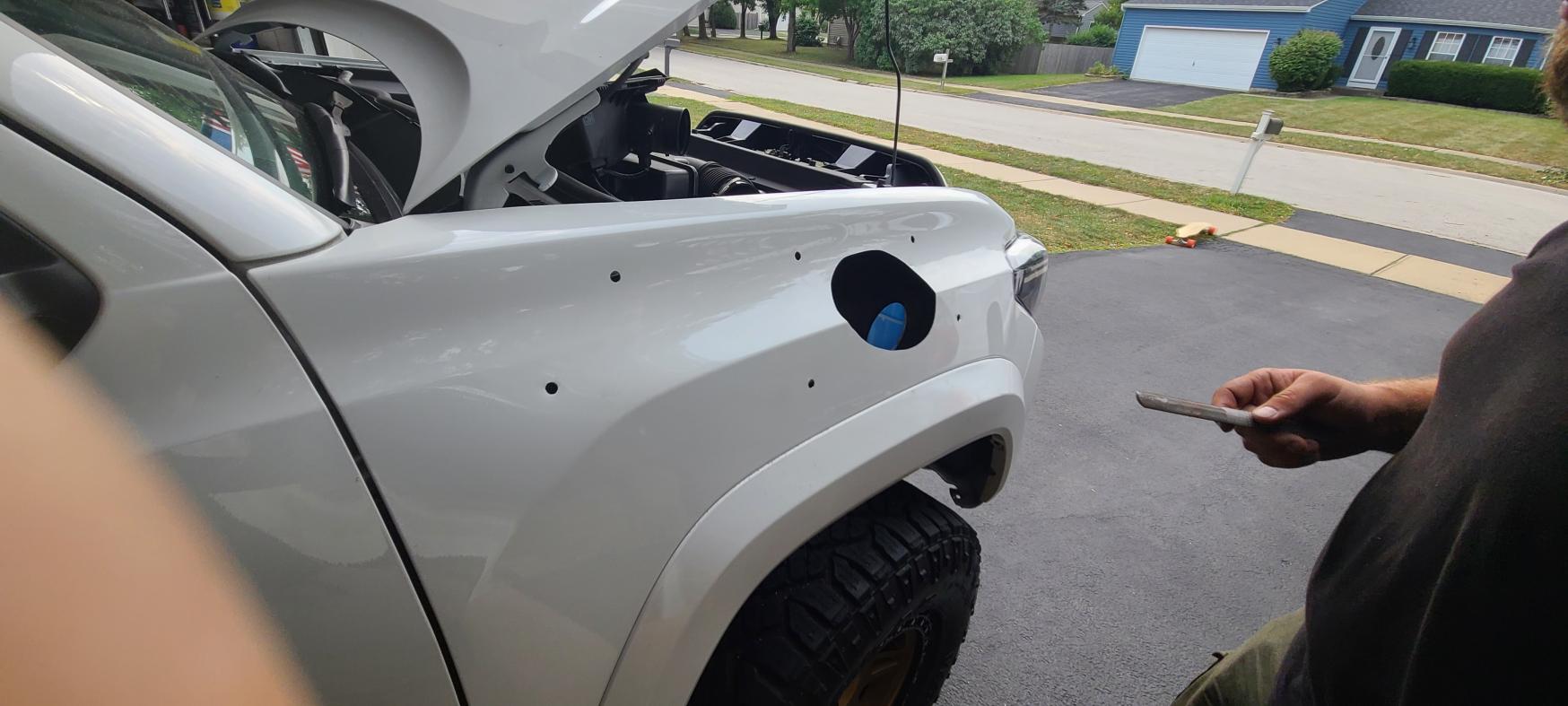

I used cardboard to make sure no rubbing on paint, it's poorly depicted in photo. This is when I just started. Take your time. But was easy. Use a round file to smooth edges.

This was on a 3gtaco
Mines likely next :)
We did not fill air box hole due to IL being so wet and would rather use the drain hole that go swimming that deep
