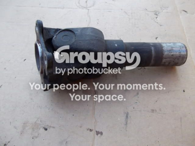

The U-joint was actually one of my smoothest repairs to date, but I know you have seen my build thread, so that isn't saying much... It's not bad though. Mine was COVERED in rust, to the point that I couldn't tell the difference between the bearing seal and the retainer ring (I wasn't super confident about what pieces were where). As a result, the first bearing I pressed out I hadn't actually removed the c-clip and ended up shearing it off in the press. It damaged the yoke a a little bit but I was able to file it down a little to fix it.
Anyway, the only tricky part for me was getting the yoke to sit flat in the press. Toyota for some reason cast the yoke such that it doesn't stand straight up and down in the press, the arms have an angled side to them which make them sit crooked when pressing.
DSCF0285.jpg~original
(this isn't mine)
In this pic, the bearing cup is the round part, and if you compare depth of the bearing cup at the tip end of the yoke arm versus the root end, you can see that the outer face of the yolk (where the parting line of the casting is ground down) is not at a 90deg angle to the bearing cup, which means it won't just sit upright in the press, you have to chock the tip a bit. Google image search makes it look like other brands thought of this and have a lip around the bearing cup cavity so that it will sit straight in a press...
I dealt with this by cutting one of the old c-clips and putting it under the tip end of the yoke arm to make it sit flat, but not interfere with the bearing cup (the c-clip is slightly smaller diameter than the outside of the bearing cup, so even this isn't a perfect fit...). It was a bit of a balancing act to get the yoke with cut c-clip balanced on top of a big socket so I could press the bearing cup out, but I eventually got it.
BTW, I was shocked to find out that 2 of the 4 posts on the u-joint were covered in rust, meaning they hadn't been in contact with the bearing in a long time (long enough for the bearing surfaces to rust). For the last couple years probably I have been driving on only 2 of the 4 u-joint bearings. The 2 that were left were also dinged up but clean. I was amazed that I only recently felt any driveline vibration from it.
