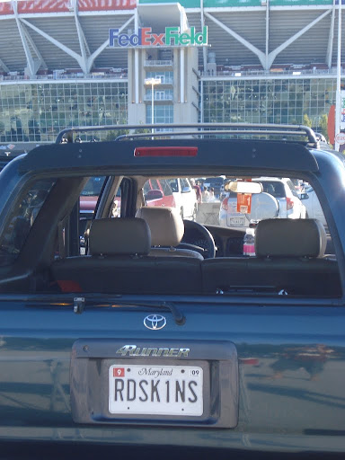

I got my 98 sr5 from my father in 2003. Here's the only pic I have on my current computer:

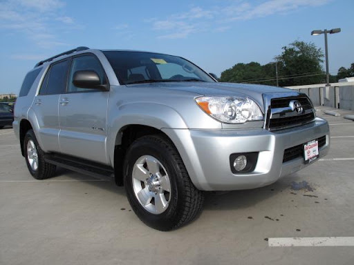

Putting my 19' Grady White away during July 4th Weekend 2009, my transmission started slipping so I traded it in the following week for a 2006 SR5 4WD (v6):

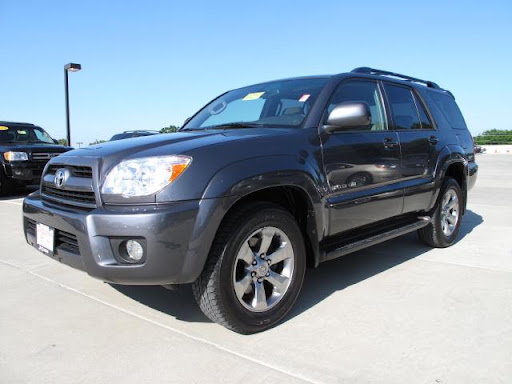

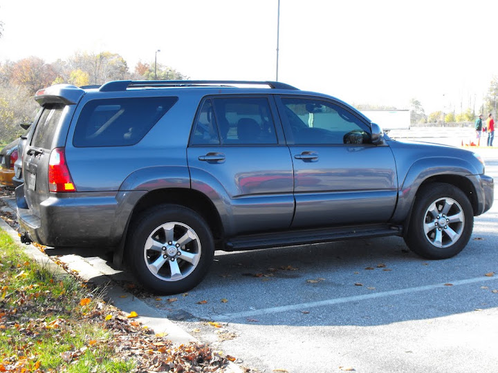

24 Hours Later, I traded that back and got the 06 LTD 4WD (v6):

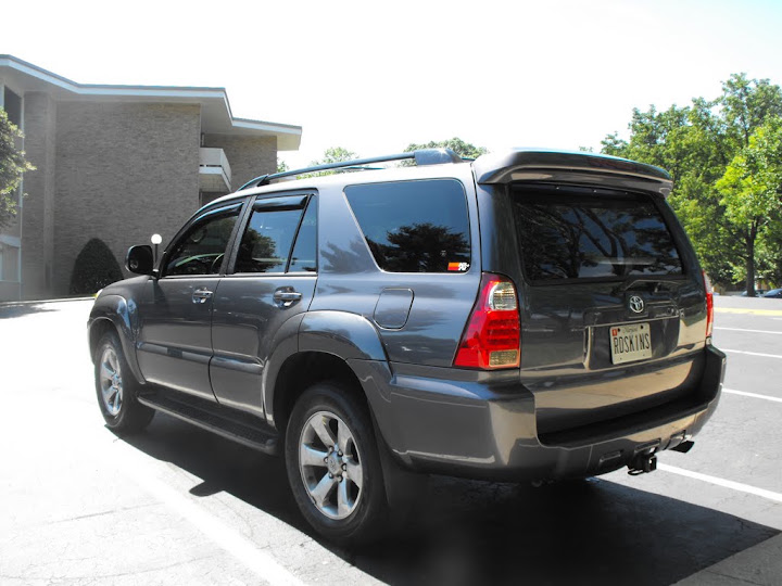

Tint/LEDs/x50
First thing I did was tint the front, 20%:

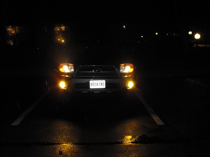

...and put in whiter lows and yellow fogs (temporary until HIDs):
only the fogs (no pics with new HLs yet, will update when I get around to it but I'm a bad night photographer!):

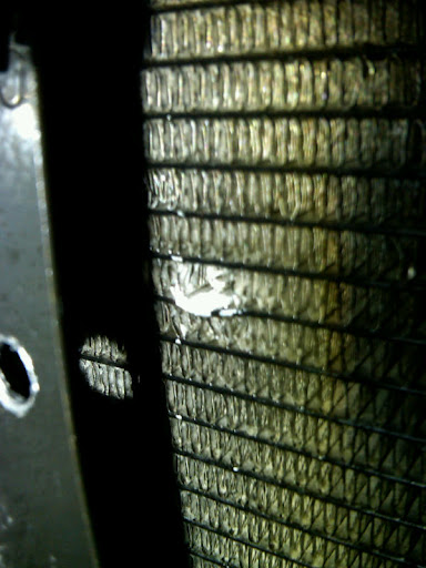

but during the install, I hit my condenser while drilling mounting holes:
So the install went on pause until I replace the condenser...will update when I get back to it.

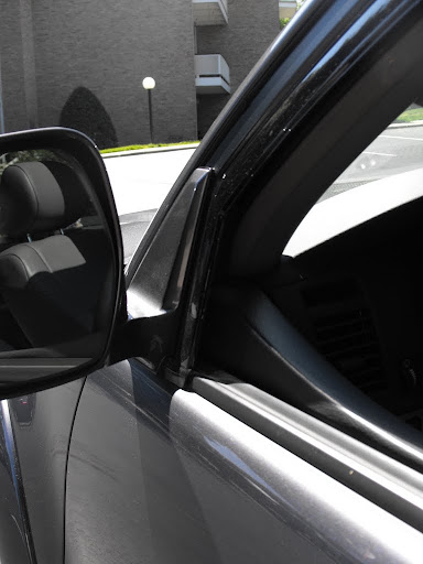

My vent visors came around the same time as my tranny cooler. If I did it again, I would have gotten weathertech. I bought some "EGR" visors off ebay but they sent me Stampede brand, which I never heard of.
They looked good so I installed. Ran into issues with the tape not being all hidden. I had to exacto and peel pieces out, took a long time and have some scratches on them now! Either way, they're on for now and functioning pretty well. They do have some bubbles and bumps that don't make it look as clean from the inside as I would like.
Here's a closeup of the front window. I like how it covers the entire area. Notice that it is mounted on the outside at the bottom of the mirror, this is the only external tape but I think it provides a good hold. Not sure how this compares to the other In-Channels but it's what I've got!

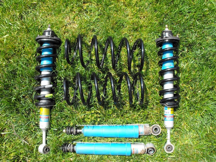

FJ Suspension Swap
My most exciting mod to date is my FJ Trail Teams suspension swap. I found a set of the 2008 FJ Bilstein shocks, struts and springs with 12k miles for $160, so I jumped on it after consulting with members of this forum.
Still deciding the spacer size to put in as I've gotten mixed reviews on the height gain from these alone but I'll probably do the 1" Daystar. It's going to be a little while before I get these on but I couldn't pass up the opportunity to buy them.

did you install the entire FJ suspension or just the springs?
what are your impressions of how your new suspension rides vs oem stock?

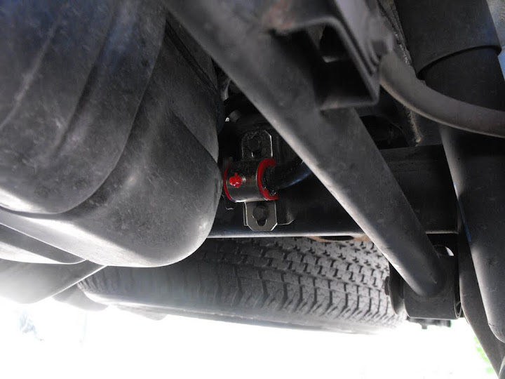

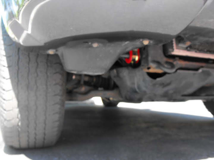

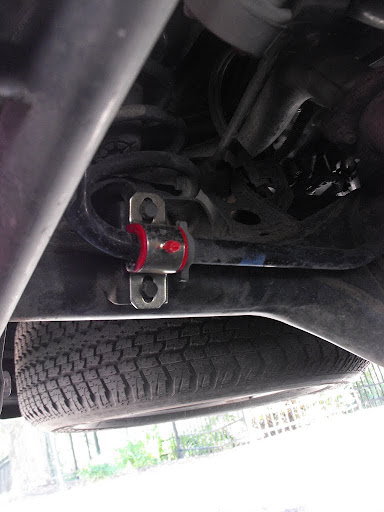

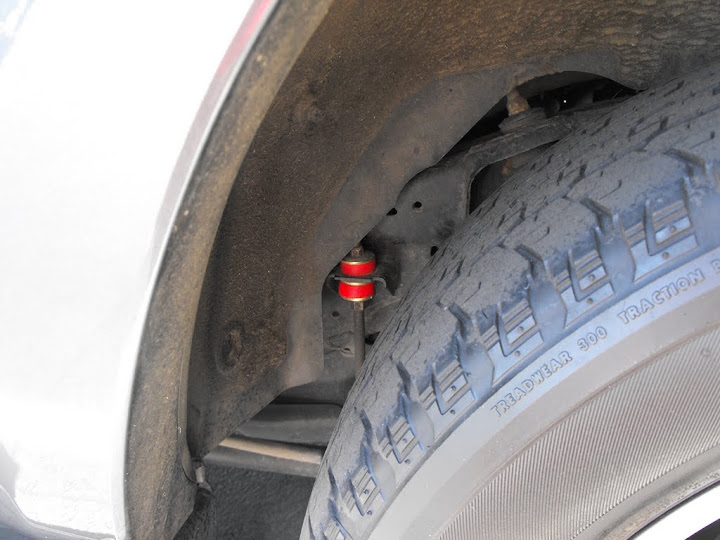

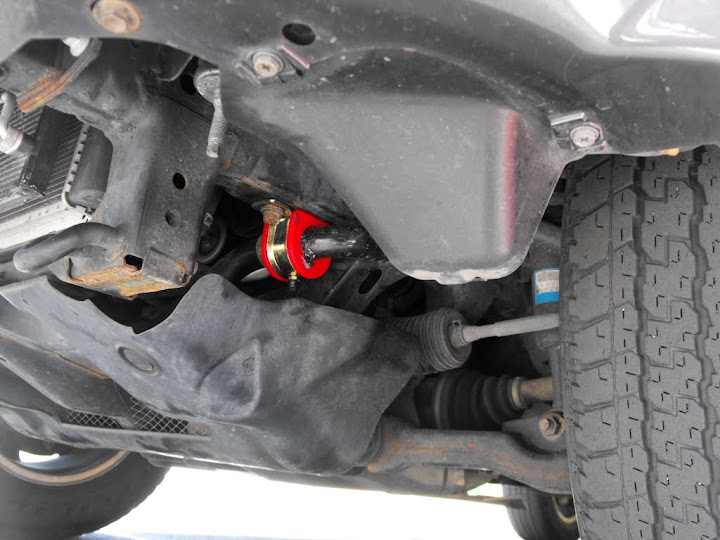

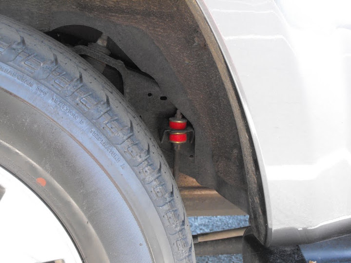

did you notice any difference with the new bushings?
YES! best/easiest non-aesthetic mod I've done. Also grease my Zerk fittings on the driveshaft now.
haven't installed yet, literally took that picture an hour before I posted it. From what I've heard, I expect a firmer ride, especially with the bilsteins. I'm wondering how much of an impact it will have to my cornering ability since I love the affect of the poly bushings and don't want to lose it too much!

just noticed the pic of fed ex field. I am right down in st. marys county! do you ever go to green ridge or GW national to off-road?
Forgive my noobness,
Is "Trail Teams" an upgraded OEM FJ suspension? Is it a special package or the stock stuff? And the 1" Daystar is to level out the rear, correct?
IIRC, FJC's come with 3 different suspension setups, all the coils are the same:
1.) standard: black Tokico shocks
2.) TRD off-road: sliver Bilstein shocks
3.) Trail Edition: red Bilstein shocks.
then I must have the TRD off road. Blue Bilsteins, guy just advertised them as "trail team". I can't wait to get them on. I'll either level with the 1" or maybe do something like a 2/1. I won't have time to get them on for a while so we'll see what I end up going with.

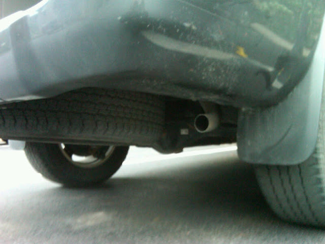

with the gibson muffler on the way, I decided to cut off the resonator to see what sound difference was made so I could decide whether to install the gibson.
What looks like dents in my bumper is actually the reflection of the resonator and saw I used to cut it off with.
It's a little louder in acceleration and drone but not very throaty. Still debating whether to put in the gibson as I want a little more rumble but not too much!

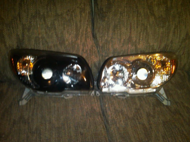

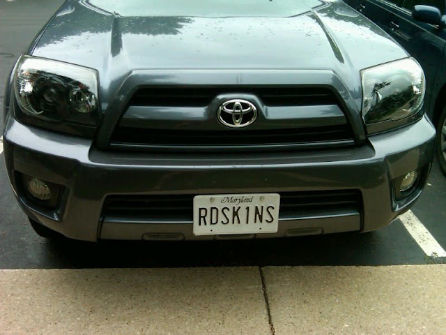

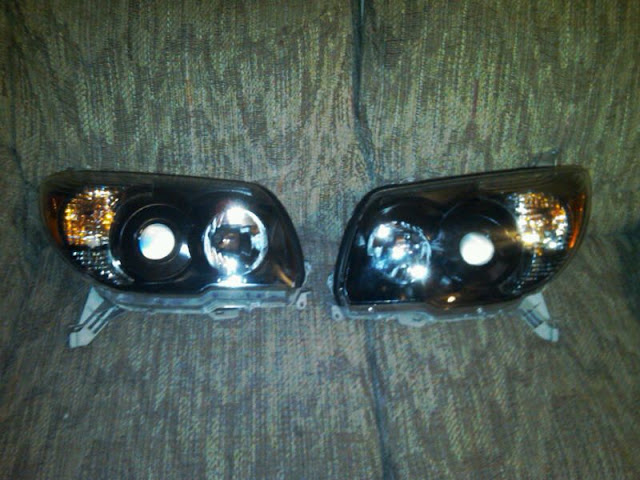

Blacked Out Headlights
My passenger side headlight had moisture in it so I took it out to bake and re-seal. Once I had it off, I decided to try blacking out. It was so easy (although time consuming) that I immediately went out in the dark and took off my Driver's Side and did that one as well (I was up late!)
Made a couple mistakes and used a sharpie to touch-up scratches that happened while trying to put back together.
Items Used:
Rustoleom Gloss Black Spray Pait
Acrylic Gloss Clear Coat
600 and 100 grain sandpaper
Silicone Sealant (Clear)
Total cost: < $20
I found the 100 grain to work faster and better than the 600.
I used leftyguns' writeup here
Comparison Shot:
Blacked out:
Installed:
Love the look! Hopefully I re-sealed them well, I took my time in doing it. Time will tell...
