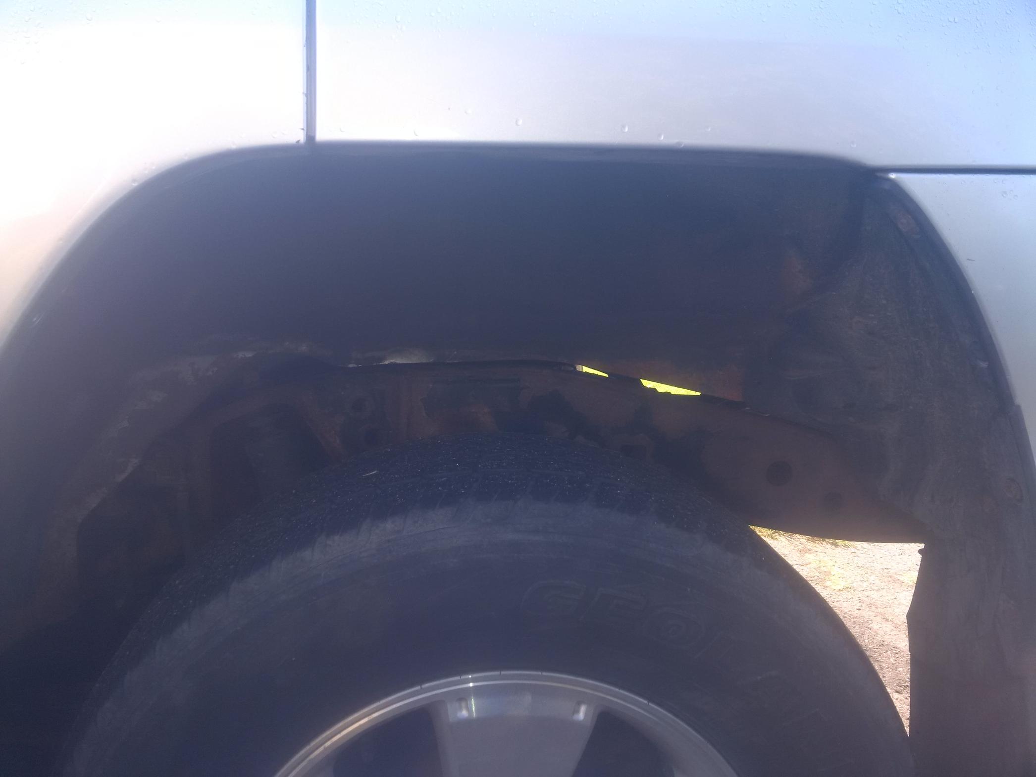

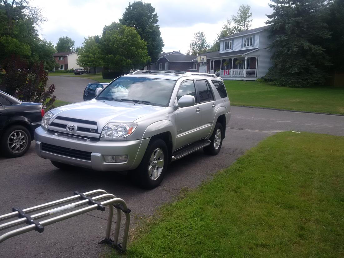

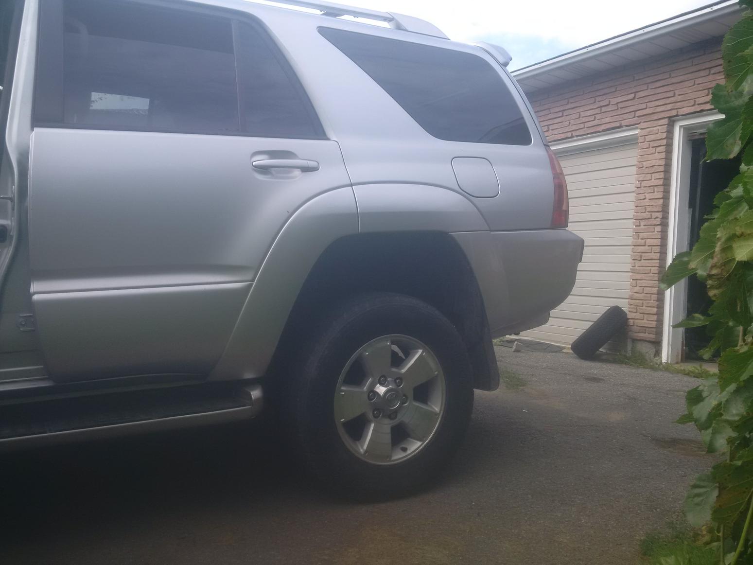

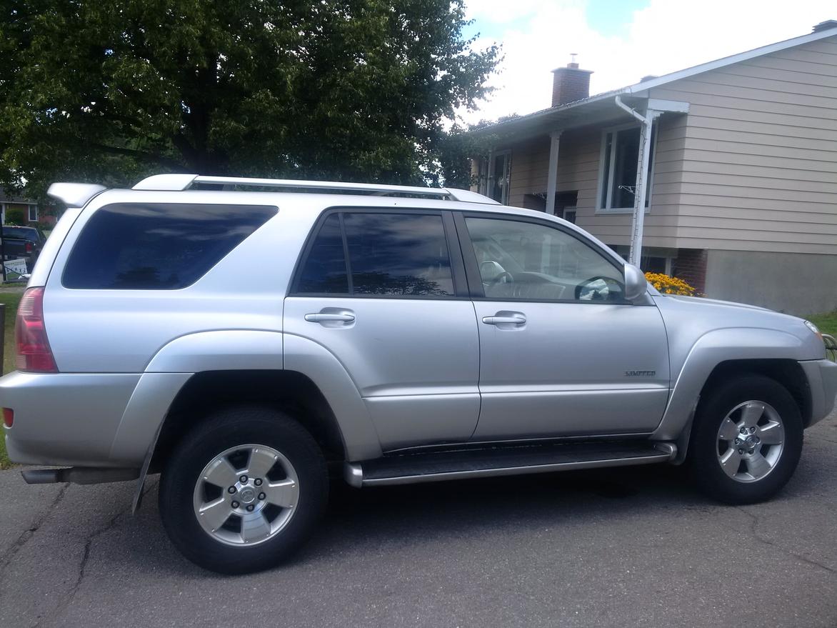

Overall still love the truck just about to tow with it and it worries me that the rear is not at proper height included a few pics , one that shows the rear is soo high ( thinks its in neutral height ) you can see light above the frame

I'm not sure from your post whether or not you have the optional RAS (rear air suspension) or not. if you do, you would have height control switches in the center console between the seats.
The 4Runner does have a factory rake (slanting towards the front) that makes it appear that the rear end is higher in the air than the front end.
From your pictures, it does not look too much different than mine.
If your RAS is indeed stuck in the high position, I imagine the ride is pretty stiff. My best guess will be that a height control sensor has failed if this is indeed the case.

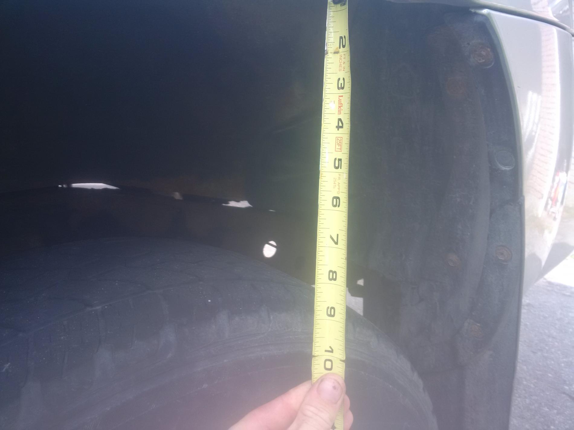

Couple more pics , my rear wheel gap is around 9inches , front is around 5 that is a pretty big difference.
The pics in first post where of when i bought the truck two weeks ago and when as far as I know the system was working and I did not have such a huge wheel gap ( I swear when I got I didn't think I could see the top of the frame tube inside the wheel well ? ) it has only recently become "stuck" when I was trying to pressure wash the underside
