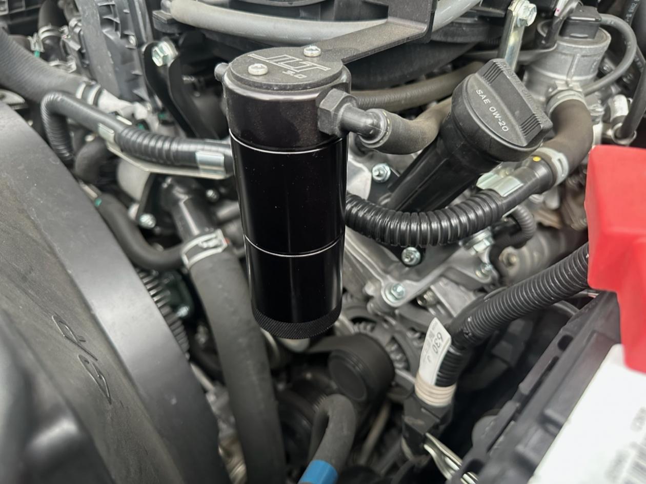

quick update on the catch can findings
Changed my oil today and after 3000 miles of having the catch can on it was almost full to the top of the can. The can holds 3 ounces of fluid. To each their own but I feel better running one on my truck. I am also the guy that changed the oil at 1000 miles then again when I hit the 4000 mile mark. Now ill switch to changing it every 5000 miles. But i will continue to check the can every 2500 miles or so.
If you have a J&L can they offer an extension. I believe the part number is EXT-B for the black extension.
