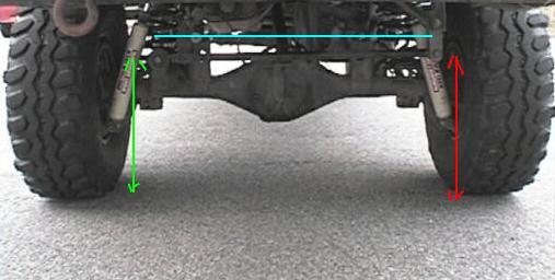

Your rear is a 4 link with panhard. The panhard bar should be parallel to the axle for best performance. If you lift the truck, youll change the angle of the bar, the drop bracket brings it back to stock.

Another link for you, from 4crawlers site. This guy knows his stuff. Scrolly down about half way, he explains it better than I could.
Toyota 2nd Gen 4Runner Coil Spring Spacers and Panhard Drop Bracket
