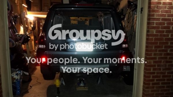

I was one of those geniuses...Instructions said to let the transmission reach operating temperature then remove fluid level check plug to see if excess fluid spills from it. I did that but for some reason decided to turn off the engine before replacing the plug which caused the ATF to rush to the oil pan and gush right out of the unplugged hole and all over my garage. I estimated the lost fluid to be about 1-1.5Qts so I blindly filled 1Qt and took the car for a full flush / fill the next weekend.
Here are the instructions for the sealed transmission if you haven't found them already:

20150925_212340_zpsuthwxwxq.jpg~original
