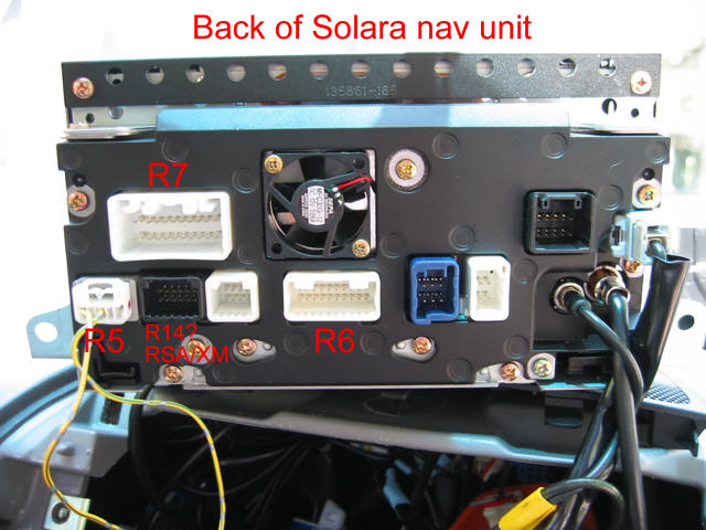

Webshot,
With my Solara Nav in my Sienna I also have the rear seat entertainmnet (DVD) so I wanted to know which connector(s) you have to tap into or use to get the changer to work. I assume its the connector on the attached photo that Jack has labeled "R14? RSA/XM". If not then which one is it?
thanx
Yep thats it, R14
Could you by chance document which pins are being used on this connector? Color of wires might come in handy also.

gsr2is300 said:
Does the factory NAV on the 4Runner have this same port to plug into, or is it unique to the Solara NAV?
Yes it does. Same plug for Rear Seat Audio which you probably have.
