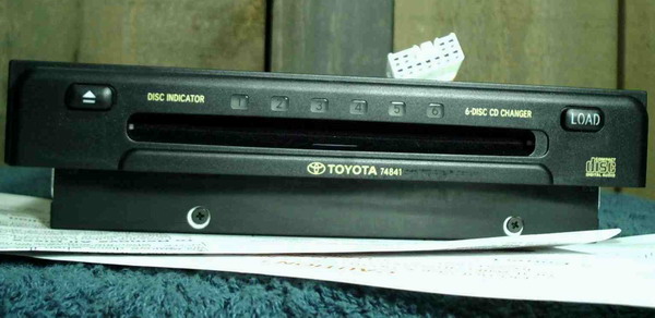

I gave up with the MP3 player scenario, and installed a factory CD changer. I ended up putting it in my glove compartment on that top shelf thing.
But you cannot listen to CD-Changer CD's from the RSA. Everything else works (incl. steering wheel controls), but the back seat people are stuck listening to the standard sounds (CD/Radio) and it will play burned CD's just fine... (just in case you guys wanted to know)
j0.
