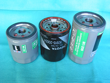

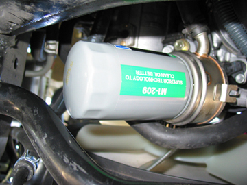

I am using Mobil 1 10W-30. The dealer here says they use 10W-30 in everything. I am using the Mobil 1 M1-209 oil filter instead of the M1-102. It's a bit longer. I assume there is more filter area. I will disect it and compare with the factory and M1-102 after the next oil change.

Ken, thanks for the tip on the 209 filter.

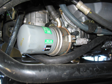

This weekend I'm installing an OilGuard bypass filter. Used them in industrial applications and for under $200 I wanted to add the protection to my engine.

You will hear a lot about oil that is not based on real world testing but this is a close as I can come. I'm using 5w-30 Mobil 1 with the Mobil 1 filter (the 209) and changing at 5k miles to keep my warranty in place.

I am using the longer 209 filter and want to thank you again for the tip.
