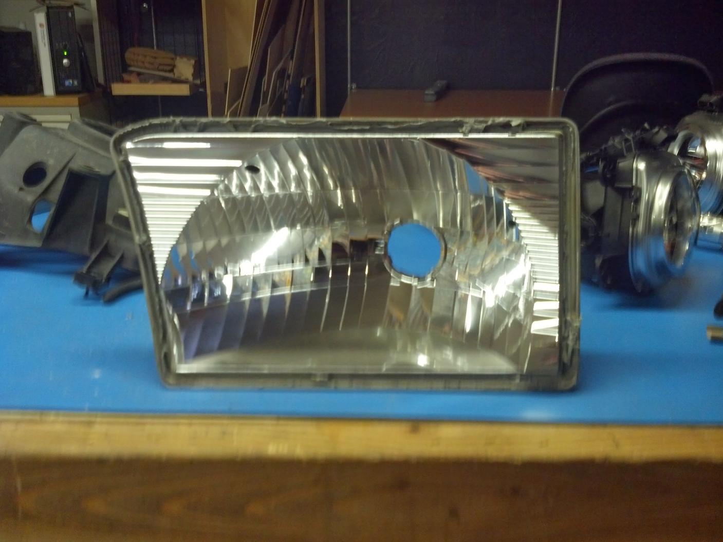

I plan to do a full write up on how I install the fxr lenses, Ive got access to basically a full machine shop with mills lathes and cnc versions of both as well as a nice laser cutter.edit: I just ended up using a sanding wheel on the dremel, It worked quickly and the end result was smooth, I think I saw someone do this with a cutoff disk, and im not sure why, the sanding wheel worked really nicely.

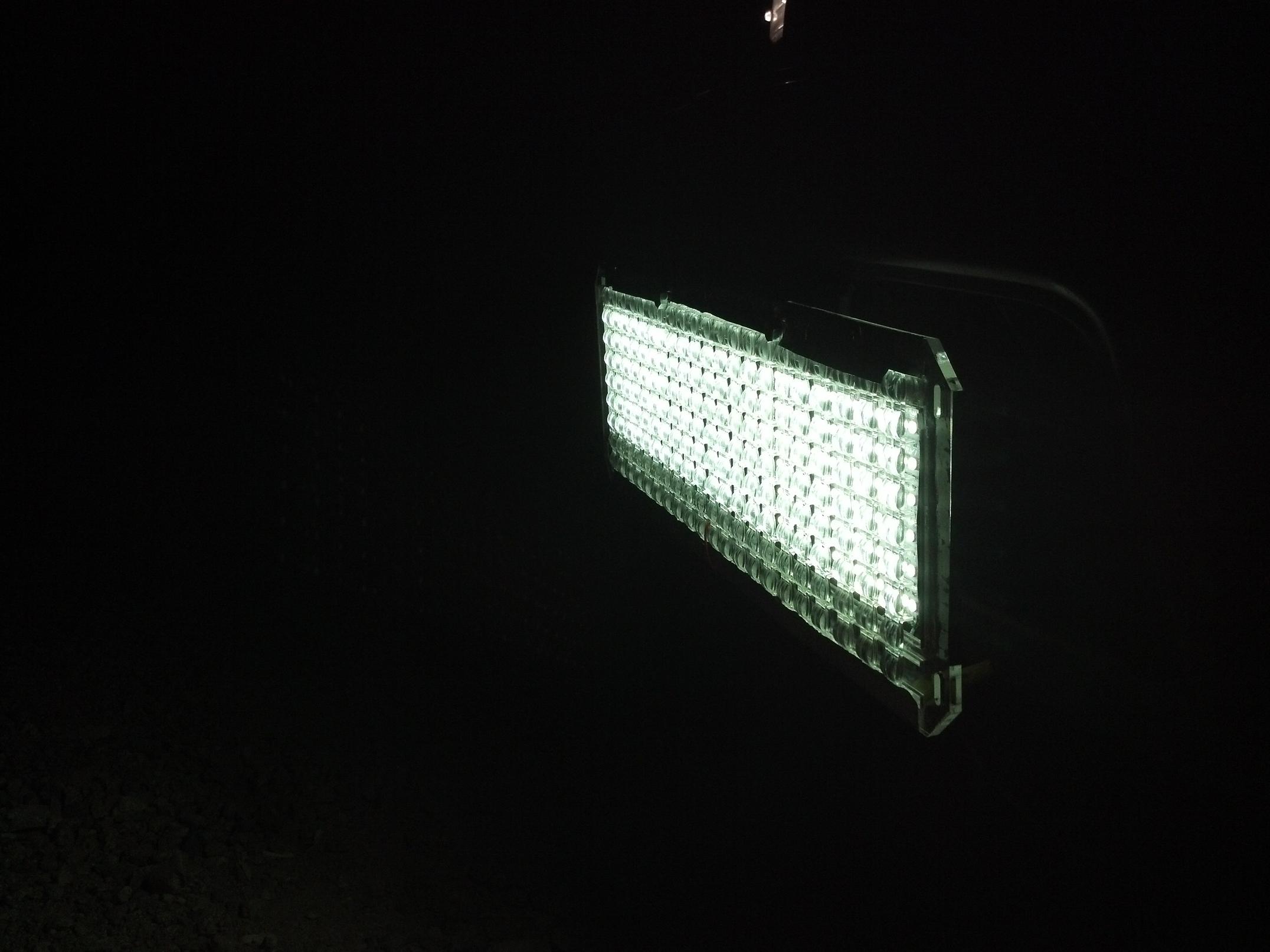

Also on a side note I was able to laser cut some clear acrylic into lenses for my day led plate, they came out nicely.

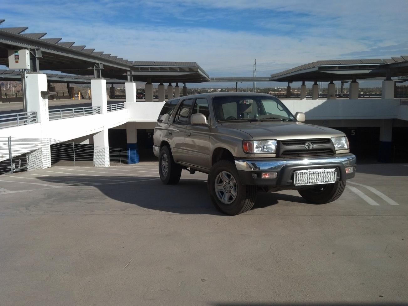

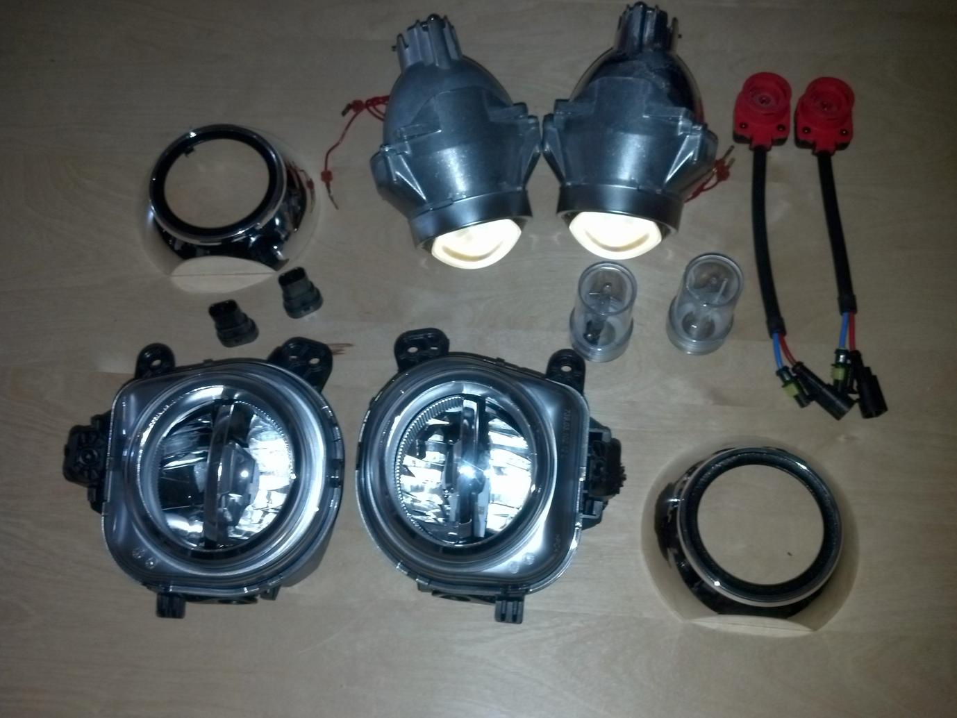

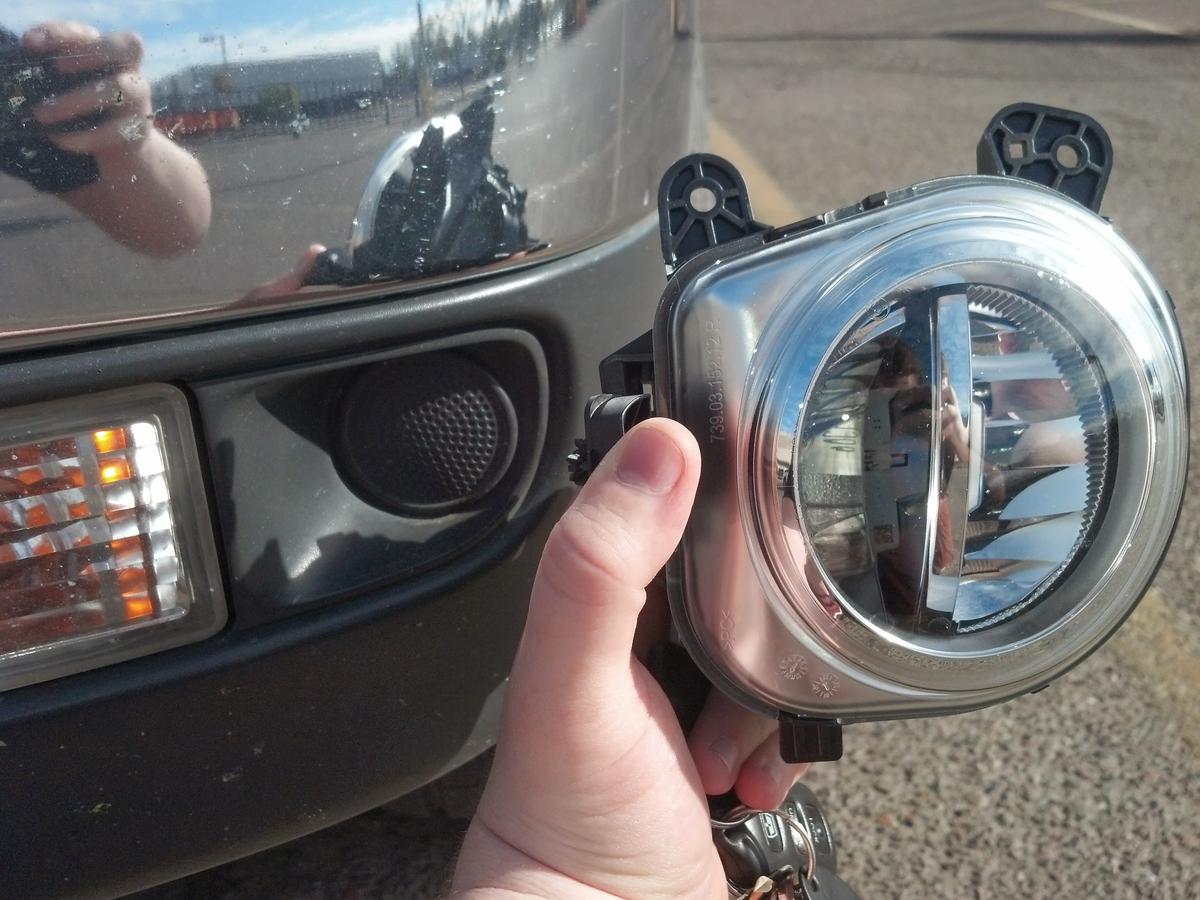

OK I got them all in finally, the fogs are huge, they wont be able to fit in the normal spot so I think ill put them under the fat lip like this

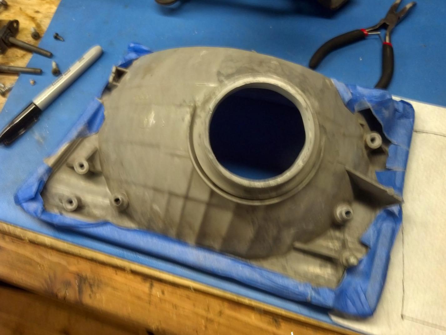

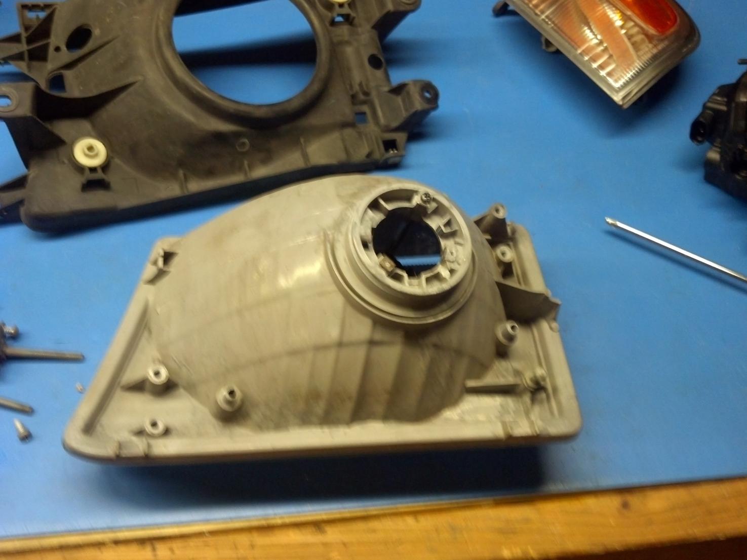

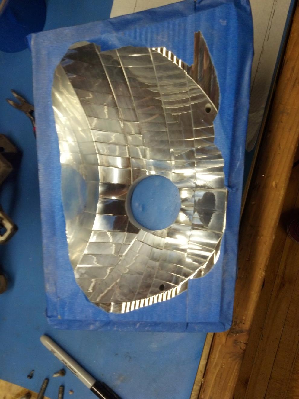

they are actually leds, and I hooked them up they are really bright, and really freaking wide. on 8.2 watts of draw each. I took apart one headlight and cut the big hole already, I need to drill the 4 mounting holes and im not sure whats the best way to proceed since it still needs to be aimed! I cut the hole by using the 1/2" sanding wheel that comes with most dremels, Initially I was using the milling bit the make the cut around the ring but it was taking forever. One thing I noticed about the reflectors is they are made from so sort of high temperature plastic that just powders when you grind it, so the bigger and faster you cutting wheel is the quicker you can cut through it, also a larger wheel will gouge less and give you an overall smoother finish.

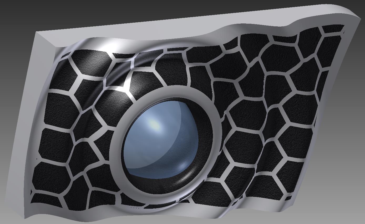

for right now I think ill stick with making my shroud. Its going to be something like this when its done. I call it the ripple effect.

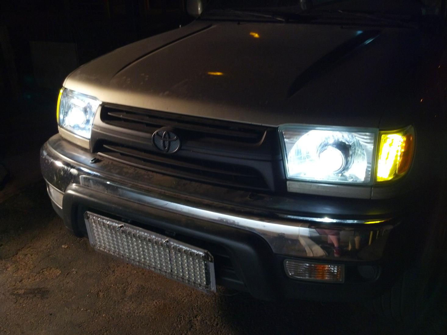

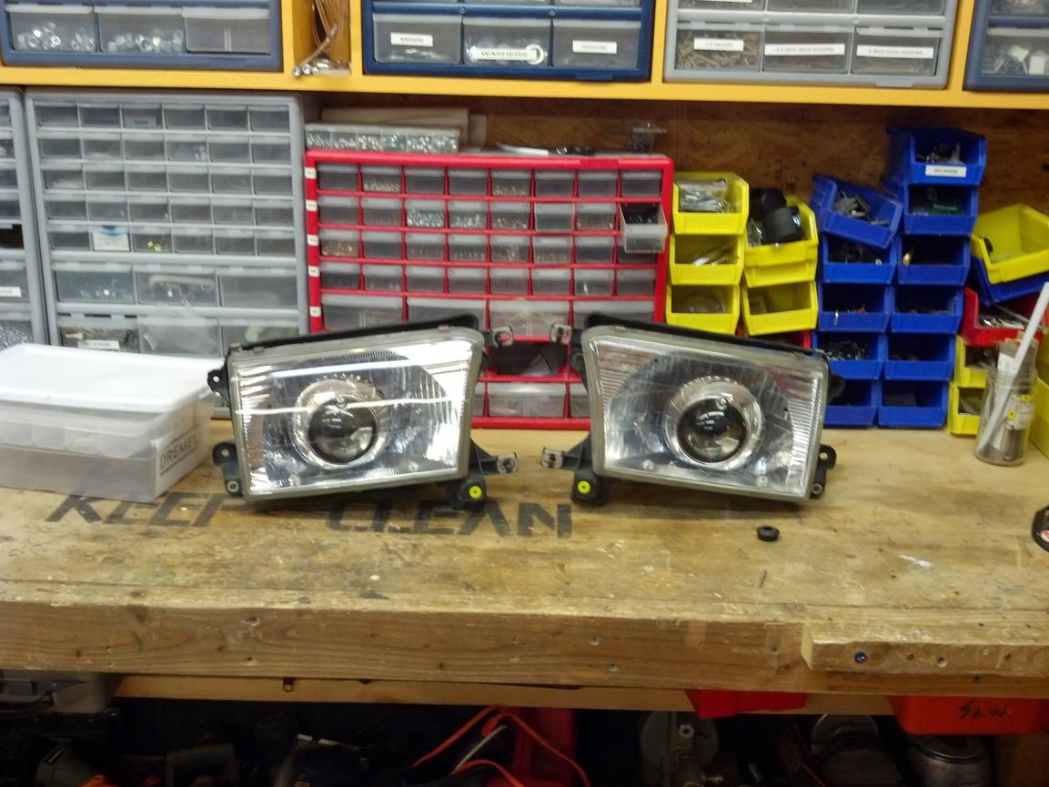

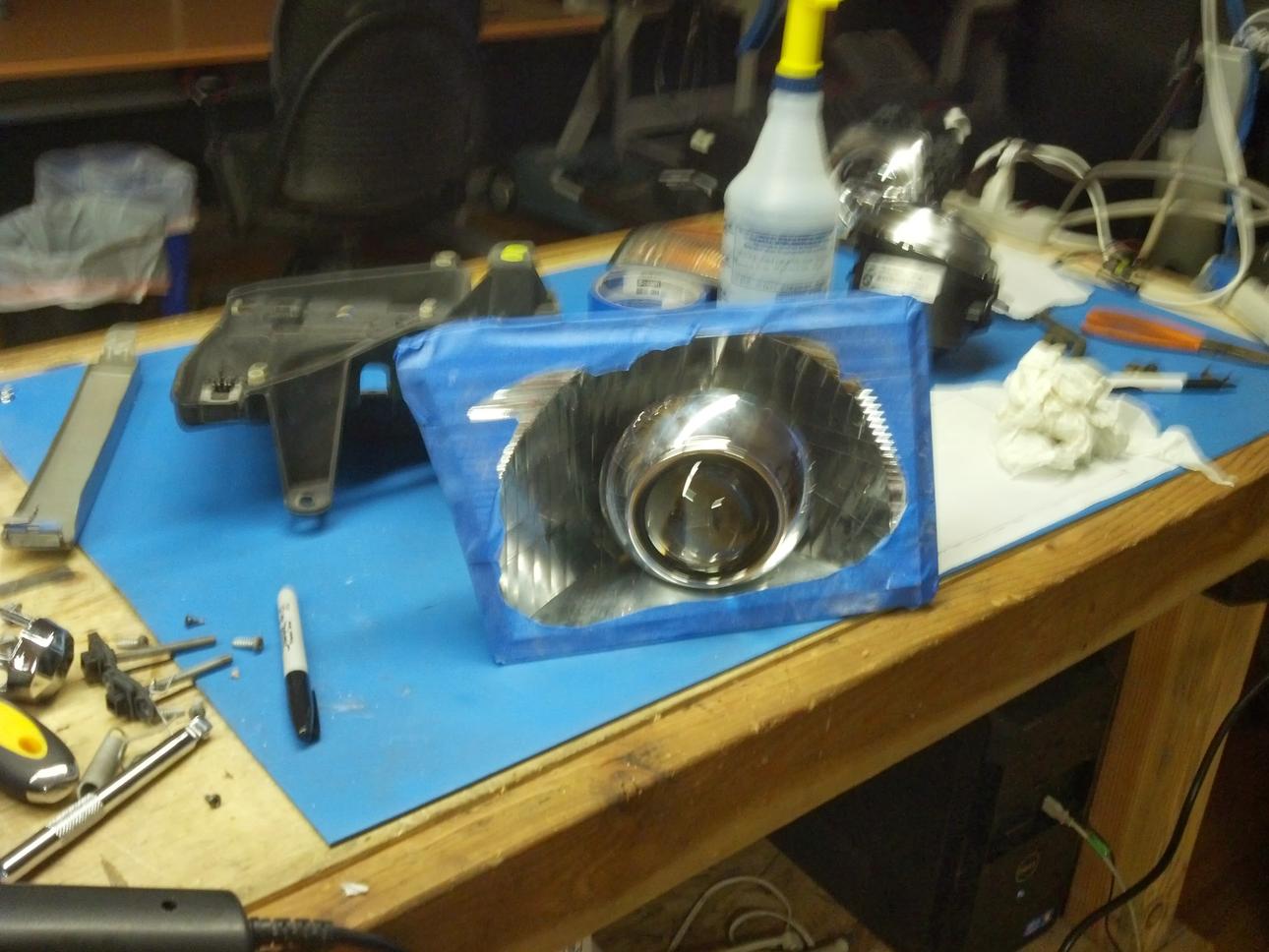

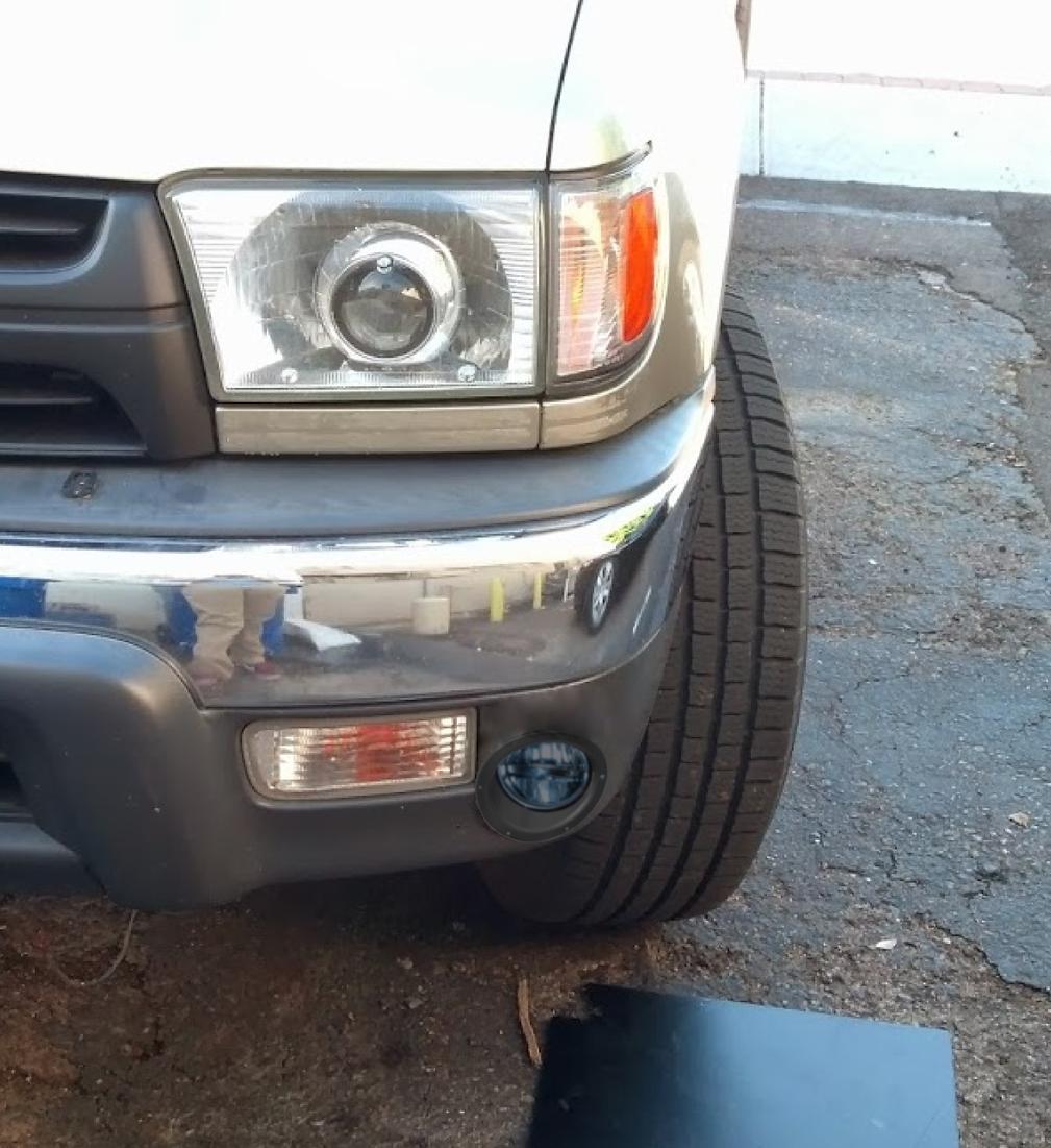

Got them installed, they look really cool and the cut off is amazing. Im sort of having trouble aiming them, I aligned the porjectors to the center of the hole and to shoot straight, but When I installed them its like the beams are not coming out parallel.
I plan on taking them apart again to seal the light from coming out and also I need to jb weld the projectors in to place. and also I need to make those badass shrouds.

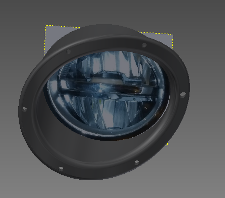

Ok so I tried mocking up the fogs today, they are not going to just bolt in even if you cut a hole, they need a tube housing that can attach to the bumper and the housing can bolt to the fog light.
Ive also attached a dxf file that is the outline of the reflector. you can open it with a free program called inkscape or import it into any decent cad program.

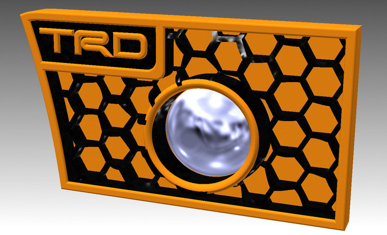

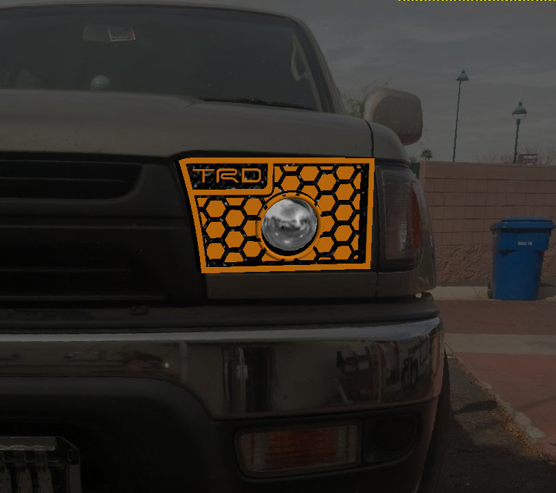

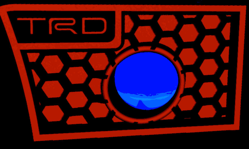

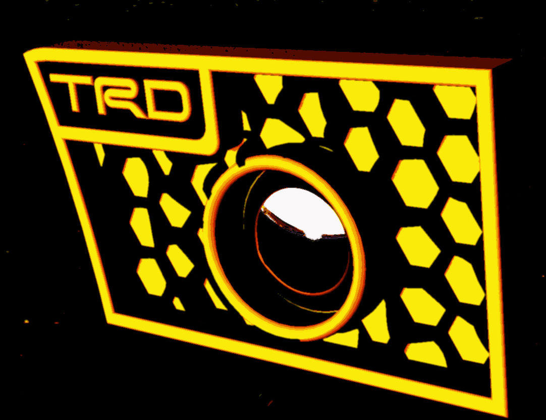

ok I got my printer running again after having some electronics fail on it, and I made all of the measurements for how the shroud will fit. Ive sort of mocked up My design for the shroud although I might change the middle part out, I even incorporated the TRD logo into it. Im going to probably lasercut the parts that look like orange neon in clear acrylic and sand them to give them a frosted finish, then Ill use some spare rgb leds to backlight the whole thing.

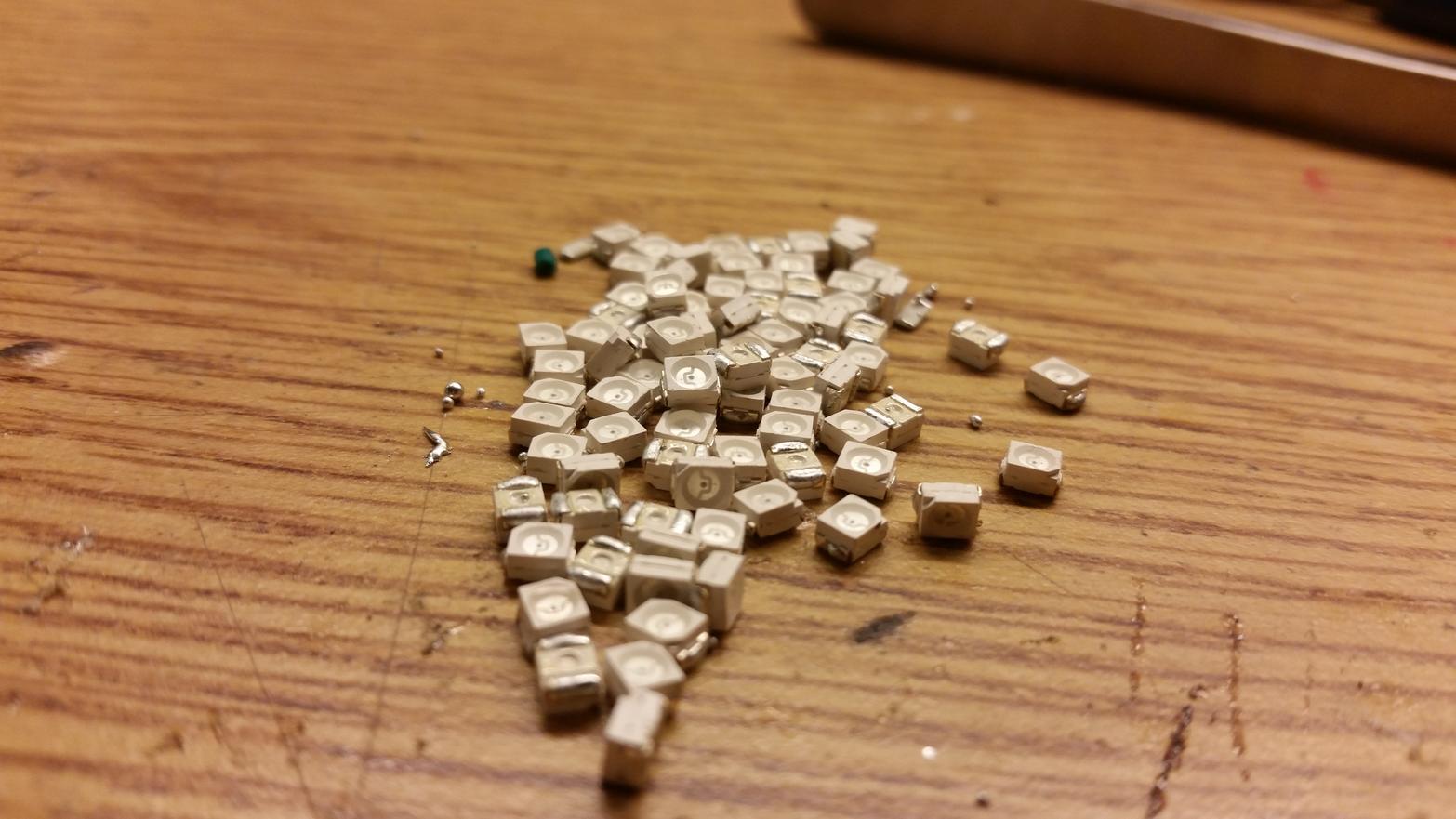

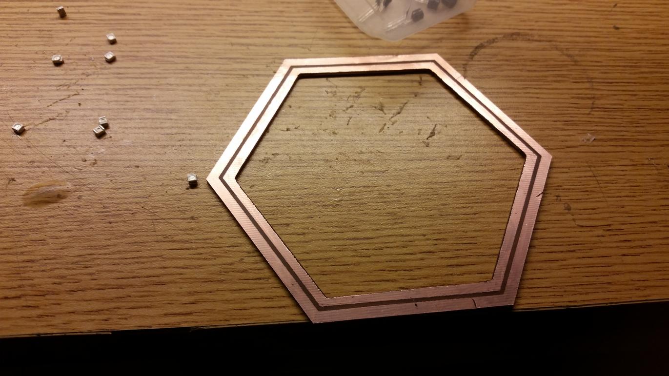

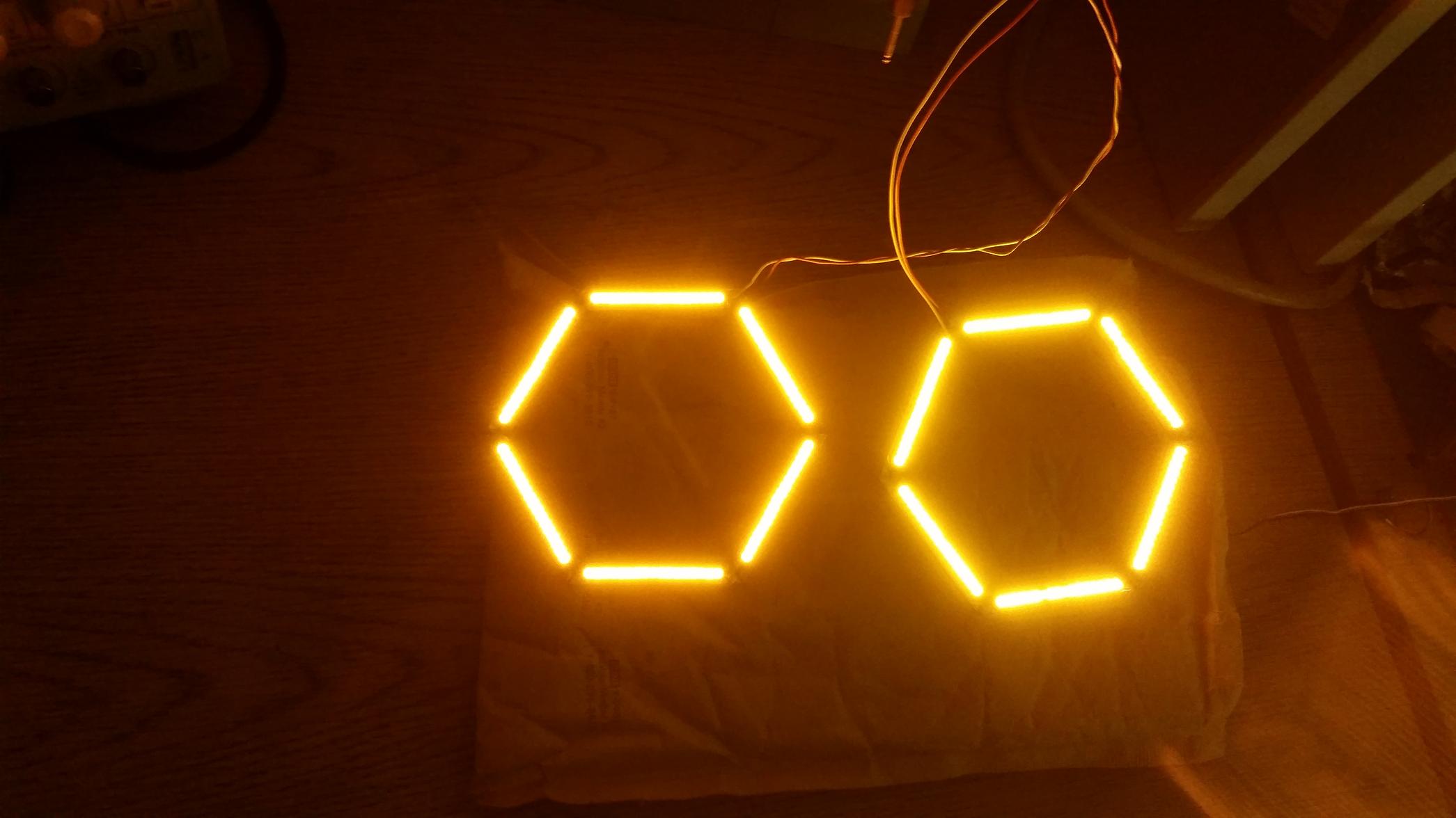

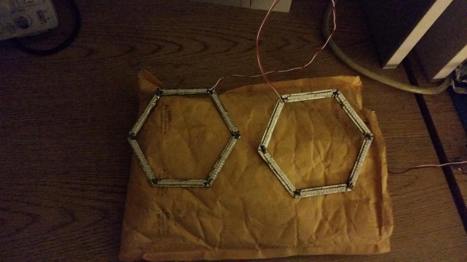

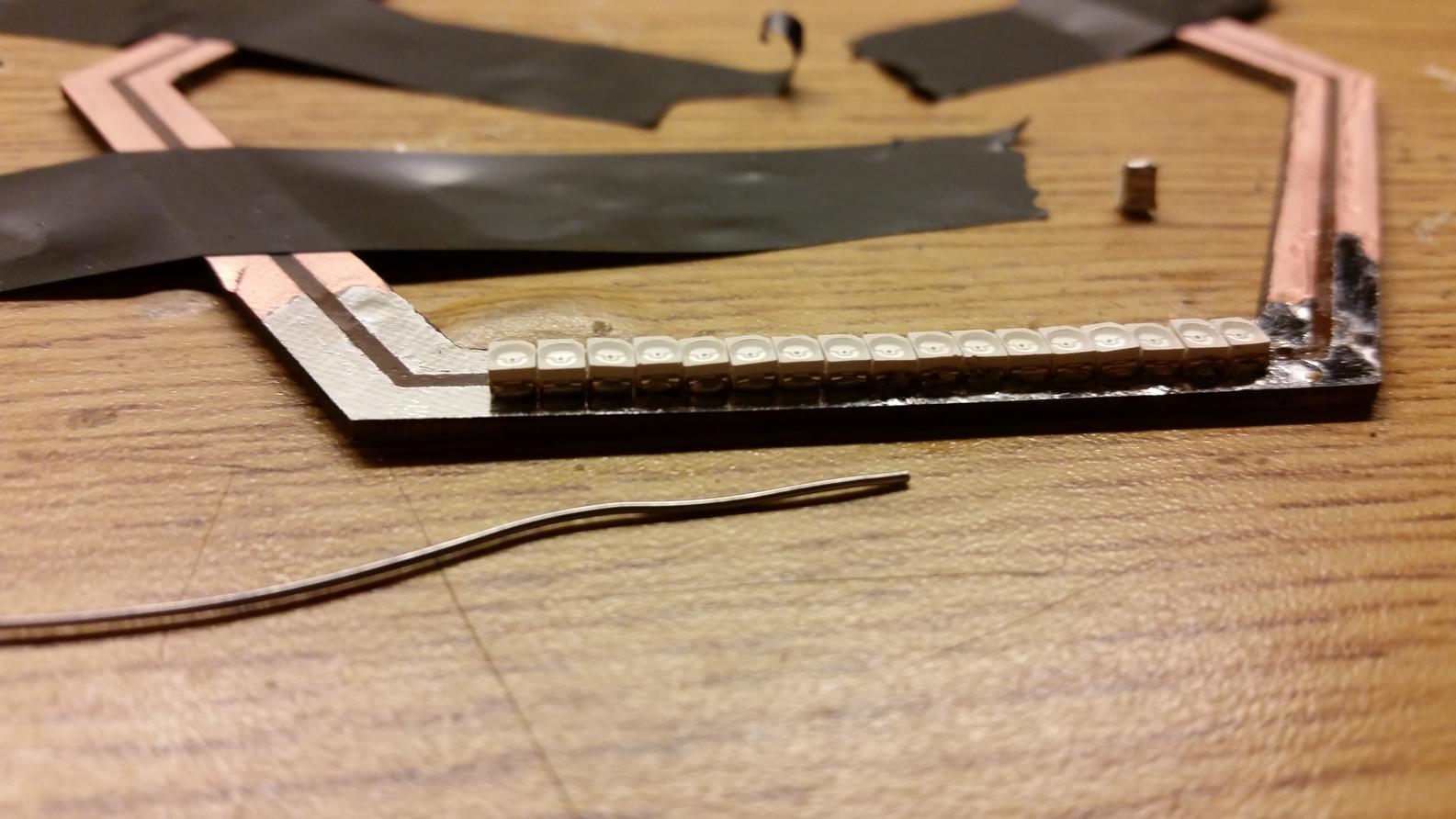

I hate how dim the amber halo rings are during the day, I actually made my own using 102 3528 leds on each one. but with all of those leds they only put out around 200 lumens and 4.5 watts. I want something bright enough to be used as a turn signal. I was considering just using white leds which are about 10 times brighter than the colored ones and using a filter on top of them to give me the color i want.
