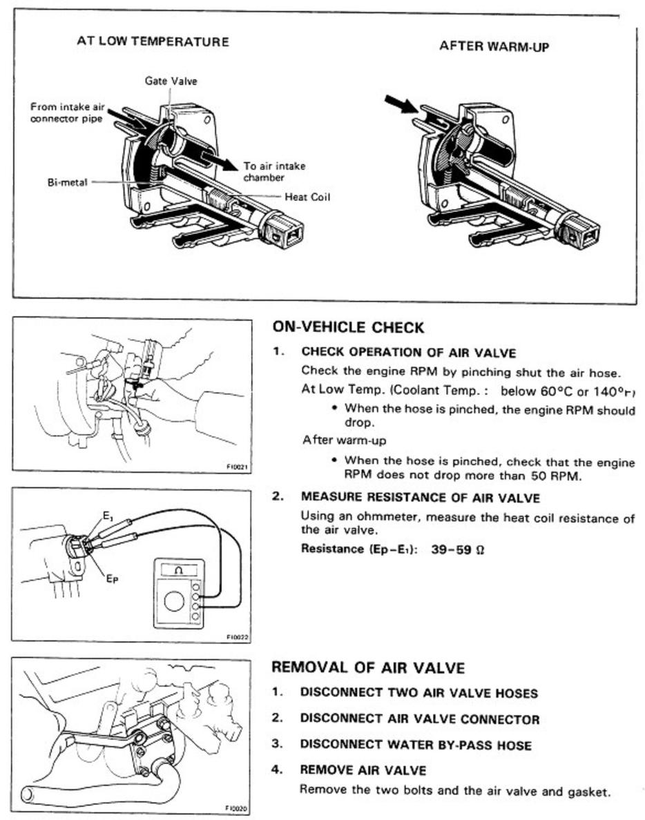

I'd check vacuum lines first. Make sure they are all correct and just go ahead and replace with new ones. Also Check the Idle Air Control Valve is working correctly. Cold Start Injector and Cold Start Thermo Switch are good things to verify all spec and working correctly. I'd do the plugs, cap, rotor, and wire.
Find the Toyota Service #10 by searching for Toyota Hard Start/Rough Idle on google. Image posted here is IACV check but yours might be different and located on the throttle body instead of where mine is.
