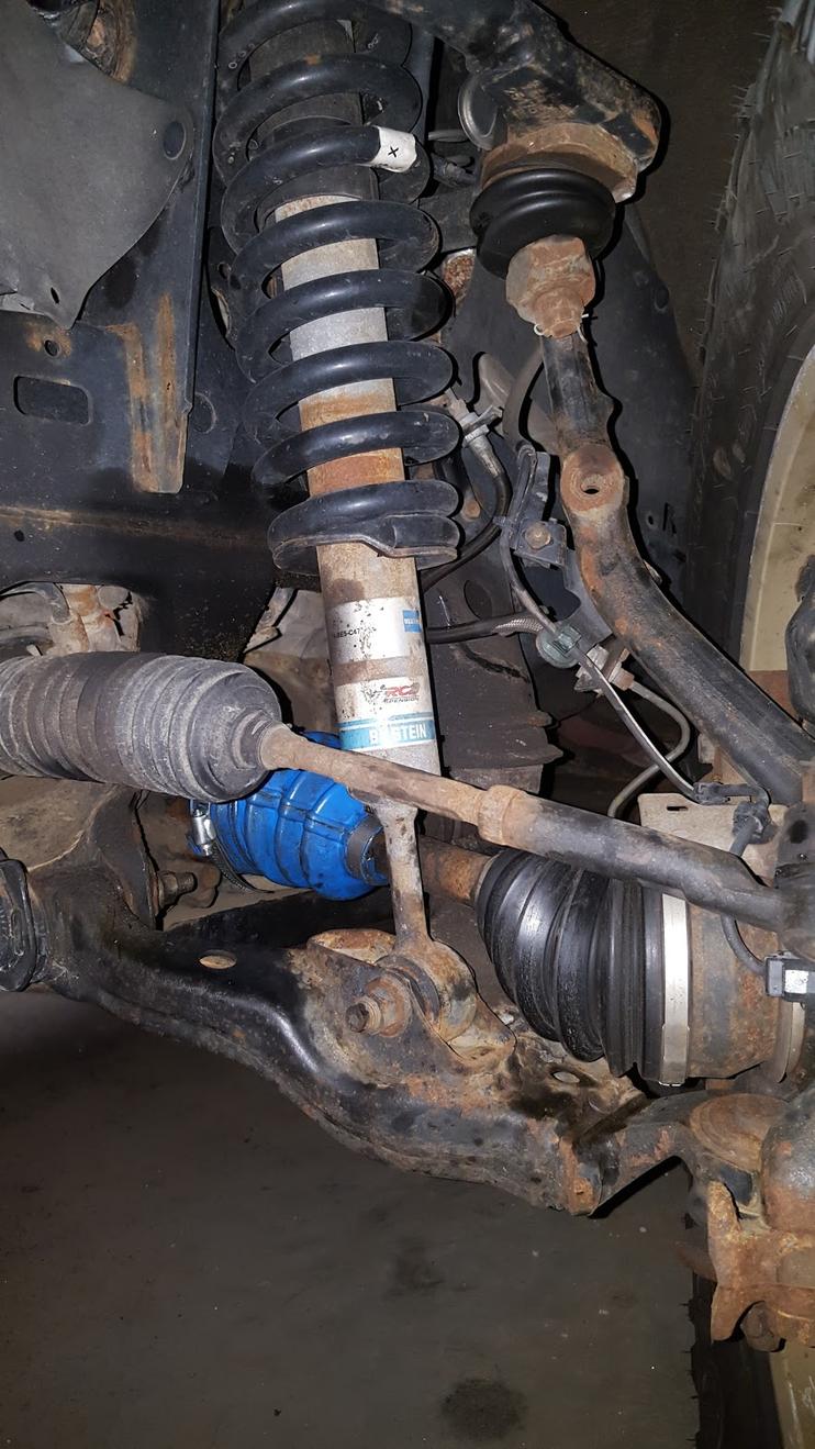

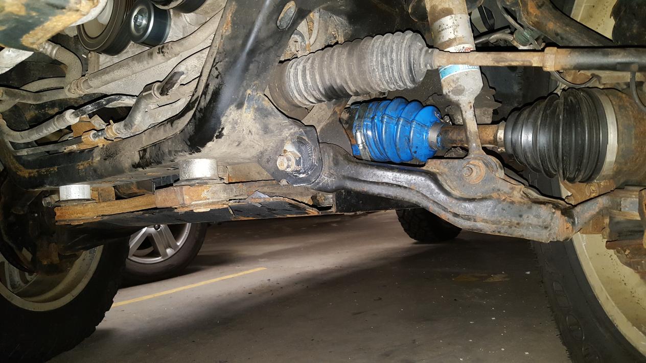

Truck is lifted 3-4 inches (OME 885 + Bilstein 5100 + Toytec top out spacer). Diff drop. LR UCAs. 34 inch wheel/tire setup. Here's an old photo of the angle of CV.

I don't think the CV angles are effected by tire size, just lift amount (coilover preload or spring geometry).
CVJ has different boot materials and maybe sizes too on their remanufactured CVs. Otherwise just look into a different boot clamp.

This makes absolutely no sense. The size of your tires have zero effect on the angle of the CV's.

Interesting you guys feel that tire size doesn't affect CV angle. I know suspension lift changes the angle, no questions there. However, wouldn't increased diameter of the wheel change the LCA angle, thereby changing the CV angle? Said another way, for the same amount of lift, a truck that's running 31" tires will have different CV angles than the same truck with the same suspension lift that's running 34" tires? Or am I smoking dope?

You're smoking dope. Its just geometry. The suspension lift can change the CV angle due to the length of the strut changing. This moves the LCA down, the CV axle bolts through the steering arm...which is bolted to the LCA, hence changing the angle. Tire size is outside of this and has no effect on the angles within the suspension. The CV axle goes through the center of the tire no matter what size the diameter is....so no change in angles.
And just hose clamp the boots and be done with them. I just re-did my drivers side CV last weekend.
