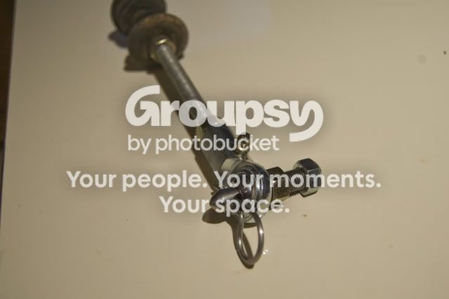

Here are the first disconnects we put together which were hard to put together. They were a spring loaded ball joint quick disconnect.

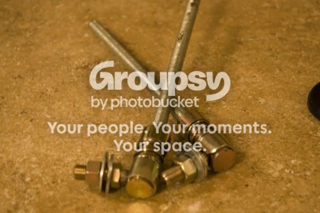

Here are the second ones that Im currently using on my 4runner.
DSC_2133.jpg~original
So far I have not heard any odd noises from them so far. and I put them through a few tests over some piled up rocks in the backyard and regular driving around town. They disconnect and connect pretty quick. My only real concern is not being able to get them totally out of the way. But I have run with them disconnected for a few weeks and never heard any impacts from any contact from them being disconnected.

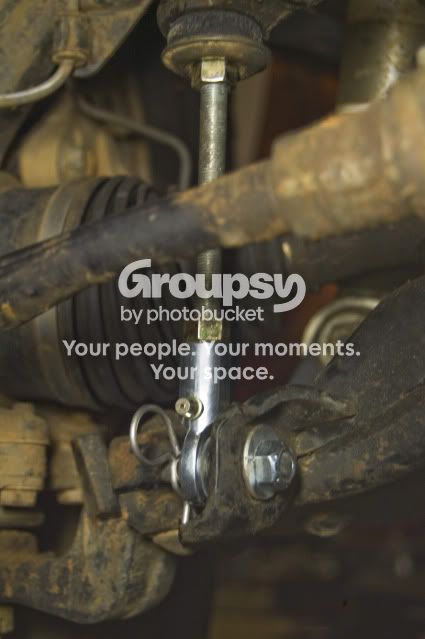

Here are the current versions on my car.

Those look pretty good. How are you securing the sway bar when it is disconnected? Are you zip tying it to something?
I might be interested in something like this. I know the front sway bar really limits the travel of the front end, but i am not quite comfortable driving around every day with out one.
I have been running the Wabfab disconnects for a couple years now. The bushings hold it in place just fine and there is no need to zip tie it up out of the way. Always good to see what other people come up with for their trucks.
Thanks man. Yeah they don't really move that much when they are unhooked. I left them unhooked for a few weeks and they stayed put.
The old quick disconnects were just too hard to get back together, and they started to make noises on my buddies Isuzu Trooper and developed some noticeable play on my vehicle. The new heim joint endlinks have been much better so far.

If you don't plan on strapping them up and out of the way, just keep an eye on them...if you get enough compression where the control arm jams your rod (haha right?) it'll bend...ask me how I found that out...
Haha yeah I'm surprised Ive never heard any contact when i ran them unhooked for a few weeks
And yeah its just a clevis stud, works pretty good. They def make a huge difference in the handling.
