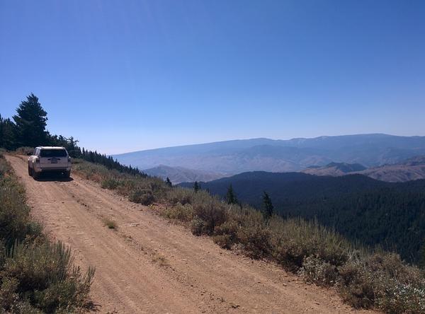

Back in August Dad, brother and I decided to check out a section of the WABDR. We went Ellensburg to Chelan just to get a taste for it.
Very cool trail, definitely get the range out scenery, from deep woods/green, to higher altitude (not quite alpine, but starts to look close), to almost desert like. We took it reasonably slow and spent just one night on the trail.
Whole trip was dusty as all get out thanks to the great summer we had in the PNW. Definitely worth it though. Looking to get the rest of the sections or hit it straight through another time.

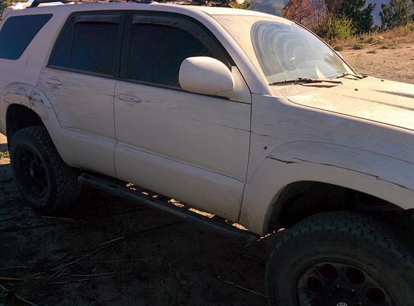

Spot his 5th gen?
Only sustained minor scuffs from tight sections of trail consisting of formerly burned branches. Almost all buffed out with no elbow grease. I'll get to the rest someday when the weather is nice again.

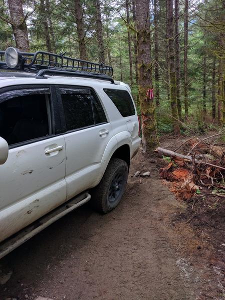

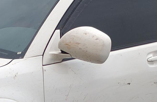

However; at one point things got a bit too narrow and slick and everything lined up well enough for me to make a mistake and slide into a tree:
The culprit...a tree leaning slightly into the trail...while the trail slopes slightly toward the tree. I definitely wasn't the first to have a run in with it.

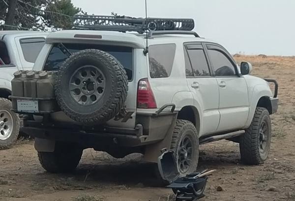

You could say the tree inspired my mirror disassembly/parts swap write-up here. Tree took out the mirror, put a small dent in the driver's door (hardly noticeable) and the nice dent in the rear panel. Also broke the tail light a bit.
Managed to get a homie-hookup to put a bit of work into the rear dent, it's not good as new but it's not as bad as it was and only cost me a 12-pack of beer.

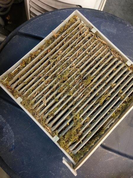

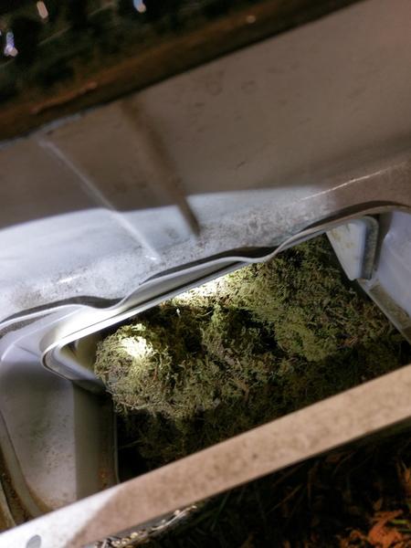

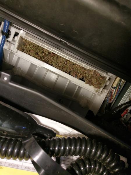

Figured it was time to finally replace the cabin air filter...I've had the rig for nearly two years, didn't know when it was done last.
Turns out 2 years was too long...I thought I had been smelling old dog hair caught in the cabin air filter all this time, but instead it was mouse haven:
Filter:
From the glove box, AFTER removing the filter:
Looking down into the intake..."where's the fan?!":

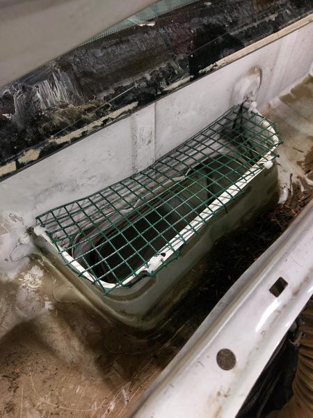

Installed the 'rodent be gone' mod:
After a new filter, and a dryer sheet laid on top of it, the 4Runner is smelling quite fresh.

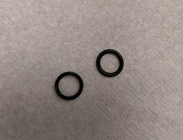

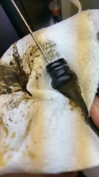

Next up, noticed an oil leak on the block around dipstick tube when I went up Surprise Lake a few weeks ago. Pulled the dipstick tube to replace the oring on it.
Old oring, looking a bit flattened/squared off on the tube:
Old(left) vs new(right), notice how much more plump the new one is:
Hard to tell but that old one was severely flattened and looked more like a circle gasket with squared/hard corner edges than an oring.
That fixed it, no more leak. It's just a single bolt to remove the dipstick tube as a whole, I'd recommend doing the oring replacement to anyone thinking about it. Takes zero mechanical knowledge other than what a wrench is.

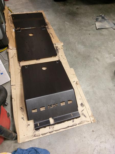

Next up, got in on the RCI group buy...
Went with brush on bbq paint, wasn't feeling like covering the entire garage in a layer of paint dust like I did when I sprayed the wheels n sliders. Seems to be alright, we'll see how it holds up against daily driving/flung pepples. I plan to touch up once in a while anyway after offroad trips, because rocks. Don't have photos of them mounted up yet after painting. They fit like a dream though. Couldn't be happier.
Unfortunately stripped one thread on the front. Then I compounded the problem buy trying to tap it. The very front 2 bolts appear to screw into some welded nuts inside the frame crossmember...I only say this because when I tried retapping the thread, thinking I'd go all the way through, something popped. Now I have a tap stuck in something freespinning within the crossmember, tap hanging down like a tiny cylindrical christmas onament. Without that front bolt the skids are all still tight underneath with no rattle so it'll hold for now until I can get in there. Definitely fixing before next real off road trip.

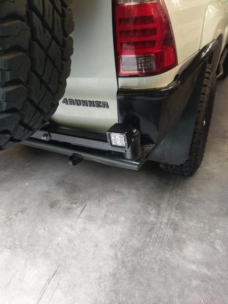

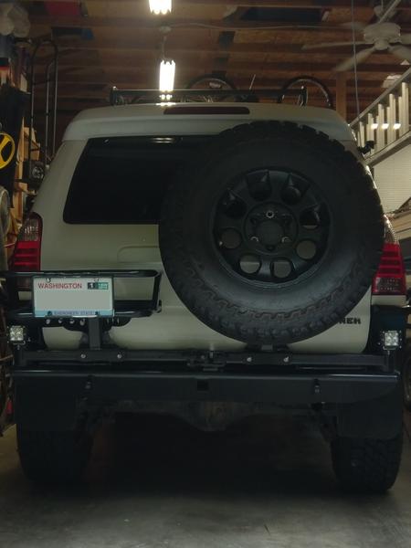

Added a 4x4Labs rear bumper with dual swingout for tire and 3 jerry can holder.
Installed some Dobinson C59-701V rear springs.
Installed some Rigid Dually Floods for extra reverse lights (haven't wired yet, waiting on switches ordered).
Installed the secondary air injection pump bypass kit by [MENTION=8828]slyfox75[/MENTION] (was the second easiest thing I've done, close behind the anytime fog light mod).
Installed a CB (Cobra 75WXST) with Firestick and hatch mount.

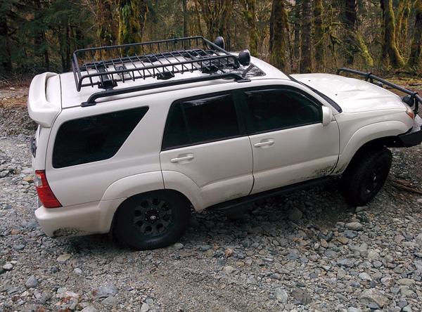

Ordered a new roof rack to replace everything up top (installation coming soon).
Got in a bit of snow, a bit of the WABDR with the dad (5th gen) and brother (Tacoma), and some other miscellaneous things. Here's some photos:
Zoomed in shot of the 4x4Labs Rear in all its glory:
Rigid Auxiliary Reverse Lights

Got the rack installed, never did get pictures. I'll see if I can upload some later.
