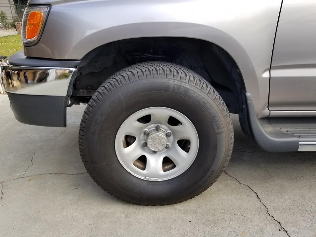

I was under the impression that the stock 15" steel wheels would clear the 231 calipers, thus avoiding the clearance problems. If one of the stock wheels could be nominated as a new spare (assuming it fits in the spare cavity), I would have a new steel spare that would fit in any corner.
Wheel fitment with Tundra Brakes - YotaTech Forums
The stock steel wheels that came mounted on my 2002 4Runner will clear the 231mm Tundra calipers, but my stock spare steel wheel (black one) doesn't fit over the calipers.
Have you heard otherwise?
Of course, one downside to this approach is that it would be more difficult to sell the remaining three steel wheels if I poached one to be my new spare.
I'm liking the 199 option more now.
Scott
Scott
I'm pretty sure they are talking about a stock 16" steelie. I can't think of a 15" wheel that would fit, but I don't know everything (or anything, whatever, heh).
Out of curiosity I did a quick google and found this site (the blurb about 4Runners only coming with 16s...no, but...):
Which Wheels/Rims Fit the Tundra Brake Upgrade (13WL 231mm rotors) on a Tacoma? (or 3rd gen 4Runner) – ADVENTURETACO
it has, pretty far down the page, has an interesting template to help one determine if the 231 is even a possibility with their rim.
Thanks for sharing that. At least for 2001, I thought the only steel option was the 15" wheels on the SR5 base model. I wasn't aware of a 16" steel wheel option.
According to this brochure, the SR5 standard package included "P225/75R15 tires on 6-spoke 15” styled steel wheels"
https://www.top4runners.com/runhist/3rdgen/2001_4runner.pdf
Here's a picture of my wheels. The previous owner installed installed a set of 31x10.50R15s.
Maybe I'll have to try the template method to be sure.
Thanks,
Scott
