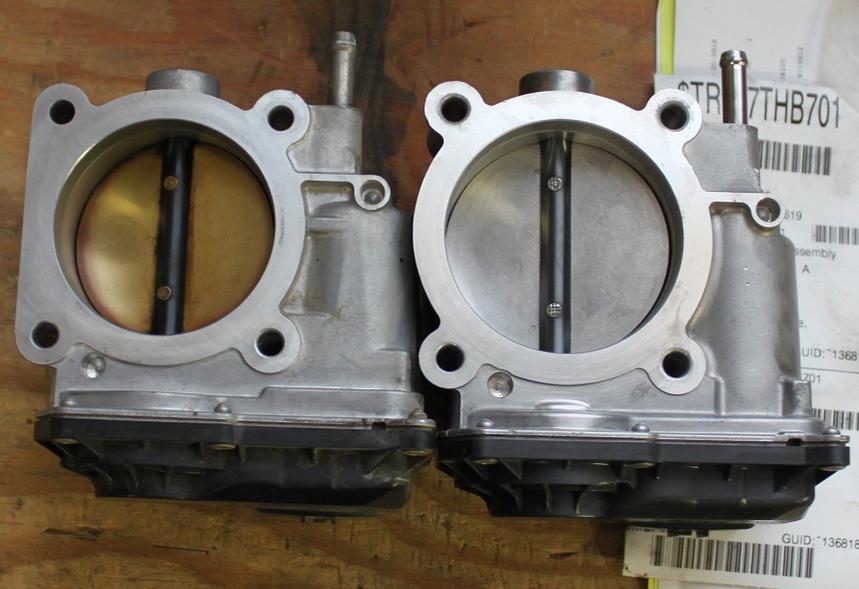

Throttle body.
4th gen V-6 has a 65mm(63mm actual)
At some point they got a 70mm(68mm actual) URD has an adapter for it.
The V-8 has 76mm.
The V-6 intake manifold is 68mm.
The K&N tube(series 63) is 68mm.

Here is the 65mm next to the 70mm.

Throttle body.
The V-8 has 76mm.
