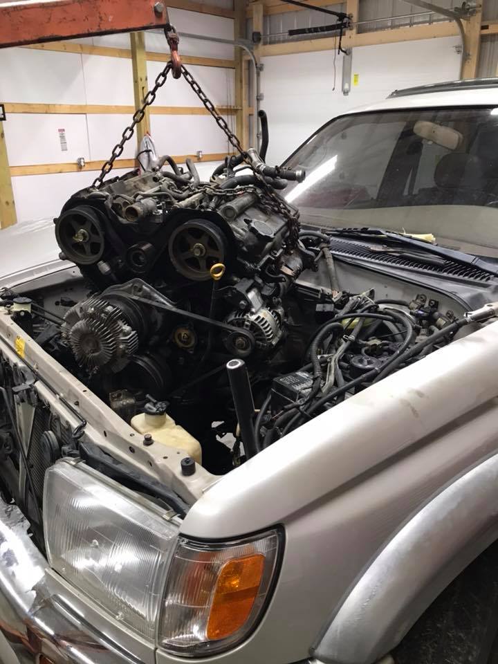

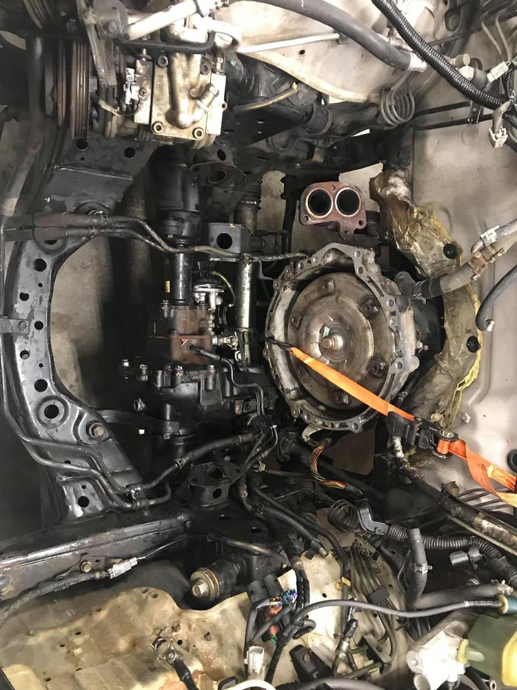

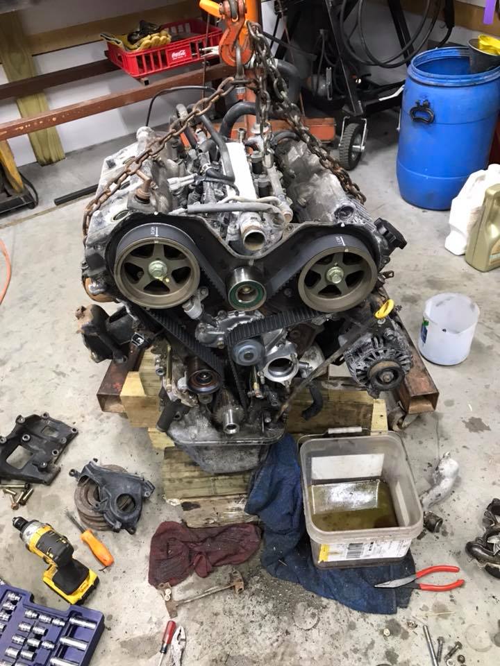

Got it home, drove it around a bit with the broke piston just to make sure that everything else worked and then started pulling the engine with the help of a couple good friends.

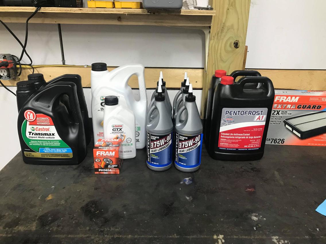

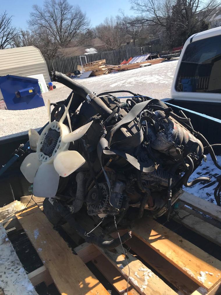

Got that done and decided to drain all the fluids and clean out the trans pan while I was waiting for the brand newish (117k) engine to arrive.

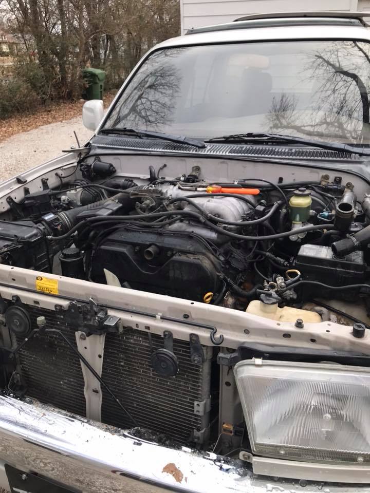

Threw a new OEM timing belt and water pump on the new engine and dropped it in last Friday night. Got it done at about 2 am. As excited as I was to fire it up I waited till the morning, flushed the cooling system, got a new battery and fired it up. It started perfectly and is running great.

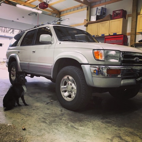

Here's Penny with the runner put back together.

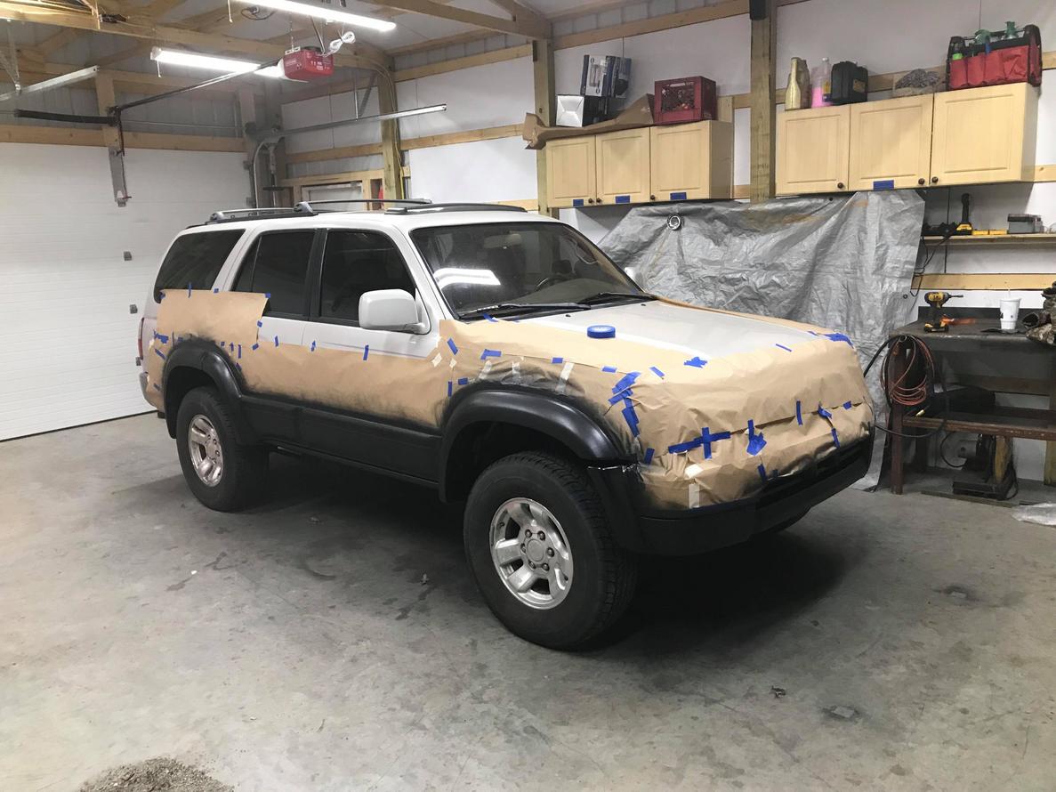

I really liked the silver flares and molding but mine were faded and scratched so I decided to go ahead and spray them black. I scuffed them with scotchbrite and used the duplicolor bedliner as I have had good luck with it in the past. I think it is going to look pretty good.
nice! cant wait to see more. I'm also debating on doing my flares, so I'm curious to see what your finished product looks like.
Man, I would have scrubbed that engine bay clean with the engine out! Good luck with her. Lets see pics of the fenders without the brown paper.

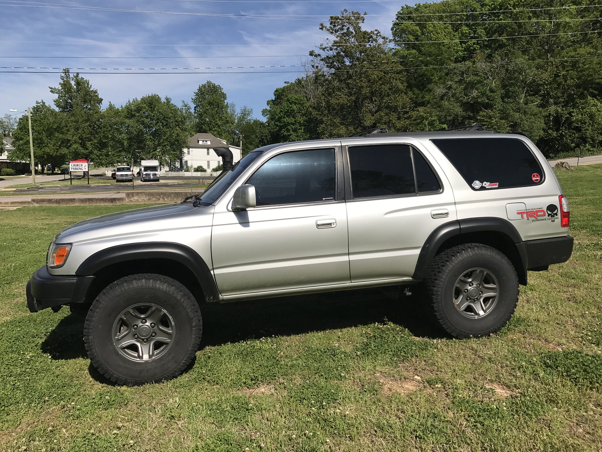

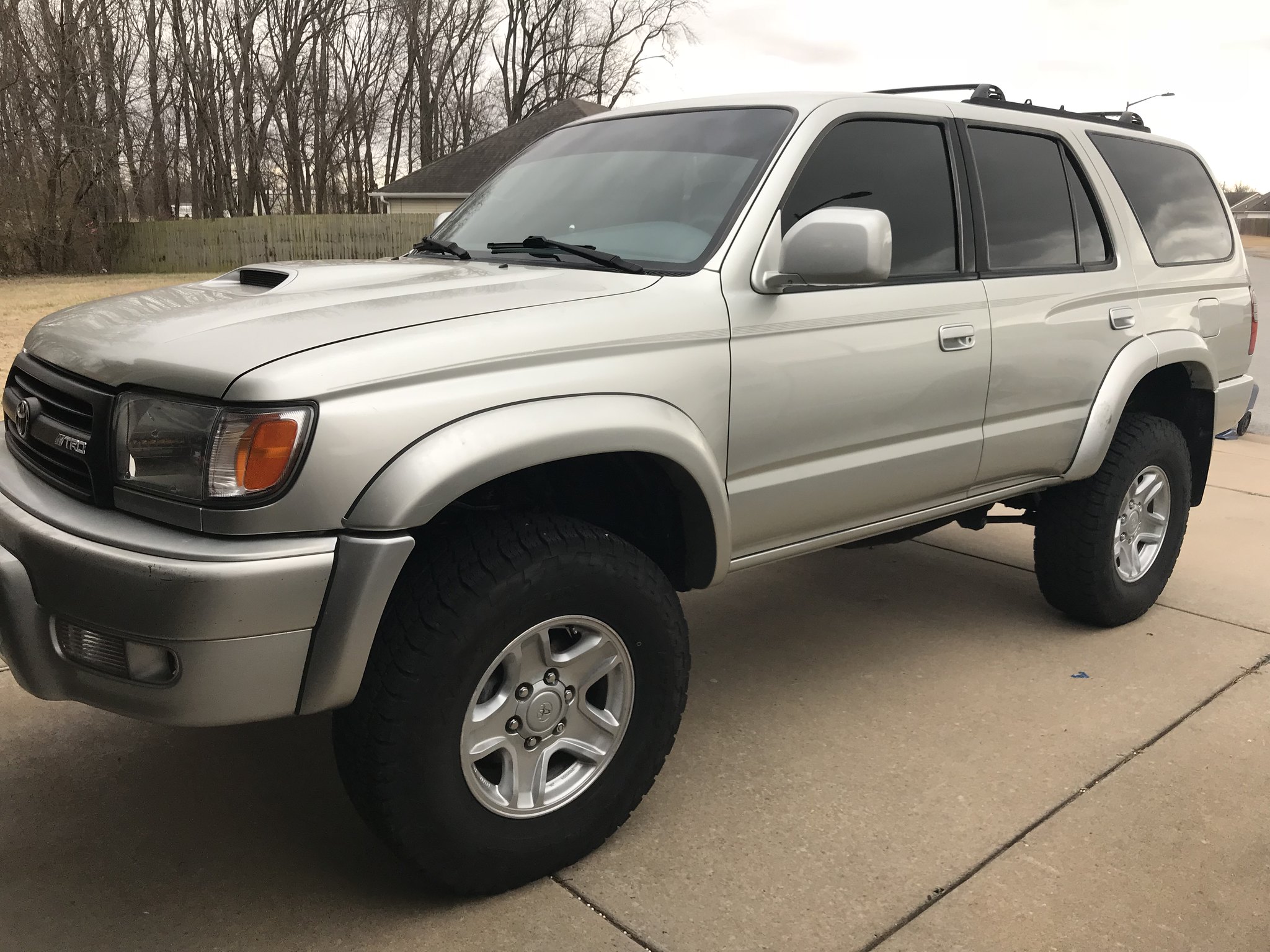

Im from Siloam Springs and have a few buddies who drive runners as well. Here is a picture of my last one that I sold then kicked myself for doing that and had to get another
IMG_7367 by Dustin Keeler, on Flickr
Here is the new to me one I just got
Before lift
IMG_9838 by Dustin Keeler, on Flickr
After the lift and Alignment
IMG_9979 by Dustin Keeler, on Flickr
We go wheeling from time to time and would love to have you join us.
