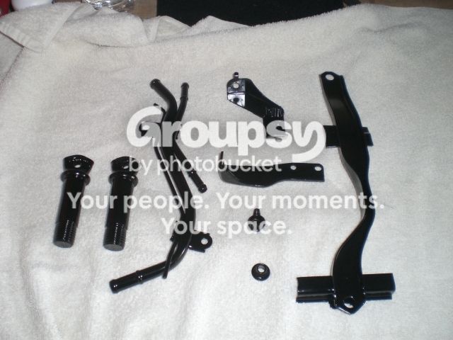

3. I found a set of used Sonoran steel shackle hangers, I sand blasted and powder coated them and the shackle screw pin Gloss Black.

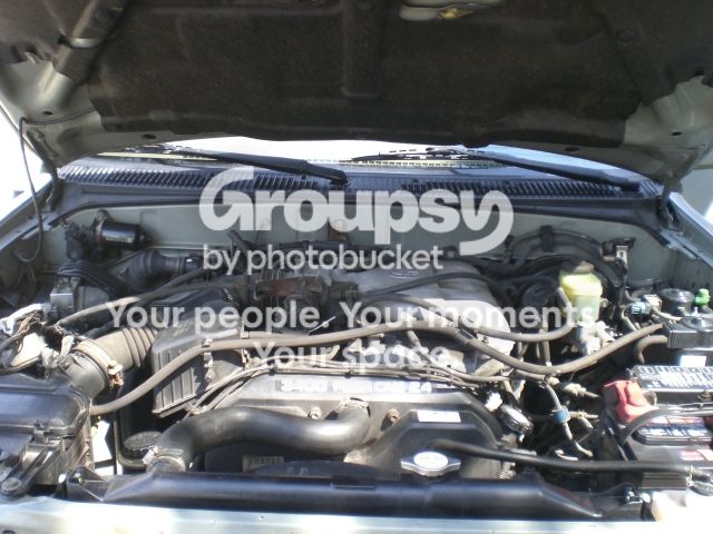

4. The Engine bay was bother me as some brackets are starting to rust or oxidize so to the blasting box parts are starting to go. I started replacing some rusting bolts with shining new ones.

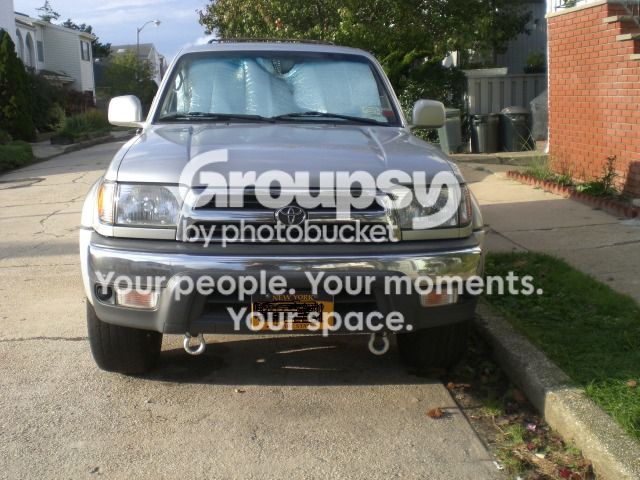

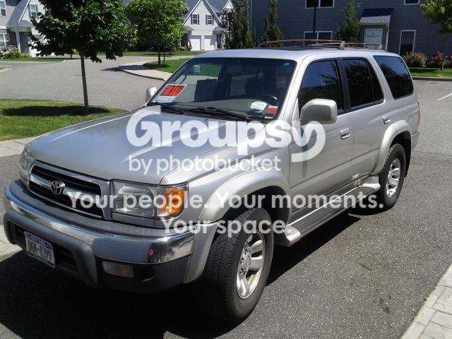

The Day I brought her home
IMG_20120627_142236.jpg~original

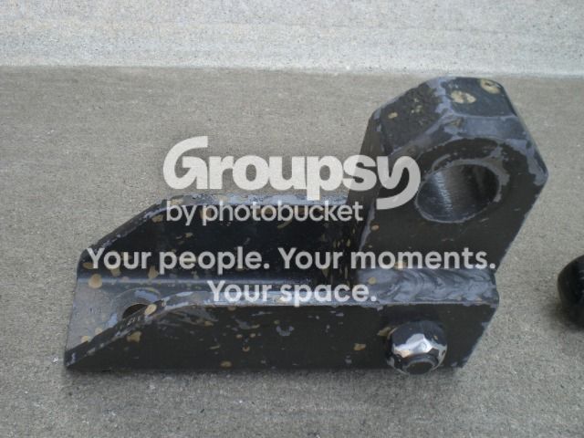

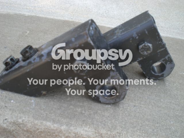

Look what came in the mail some used Sonoran steel shackle hangers
CIMG1802.jpg~original

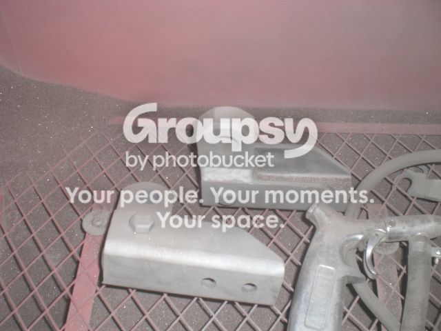

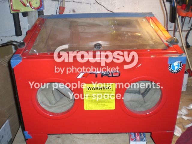

A little rough, nothing sand blasting can't take care of
CIMG1803.jpg~original

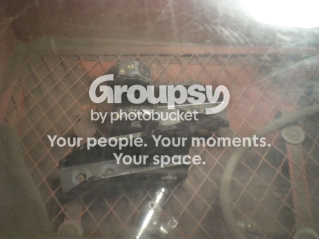

In the box they go
Blastingcabanet.jpg~original
CIMG1815.jpg~original
All cleaned up
CIMG1816.jpg~original

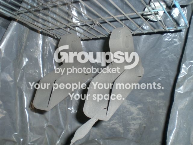

Eastwood is a great place
CIMG1817.jpg~original

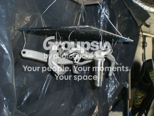

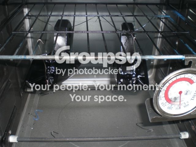

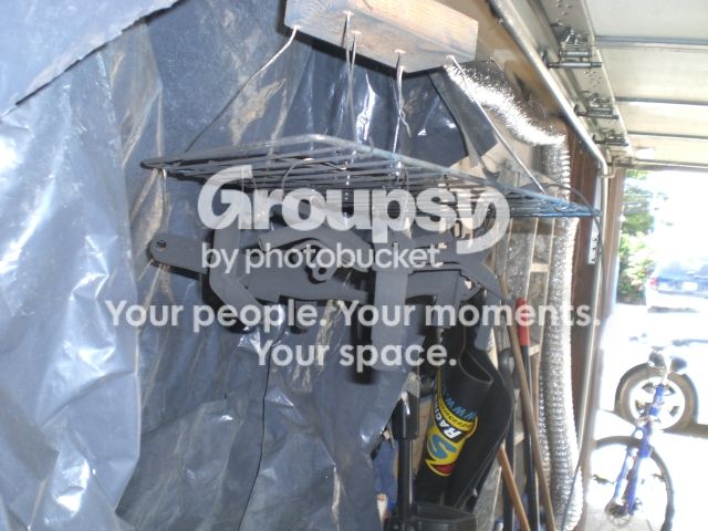

powdered
CIMG1824.jpg~original

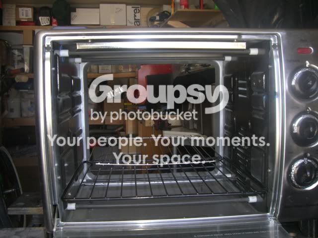

Done baking in my toaster

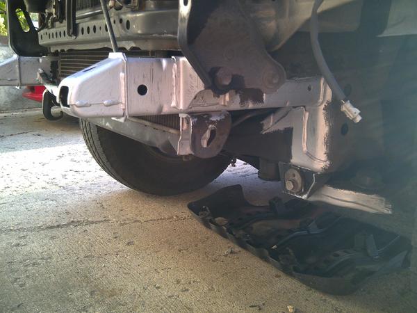

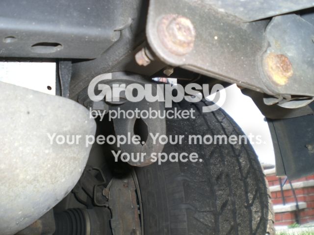

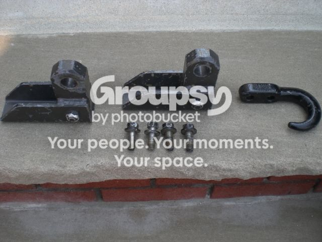

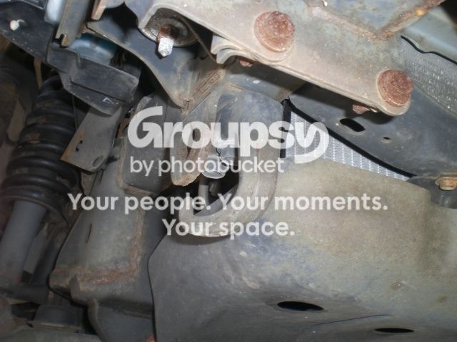

Time to remove the old hooks
Towhooktoremove.jpg~original
Towbrackettoremove.jpg~original

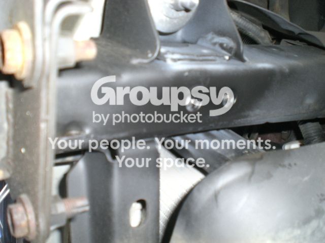

Funny surface rust, never happends on Long Island. A wire wheel with primer and black paint, fixed it right up
CIMG1882.jpg~original
CIMG1881.jpg~original

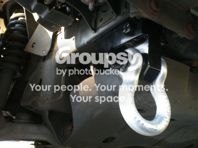

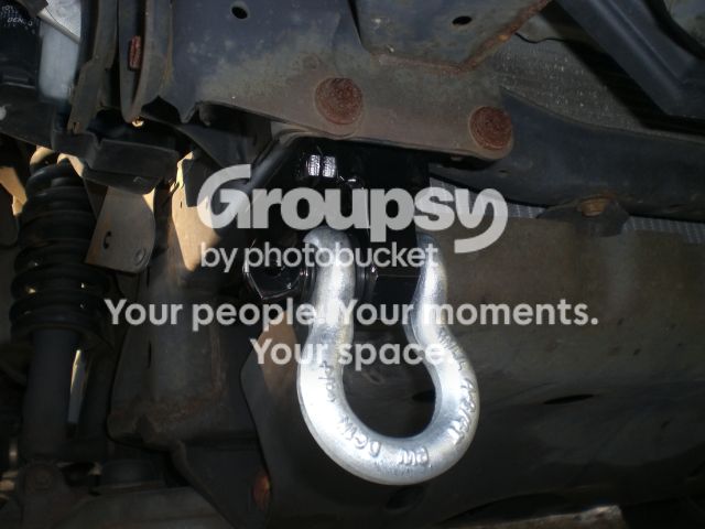

All done, before and after
sonoransteelshacklehangers.jpg~original
CIMG1879.jpg~original
CIMG1878.jpg~original
cimg18992.jpg~original

Thanks, I got the 4runner for a fair price, best of all it was a 1 owner car with all maintance done at the same shop. Guy just had enough when the cat went missing at the Local BJ's (guess they saw him comming).

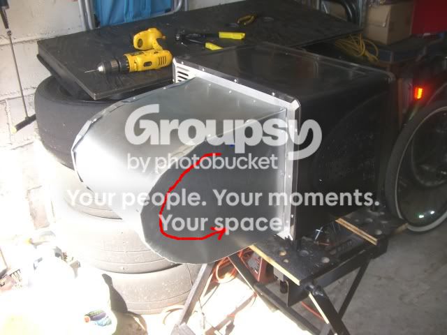

If you liked the front of my toaster take a look at the mods I did to it so I could fit valve covers and track bars etc.
CIMG9094.jpg~original
Curved for better convection when baking
CIMG9103-1.jpg~original

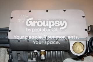

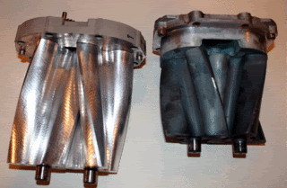

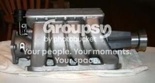

Stock TRD M45 Supercharger converted to fit M65 blades
30M-62TRDsupercharger.jpg~original
30M-62TRDsuperchargertoppic.jpg~original
TRD65rotors.gif~original

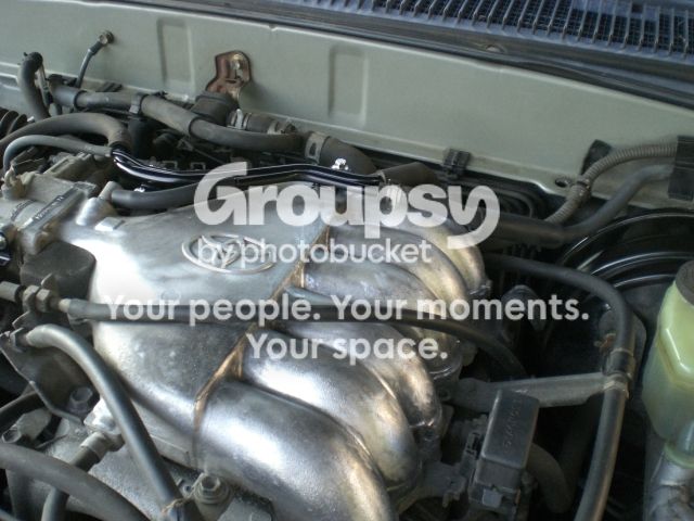

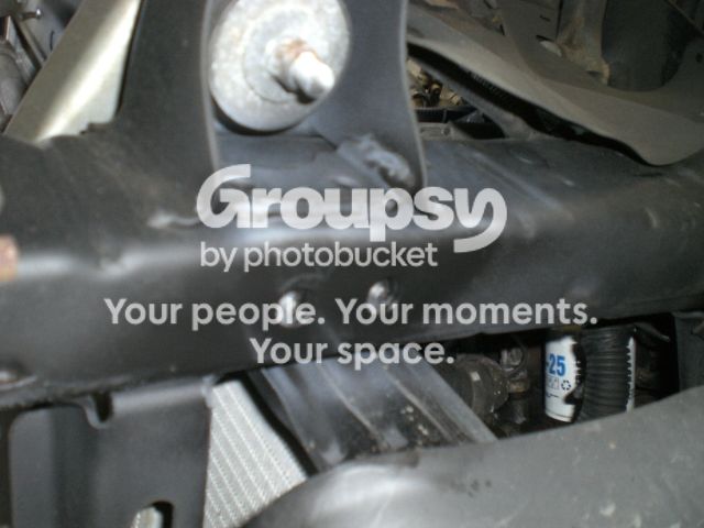

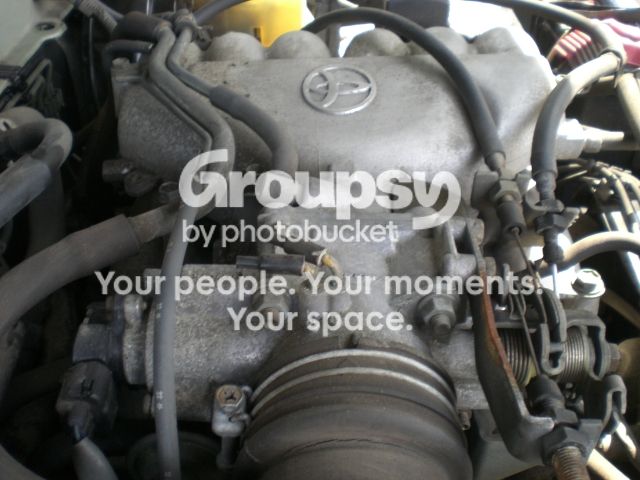

The Engine bay was bother me as some brackets are starting to rust or oxidize badly so to the blasting box these parts are starting to go. I started replacing some rusting bolts with shining new ones.
Before.jpg~original
CIMG1853.jpg~original

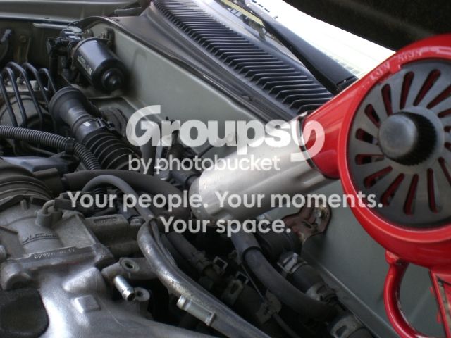

Got out the old old heat gun to soften up the vac hoses
CIMG1858.jpg~original

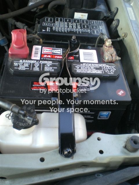

Cruise control, Battrey hold down brackets, etc., blasted and ready for powder
CIMG1864.jpg~original
Ready for the toaster
CIMG1869.jpg~original
Nice and black again
CIMG1873.jpg~original
Better then new.
Batbracket.jpg~original

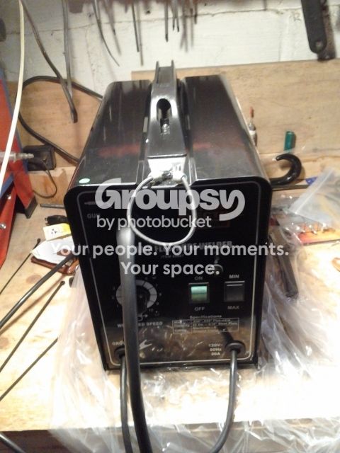

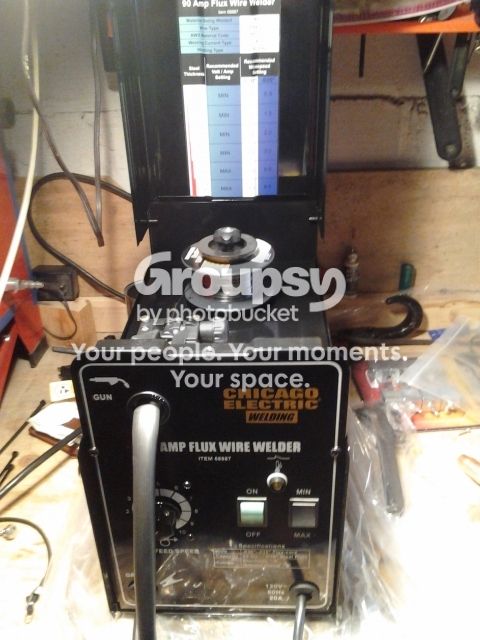

So I used the Labor day sales to convince my wife that I needed a welder. I figure its never to late to learn a new skill. So Harbor Freight I went and picked up the 90amp Flux Wire Welder to experment with and if I do get better I'll up grade, for now its play time.
New in box
IMG_20120903_162310.jpg~original
Handle screwed on, just treaded the welding wire.
IMG_20120903_165851.jpg~original
Already, time to make some ulgy welds.
IMG_20120903_165951.jpg~original
Wow!
