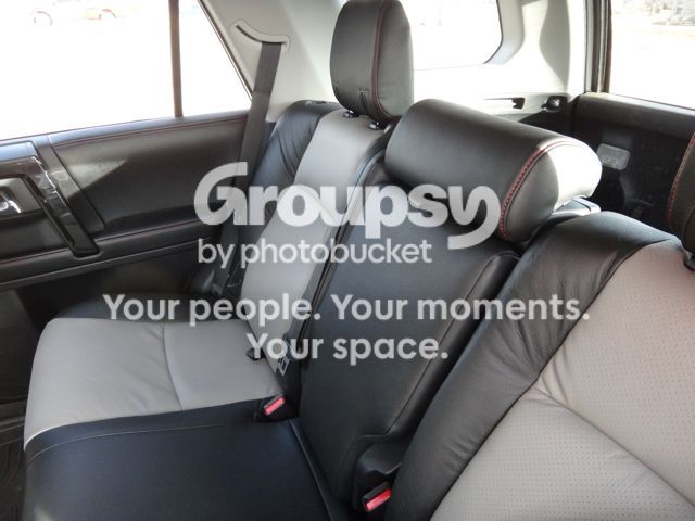

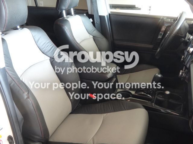

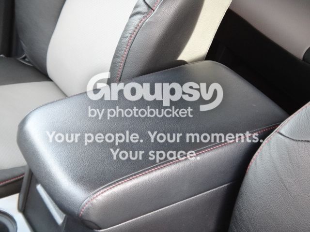

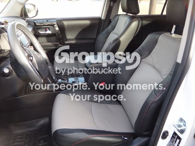

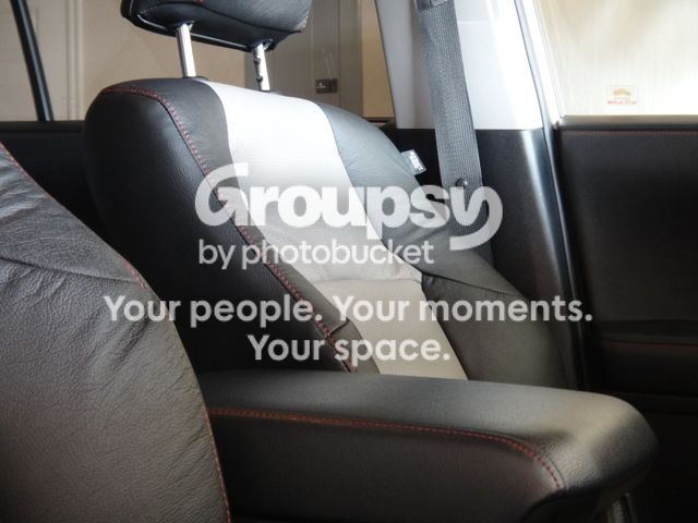

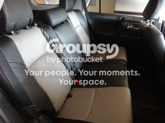

So, here's the requisite pics:
DSC00016_zpsmu5uai1i.jpg~original
DSC00012_zpss45p04wv.jpg~original
DSC00011_zpszdq0fpz6.jpg~original
DSC00005_zpsym7ufwg1.jpg~original
DSC00004_zpsoy4kah2v.jpg~original
DSC00002_zpsdj5gygla.jpg~original
My Trail (OEM cloth seats) had the black softex trim bits and pieces (console, door panels) with red contrast stitching. I wanted to match that and I'm happy with the results.
For those that are interested, here's the custom configuration I went with:
Black wrap
Smoke perforated "body"
Contrast red stitching
I think it looks "factory" and not too gimmicky or conspicuous.
I also installed some seat heaters (buttons/dials in the factory switch blanks in the console).
The install was straightforward enough but it was the most tedious, time consuming, and tiresome mod to date. It took about 14-15 hours of pure work time (stretched out over a weekend due to other priorities - like family!).
You remove all the seats from the vehicle (unplug wires, etc), completely disassemble all seats (bolts, seat belts, plastic trim) cut hog rings, etc.
Then you use your hand strength to carefully pull, stretch, clip, and manipulate the new leather. Install new hog rings as you go. The seat heaters were pretty straightforward as well. Just more time.
Again, it was pretty 'simple', but time-consuming and tiresome. More so than the Toytec lift, homemade roof rack, etc.
But I'm super happy with the results and am glad I did it.

Thanks for all the compliments and the criticisms. I can take it!
Those pics were taken immediately after I bolted everything back in, so I'm sure there will be some changes to the wrinkles and dimples as it gets lived in (and things warm up around here). I can probably manipulate the bolsters and foam a bit to smooth out some. I haven't even tried the heat gun approach yet.
To be honest, for me - which is who it matters to (haha) - it's perfectly acceptable. I support paying professionals to do professional work, but that also assumes the professional you hire will produce acceptable results. That's not always the case. And once the job is done, it's done. I wouldn't want a professional I was b!thcing at tearing apart my interior again. It all depends on the professional I suppose. I'll bet I was more careful with plastic trim pieces, and plastic clips and all than a hired professional would be (because its MY car). So, again, if you can find the right professional you trust and have the coin to pay him, that's great too.
I have some personal pride in doing the job myself and have added another ability (debatable I suppose) to my skill sets. I love the look on people's faces when they ask who put them in and I say "me".
