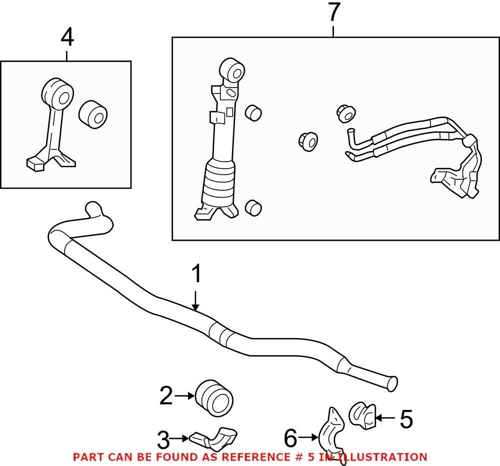

For those of you who have replaced your KDSS swaybar bushings up front, can you confirm if its Part# 4881535140?
I'm not finding anything on the various Toyota parts dealer sites that specifies KDSS bushing. Maybe the same bushing is used for the standard, non-KDSS sway bar?
Thanks in advance.
For my 2013, I replaced the front KDSS swaybar bushings with 4884960041. It's #5 in the attached photo

All the better for the next person in need who finds this thread. #5 is the same one I need to replace.
I read a few other threads on here about doing the swap. Nothing definitive on best approach. Looks like you basically just move forward as if you're installing a lift in terms of how you ratchet strap the KDSS piston, etc.
Any tips based on your experience?
I just ratchet strapped the swaybar in place. It was a pain trying to get the bolts to realign but just play with the tension and adjust the swaybar up/down as needed. Probably would help to be on level ground as I wasn’t…best of luck
