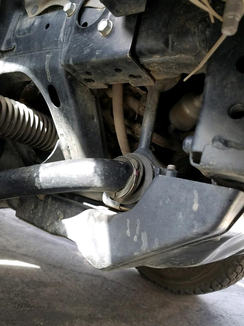

Only about 3/16" difference in my garage. One of the sway bar bushings looks a little beat up, but doesn't look like it would cause this issue. I think I may need to go to the dealership to get their opinion :rofl:
