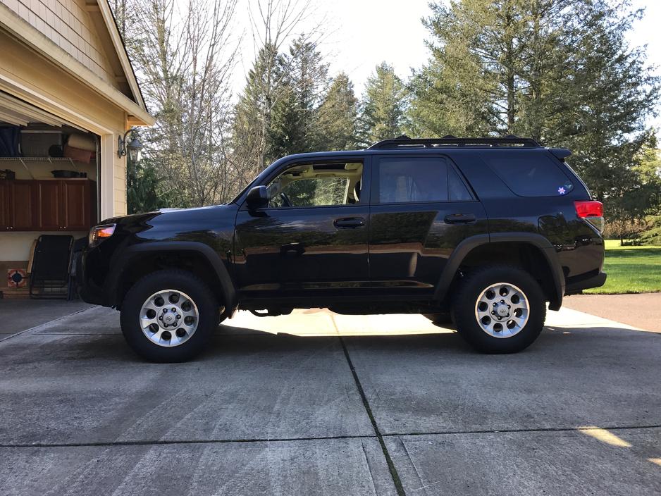

here is pic right after install but don't have a current pic after settling. I got an initial 2" up front (clip set at 1.75") and 1 3/8" in the rear with the T13 springs. seems to have settled at 1.75" up front and 1 1/8 in the rear (w/ 80lbs of stuff).

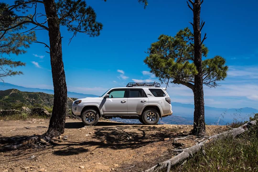

Here is mine with that exact setup. 1.75 in the front, T13's in the back.

Yes for me. Stock front springs.
