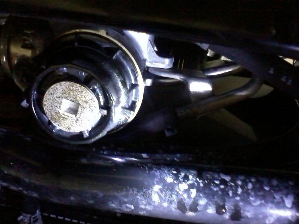

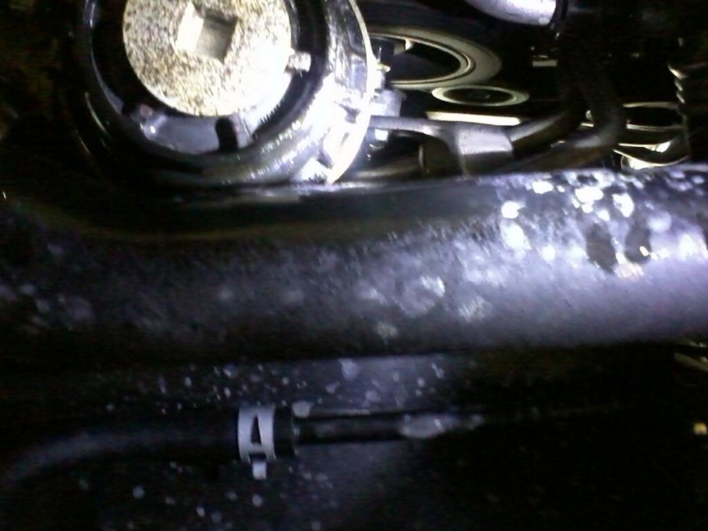

So here's a strange situation. Brought my truck to Toyota Dealer today to get the 10k service. They're unable to change the oil filter without removing the sway bar because it's in the way.
They're telling me it's an aftermarket sway bar, which I confirmed with the selling dealer is not the case. Our guess is they just haven't seen a KDSS sway bar before. However, the current dealer swears it's not the sway bar that comes with the KDSS system from the factory.
I do have a 3" OME lift on the front. Even though I did not replace the sway bar as part of that lift, would the lift cause the sway bar by the oil filter to shift position enough to block it?
Here are some photos. Any input would be great!

Huh? Talk about unintended consequences....
Were those photos taken with the wheels offf the ground? Any difference with the wheels on ground?
Can you provide some more shots of the bar ends for context to confirm it is stock?

That was wheels off the ground. There's a toyota part number on the thing, so I assume that means it's stock!

Was the sway bar moved during the lift? If so that is probably the problem. ICON lifts don't require KDSS sway bars to be moved.
I had the same problem when I was running the extended travel Fox Coil Overs on my truck. I figured it was due to the extra travel pushing the sway bar out where it shouldn't be???
Solution - Have them lower the truck down on the lift and put enough weight on the tires until the sway bar moves back to where it should be. I sat there and watched my dealer do it, it took maybe an inch of compression to get the sway bar where it needed to be.
That absolutely amazes me that they wouldn't think to see if it was possible to do the oil change with the truck on the ground, amazes me more that they were arguing with you about the KDSS Sway bar not being the stock one.... Dealerships are a pain!!!:moon:
I would be concerned that the swaybar could hit that plastic housing...it wouldnt take much to crack it. The sway bar looks dangerously close, especially because it moves.

From what I recall the filter housing is not plastic it is metal. The concern about the sway bar hitting it might be valid. I can't tell if it looks like it would be an interference "fit" from the photo.
