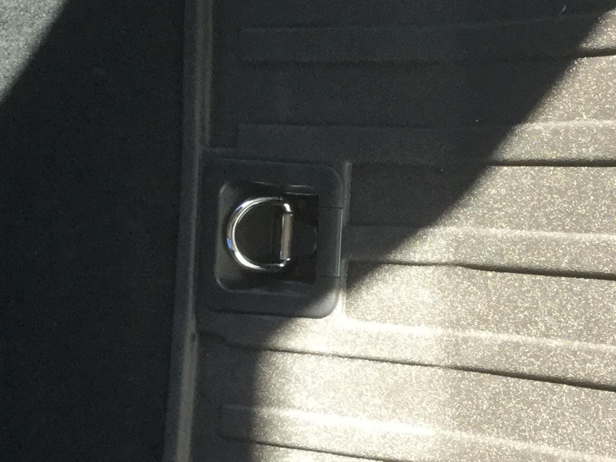

I removed the front tie downs (pop the cover up with a screwdriver exposes the 10 mm bolt) and then positioned the liner cutouts over the square hole and then pinned it with the tie down assembly. I found the 10mm bolts a bit short so Toyota gave me a couple 1/2” longer. I spaced the bottom of the tie down assembly with 3-4 small washers so the whole thing looking level. Sounds complicated but it really isn’t. https://www.toyota-4runner.org/attachment.php?attachmentid=356702&stc=1&d=1584415201
