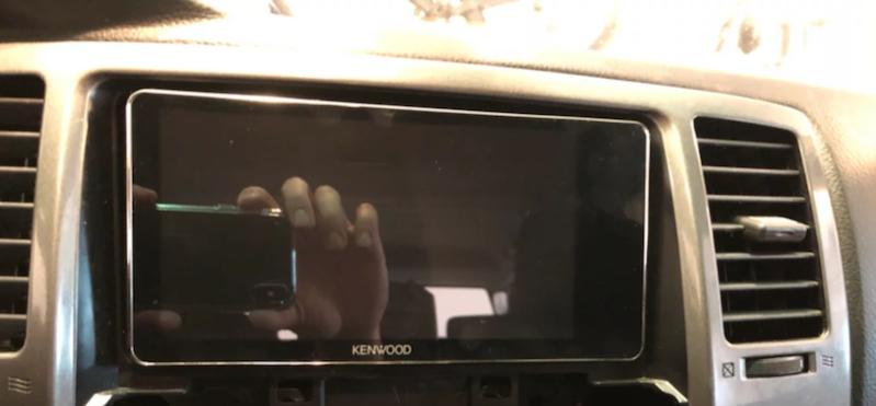

Hey all, This post might cause more questions than bear answers, due to the lack of info I found when searching the forum. At the very least this might expose this product more, for people to enjoy.
I found this product on [MENTION=3312]tv4184[/MENTION] 4thgen's build thread, and when I searched I didn't notice anyone else having this. (TiVo, I bet you can help answer my questions, but I didn't want to clutter your build thread and I wanted this to be a resource for others) (also [MENTION=93434]gshadow325[/MENTION] , after seeing your build thread and posts, your expertise might be helpful)
What is it?
From my understanding its a Kenwood HU that is sold in australia. It's top two features that peaked my interest are the Apple CarPlay/Android Auto compatibility and the fact that the touch screen is capacitive (this is similar to our smartphones as opposed to other head units being resistive). This head unit is made specifically for Toyotas (and partnering japanese automakers?). It also has an assortment of other great features.
Given it's not from the states and it's fairly new, info on installing it on our US oriented cars is scarce, even though it's been done.
I referenced this page on an 86/BRZ/FRS forum to find more info. They spoke about needing different adapters, and I'm not sure what would be necessary for our 4runners vs their cars.
Now for the questions:
- What adapters will be needed to properly install this beauty?
- Will it still be able to play standard FM/AM radio? (I don't think it supports Sirus/XM Satellite) - Yes, the antenna will plug in
- Is there a way to utilize the steering wheel controls?
- Does this work with the JBL systems in our 4Runners? - Ideally should, still needs to be tested
- Can this make use of the OEM factory back-up camera? - Ideally should, not tested yet
- connecting devices via a USB cord - is this on the unit itself? or does it need to be ran behind the trim and let out somewhere else? - The USB cords are extensions out the back of the unit, that end in a female connection
Photo taken from TiVo's Build Thread

USB plugs are just extension cords that can be run anywhere from the back of the unit and ends in a female outputs I just have it hanging outside next to my driver side console.
The plugs that come from the harness is a direct plug for the head unit harness. From what I remember he JBL system in my 3rd gen uses the same plush at the amp (not directly at the back of the head unit). Mine didn’t have the JBL so I can’t attest if the 4th gen uses the same setup as the 3rd. I was able to plug the antenna in fine too.
Everything plugs in except the steering adaptor. I’m afraid I might just have to get a PAC adaptor or another aftermarket one to get the steering adaptor to work. I’ll grab more pictures later if needed. I got my unit from 12 volt usa on eBay. Less than a week shipped from Malaysia. This unit is available both in Asia and Australia. They have less expensive versions without the CarPlay feature too.
I don’t have the oem backup camera but I do intend on installing it. It also has a harness for the Kenwood forward dash cam too.
USB plugs are just extension cords that can be run anywhere from the back of the unit and ends in a female outputs....
....I was able to plug the antenna in fine too....
....Everything plugs in except the steering adaptor.....
...I don’t have the oem backup camera but I do intend on installing it...
