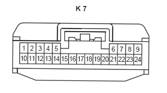

Ok, so obviously the DNX8120 is going to replace your NAV and Bluetooth, so you won't have to worry about those. You could probably even install the mic in the factory location. For backup camera, there should be a connector on the back of the factory unit that looks like the file I attached...
Pins 21-24 are the camera wires...
21 - White - Camera Ground
22 - Red - Video +
23 - grey - Video -
24 - Black - Camera 12V+
I think pin 5 is reverse trigger so you'll connect that to the Kenwood purple/white wire. It's been a while since I did this one, so just make sure you test before you connect anything!
As far as rear seat entertainment, I'm not sure. You should be able to do that as well but I don't have access to Alldatapro at the moment so I can't verify.
