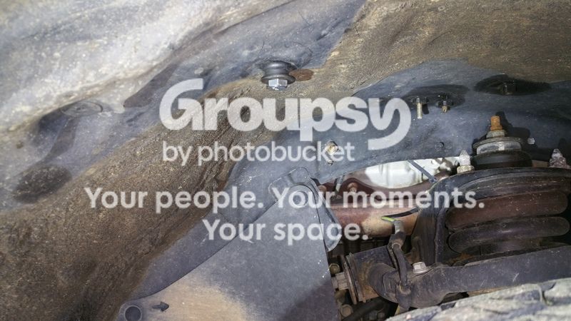

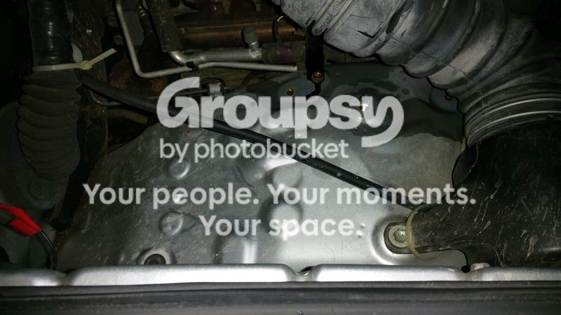

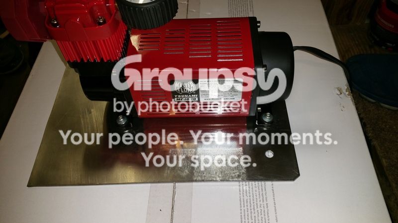

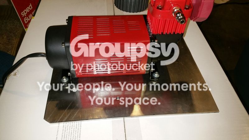

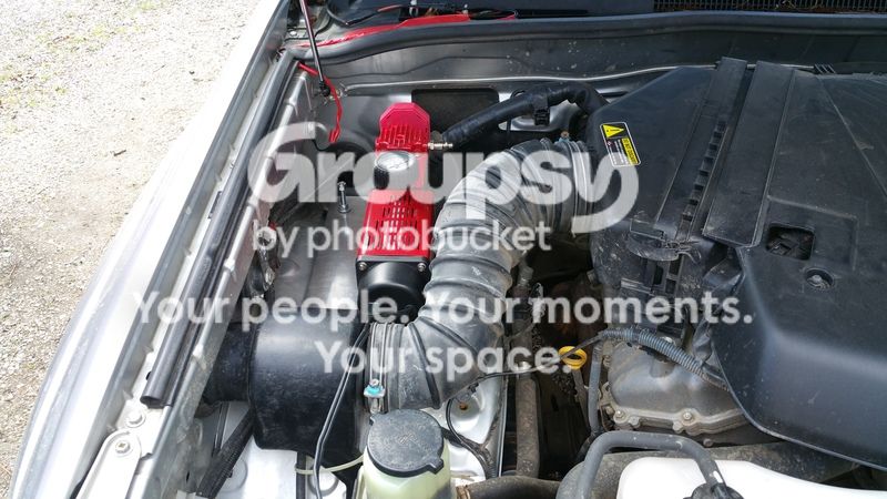

got done with my on board air today.
used 3 bolt holes and one hole in the back that just had a grommet in it.
the two unused bolt holes i used in the fender were m8 1.25 and m6 1.0 then i used the intake mount as a third threaded mount. the 4th hole i used a 5/16 18 well nut with a 6" bolt. air pump feet were replaced with grommets and i did tap the stainless steel sheet. took a few days of free time but here it is

Love the build, reminds me of doing all of mine! Have you thought about running some air lines to the front and rear bumpers for easy plug in! That would be saweet. Keep up the good work :yo:
cant run air lines because i dont have a tank yet but when i do that will be one of the things that i do
