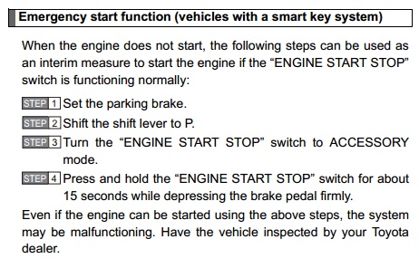

Even if the battery dies in the fob you can still manually start the car by holding the fob up to the push to start button. This will manually engage the transponder and you can start your vehicle with a dead key fob.
Here's a screen shot from the manual about exactly how to start it in case you are still stuck. Oh yeah and the battery size is CR1632, I had a lot of trouble finding it locally so I just ordered a bunch online, but I think possibly a Radio Shack might have it. I have an extra battery sitting here, so if you want to buy me a plane ticket, I'll be there in a few hours, lol. Hope you figure it out, don't let it ruin your day :)
