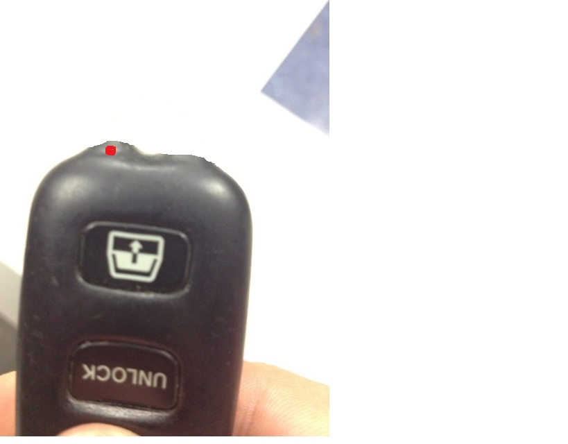

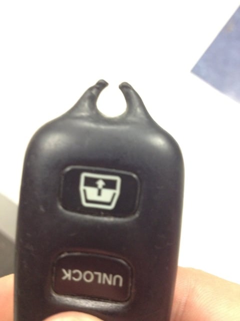

Anyone have any idea on how to fix this? In case you cant tell, the part that goes on the key ring wore out and slides right through the key ring. I'd really rather not have to buy another one. Creative minds very much welcome.

I'd get some of that two part clay that hardens when it's mixed.
As in J-B weld.
mcaz5, I've had keyfobs break like that before too. I always use J-B weld to repair them. Works great. If you've never used j-b weld before, practice on something else first before doing the fob. Good luck.
I used a very small drill bit in my dremel and drilled a hole to one side and put a small snap swivel from the tackle box in the hole and then i ground down the pieces where it is broken.
